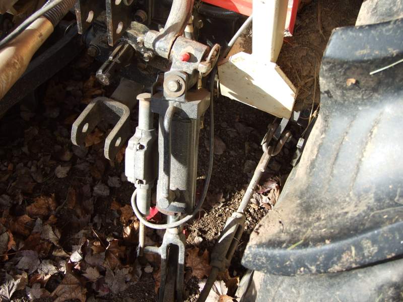

Not sure what the TnT setup is but if the $ are there and you are so inclined, the nicest thing would be to add/use a hyd cyl for the right lift link and control the tilt from your seat.
The pic is of my tractor that had this feature from the factory and is part of an auto adj/leveling system. The divise left of the hyd cyl is a position sensor. I also have an electronic sensor on my qhick mount hitch that work with the hyd cyl and with the flick of a switch I can turn on/off the auto leveling system. It does work in real time to keep implements level.
I know that Iseki (MF compact builder) and Kubota as well as other Yanmar like yours has similar attachments. Too bad all the nice Japanese options aren't available here. It is truly amazing what they have but we don't. Even the fanciest model here, are bare bones there.
