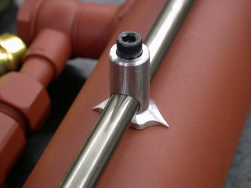

A mechanical system is the easiest and most reliable....you can change the "stiff" indicator rod to a cable rod in a casing, and let the wire end end up in the cab so you can see it.....
Using electric/electronic transducers.......you are hitting high 3 digit $$ numbers pretty quick, at no more gain.....these mechanical indicators are used all the time on heavy equipment.....remember that you are not looking for motion control, just a position setting.......

I made a top link indicator years ago.
I only used it for a little while until I got a "feel" for where to set the cylinder. Also marked my FEL indicator but same thing...after a while you get a feel for that too and you don't really need one. Pictures below are of the top link indicator and the fel marked shaft. The indicator is much like the drawings you guys posted.

Thanks for the compliments guys,
I thought I'd posted a thread about making the one for the top link, but I couldn't find it?
Anyway, those indicators are now under a bench somewhere in my barn because I really don't use them anymore. Some of the old pros here were right when I made mine, that sooner or later you will get a "feel" for when your implement (or fel bucket) is set right. Plus, with the hydraulic top link, it's sooo easy to re-adjust on the fly until you get the desired results.
