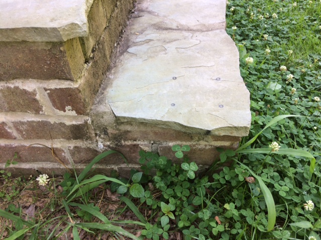

Hi guys,
I'm mounting square steel posts on the corners of my front steps for some handrails. The stair tread "cap" is bluestone, with brick underneath. I have no idea how solid the area inside the perimeter brick is. Maybe just rubble. I plan to use regular "red-head" anchors, probably 2-1/2" or 3" long. I have little experience with bluestone and don't know how crack-prone it may be.
The questions; do you think that I can drill these with regular 2-flute carbide percussion masonry bits, or do I need to get spendy and use diamond saws?
Should I plan to to pre-fill the holes with some sort of grout just before I insert the anchors?

Simpson 2 part epoxy. My fear is an expanding style anchor will split the rock.
/ Masonry drilling #3
I agree. I give the drilling method less than 50% chance of not splitting the rock.

We used diamond core drills and epoxy on commercial railings in concrete and heavy stone.
/ Masonry drilling #5
I had to revisit the picture. Didn't see any heavy stone or concrete.
Give it a try.

I would use a good quality masonry drill in a rotational mode only until you drill through the stone cap. Hopefully you will fins a solid substrate and then continue drilling to the desired depth using the hammer mode.
To insure against breaking the stone with a ‘Hilti’ style anchor i’de opt for setting studs.
in two part epoxy.
From your posted picture, it appears the bluestone is ptobably not all that hard
Good luck
B. John

Thanks for pointing that out, I guess I didn't explain my train of thought at all.. A core drill doesn't have any shock or vibration to split the stone, or break the mortar bond between the stone/brick, brick/brick, nor does it care if you are drilling on an edge of brick. It won't slip off the edge.

I kinda think removing the bottom step and replacing with bluestone topped new concrete might be a more permanent solution.

OK, so y'all have me leaning toward diamond core bits. This is outdoors, so keeping it wet is not a problem.
And I'll go along with epoxy set. Is this available at Lowes? Is there any need to use an actual anchor bolt, or just pieces of all-thread?

What we used was Tigergrout.
Epoxy Anchoring Grout - TIGERGROUT™ HD - Garon Products Inc.
I don't think it is available at Lowes, but you might get a small bit from an ornamental railing company cheap.. We simply made the rails long and placed the ends in the holes in the concrete and poured the grout in. The stuff was super strong. I did some locally 20 years ago, and they're still like new, even with our winters. puddle the grout higher than the surface so the water doesn't pond and rust the post.
Run the core drill very slowly, and use lots of water so it doesn't get hot.

Lowes has it in the section with all the metal framing products plus elsewhere . Several brands. The make anchors specifically for epoxy setting. Depending on loading and/or location you could use all thread or rebar but it rusts outdoors; the anchors are plated, galv, or SS. Lowes has it all.
