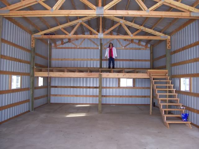

I had a local contractor do my 24x48 PB with a loft and concrete floor.
The concrete is insulated under the loft, which I've since enclosed as a office/man cave.

I paid $19,86 sq ft for my PB, including the loft and stairs...no taxes and cheaper labor in Oregon.
Posts set on a poured pad, 48" down.
