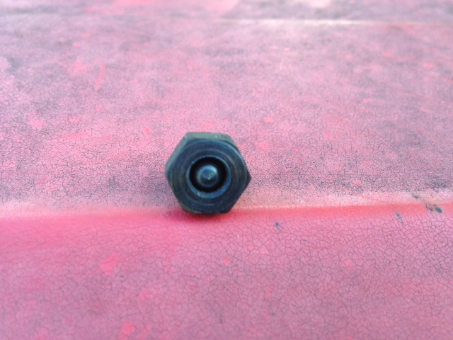

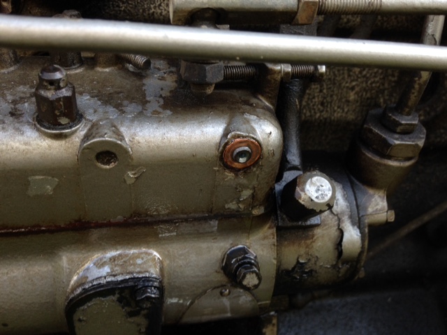

Let's resurrect this one. Thought I had fixed problem by tightening throttle linkage several years ago but it happened as described above again yesterday. Threw it into neutral and used fuel shutoff to kill engine. WHen I tried to restart it acted like air in system from overrun. So i went to bleed fuel system and broke off upper bleeder screw. Now diesel fuel leaking from broken upper bleeder screw location. What do i need to do to fix broken screw?

If you are talking about the small bleed screw with the pointed end (5/16 a/f)wrench remove the ""seat"" ,the part that it screws into and fit a short setscrew with the correct thread,5/16"UNF x MAXIMUM 1 INCH LONG .
Bleed the pump that is pump the primer on the right hand side untill ALL the air has been removed ,best to pump for 30 seconds after the fuel starts to come out of the bleed hole just to make sure all the air is out ,fit the temporary setscrew while pumping so that air does not get in to the pump and GENTLY tighten, make sure the copper sealing washer is fitted under the head of the setscrew ,undo ANY injector pipe ,pick one that is easy to get to ,undo say a half turn then crank the engine with the hand throttle set at say 1/4 open engine stop knob in and when the engine starts tighten the injector pipe up ,Note": fuel at high pressure can penetrate the skin ,either shut the engine of and tighten the pipe or be carefull when tightening it up when running, not you, The Engine .
Any Diesel fuel injection repair shop will be able to supply you with the complete bleed valve and seat.
Happy days.
Hutch.

As previously stated: Renew fuel filters and monitor progress regarding unexplained increases in engine speed. You may not need to do any further work.
Regarding the broken bleeder screw: Did it break while you were trying to loosen it, or whilst retightening it? They only require a very light tightening. As Shona said ... any diesel shop (or ask PumpGuy nicely) and renew the complete bleeder.

I will post photo of broken piece and location in a few hours. thanks for all the help so far

Broke off while I was re-tightening.......:(
