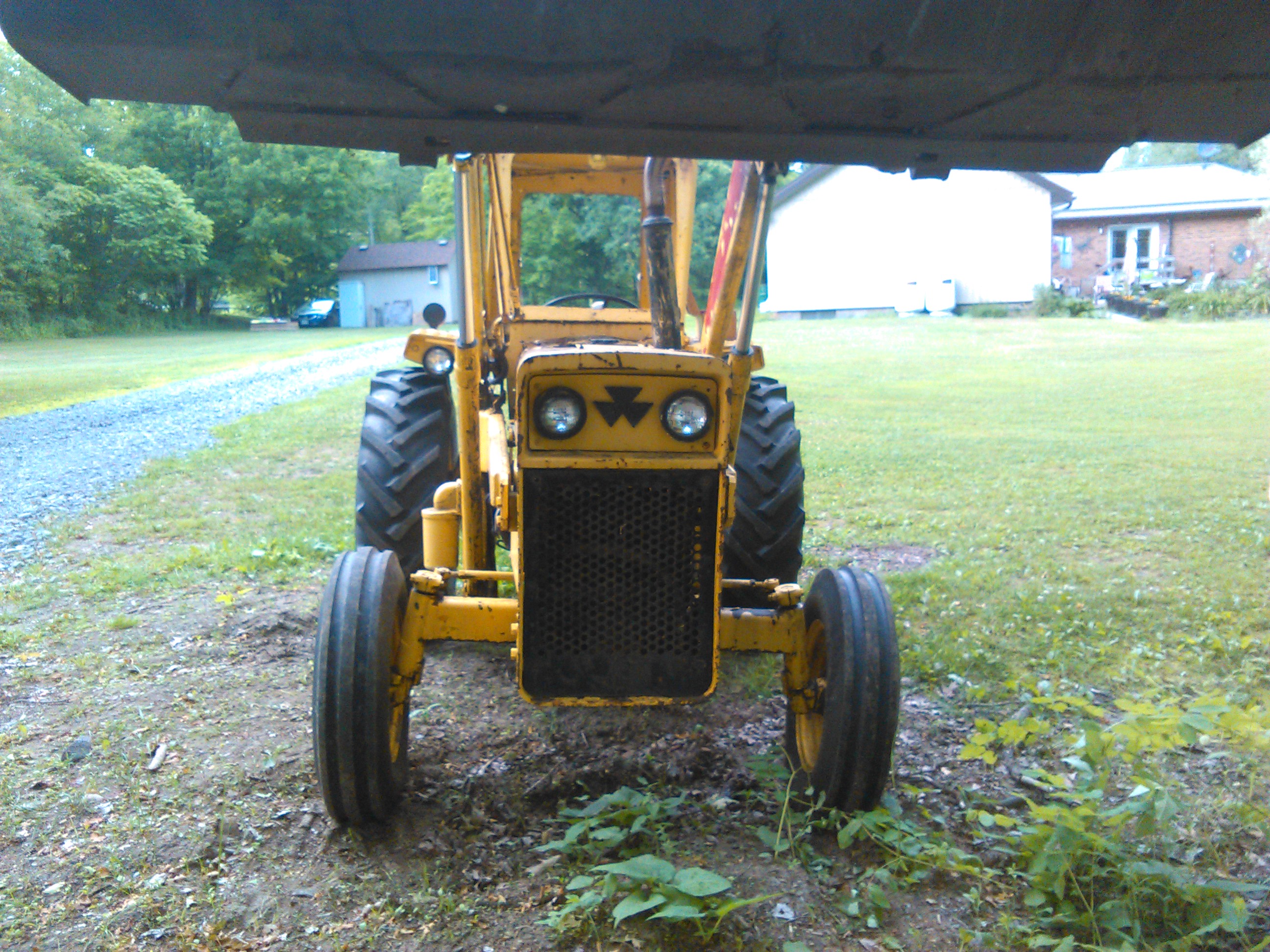

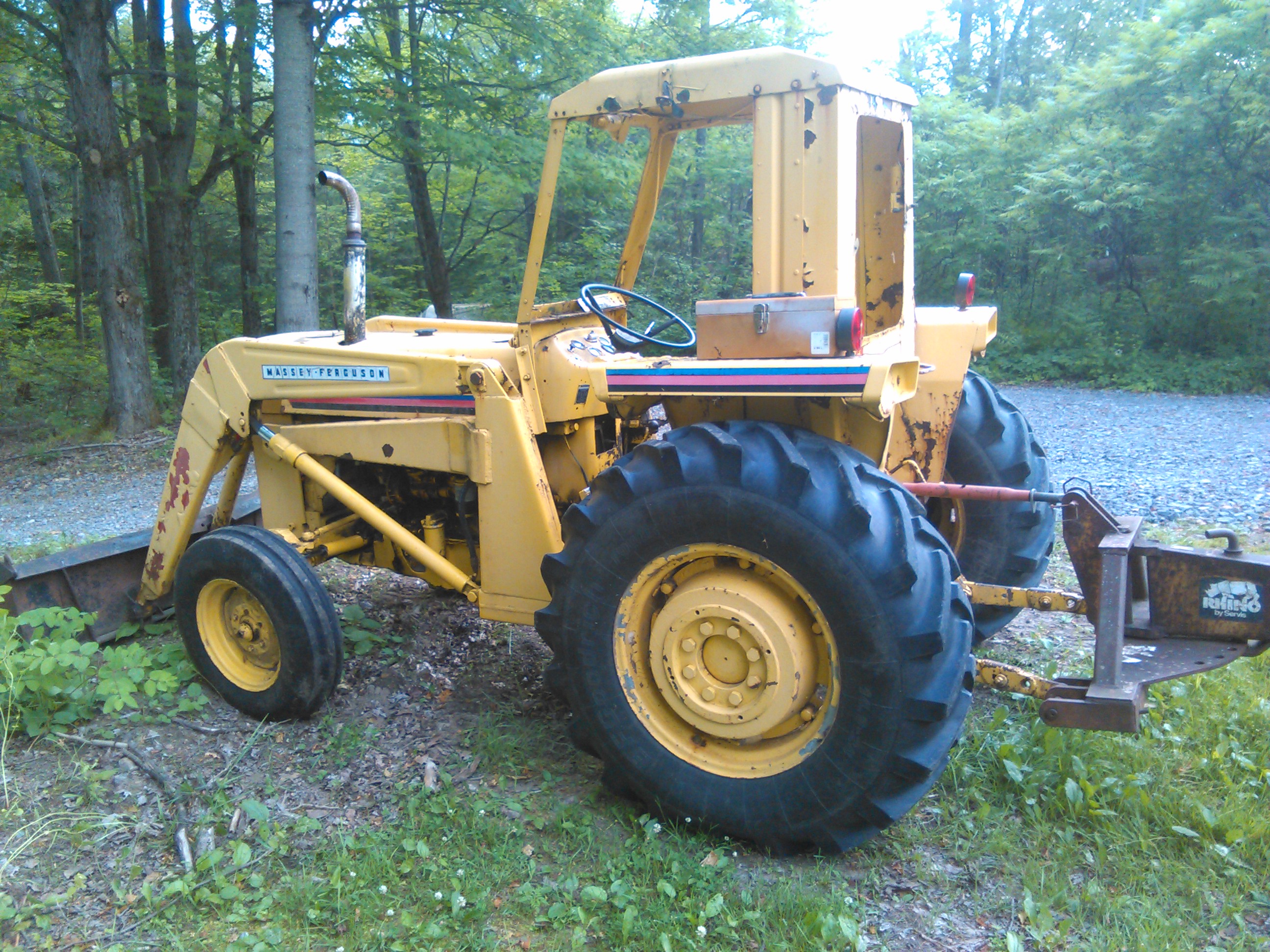

Cordova you need to post more photos and more information on the tractor so we can ID the model. The extremely close up photos make it a challenge to see what you have. Some nice wide angle shots from all sides would be a much better start. Transmission information, engine, brake type, pto type, etc would also help. The loader data plate would also help. We cannot help you with out your assistance.

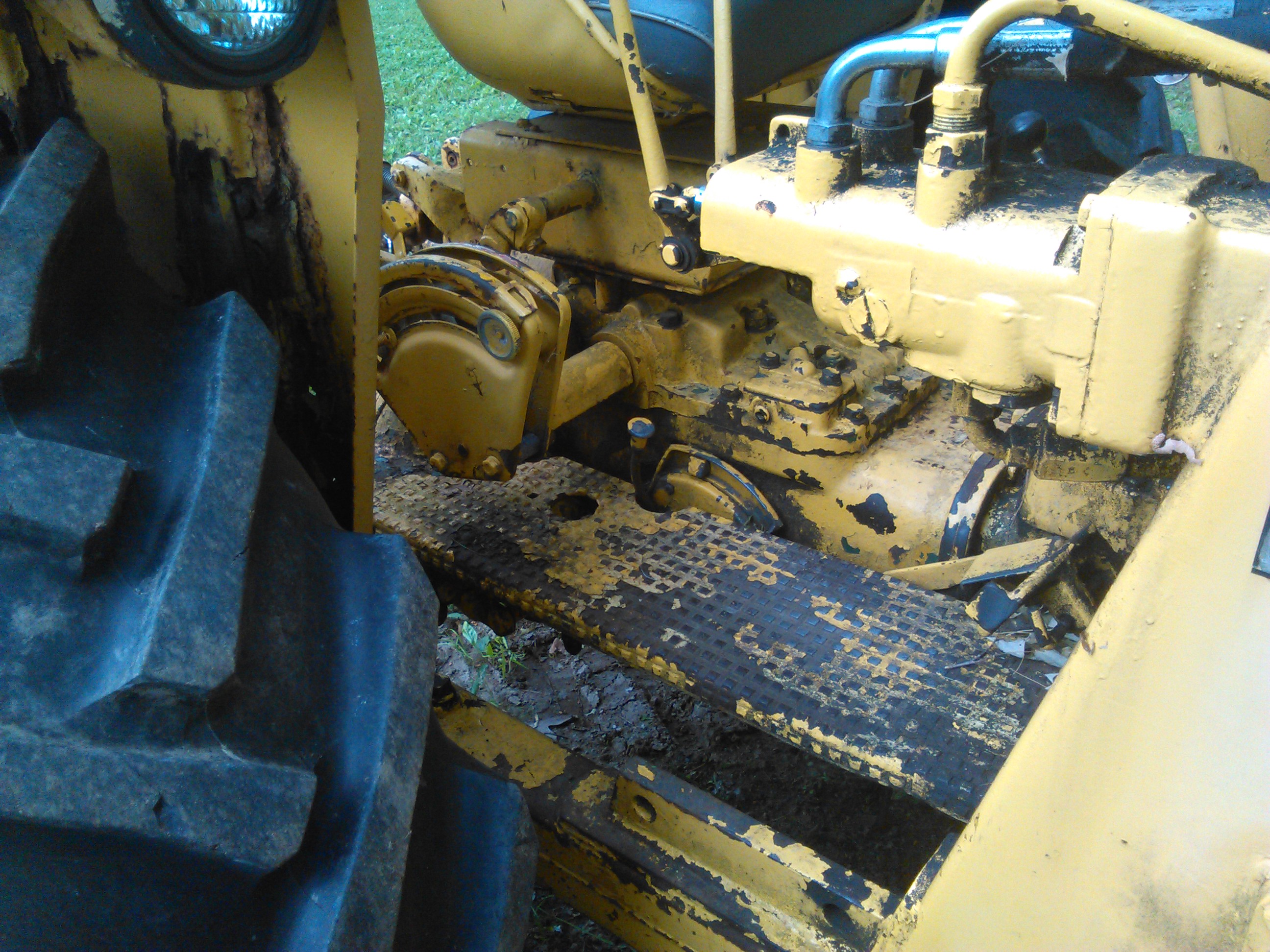

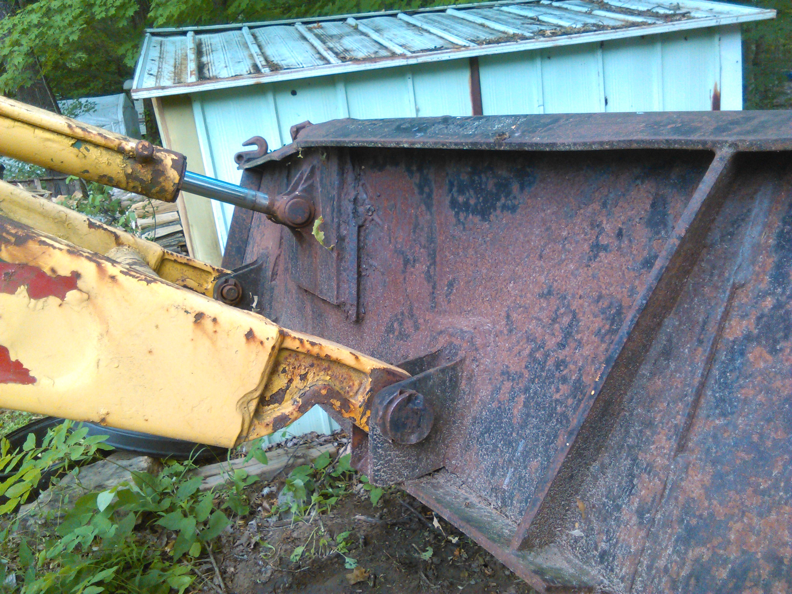

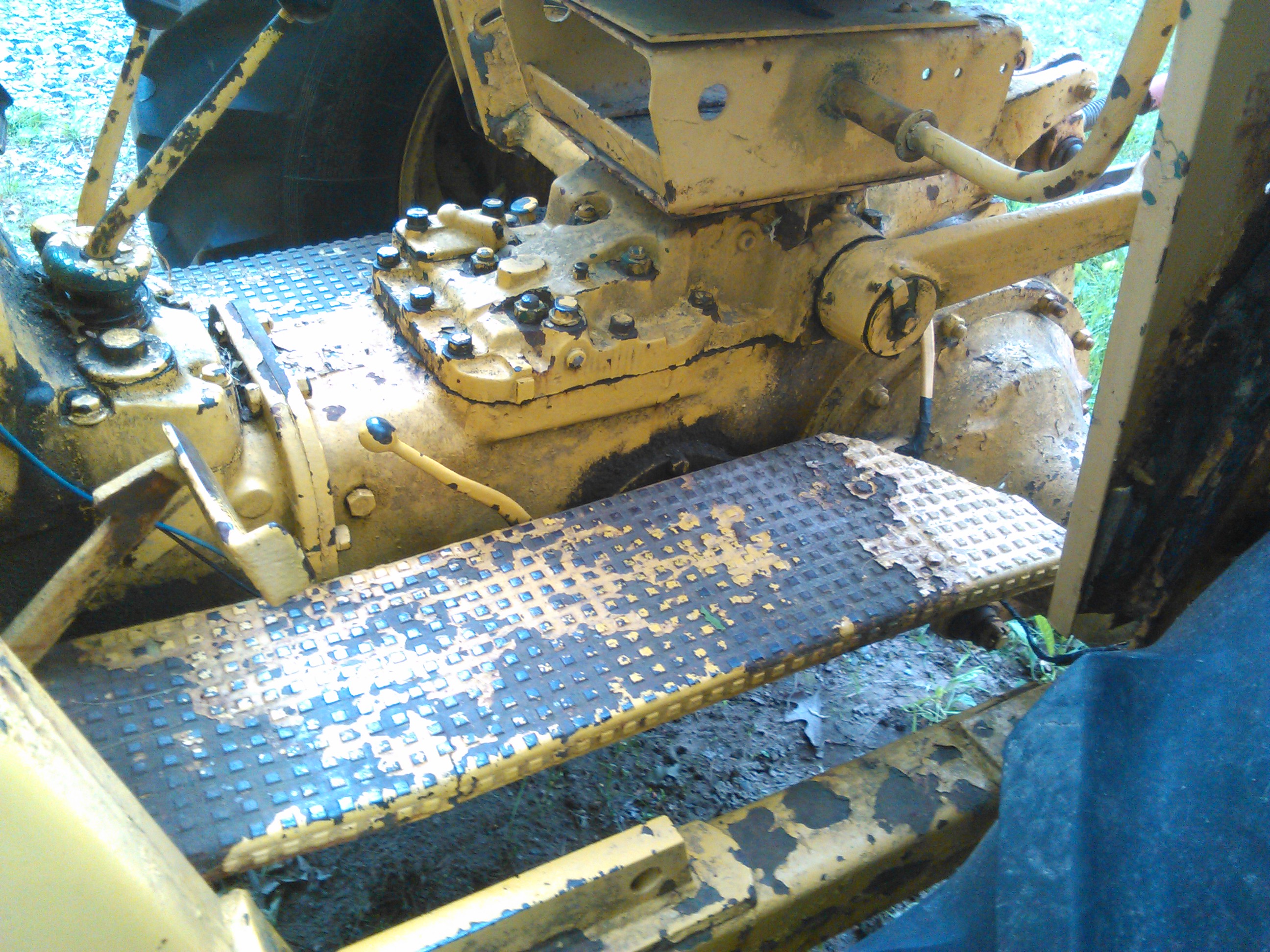

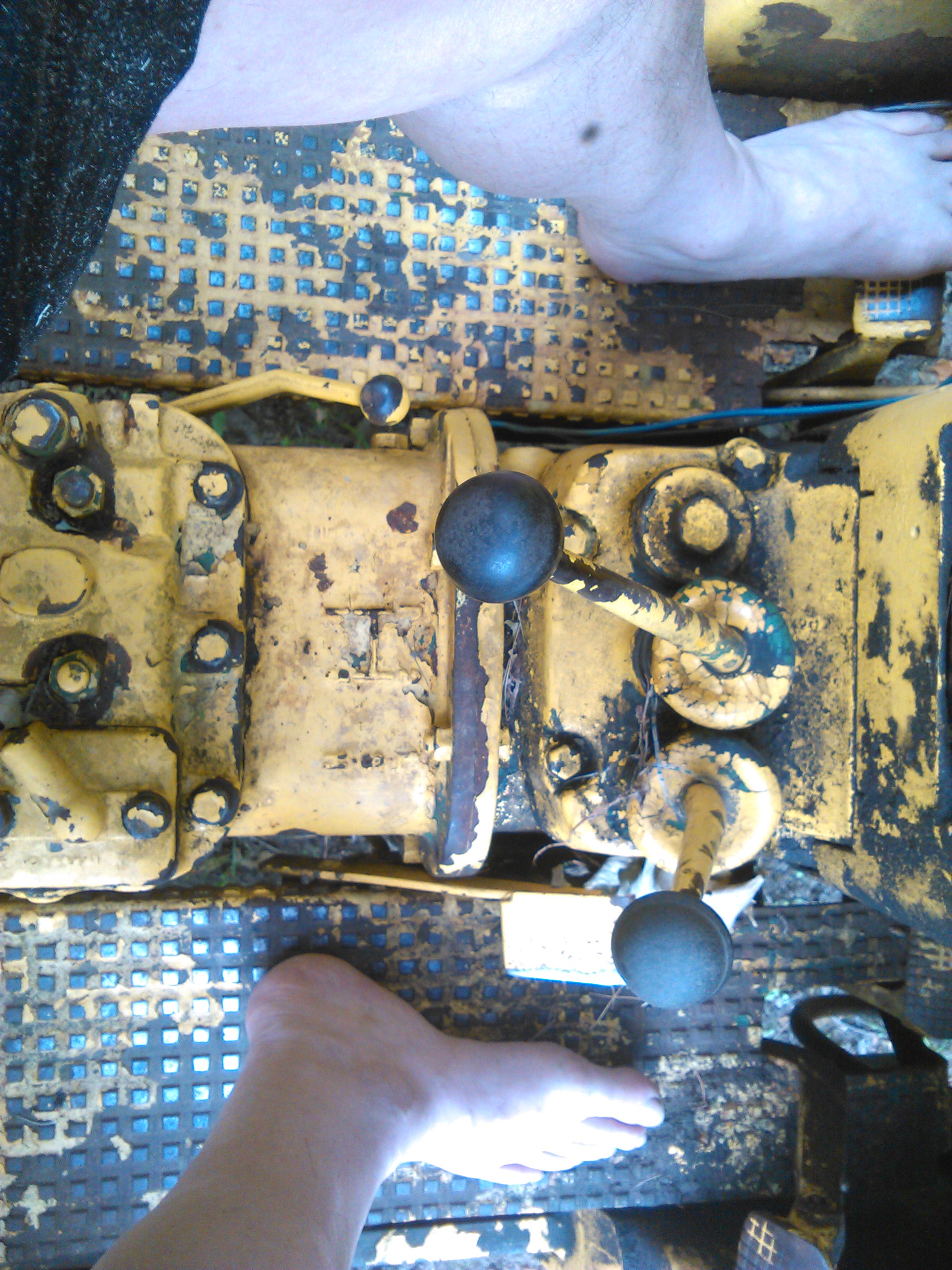

Engine is a worn out 3 cylinder Perkins that starts on the flip of a coin, even in the Canadian winter. Just lacks some power but I can live with that. Tranny is 6 forward, 2 reverse. The loader was painter red originally and it is an agriculture loader for sure. It has its own engine mounted hydraulic pump. Rear tires are 24" which led me to believe it was a low profile or Orchard model. I rebuilt the hydraulic pump in the rear end a couple years ago but have to re-visit it again as the draft isn't set up properly. I watched a good video from this Rachel girl who seems to be a Massey guru. [my dad and brother took it apart and were messing with the spring tensions on the arms.] It also has a response lever directly across from the pto engage lever IMG_20200630_191313.jpgIMG_20200630_191252.jpgIMG_20200630_191122.jpgIMG_20200630_191008.jpgIMG_20200630_190837.jpg

Looks just like a 2200. 14.9x24 is a very common industrial tire. The tractor has 3 hydraulic pumps. Front mounted for the loader, engine mounted for the steering, and transmission unit for the rear hitch. The loader is very light duty compared to the unit normally mounted on this tractor. The tractor would have been yellow from the factory, however the loader was probably red and mounted on an ag tractor.
The stiff steering could be a worn pump. Does it steer better when the engine is at a high RPM?
