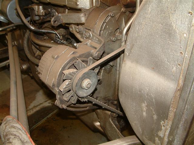

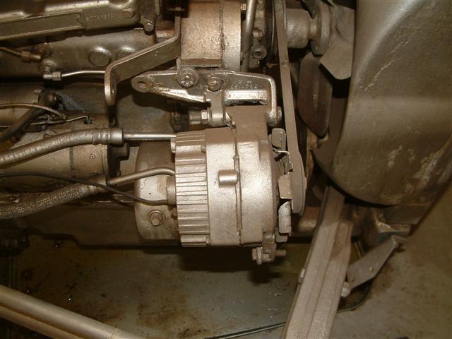

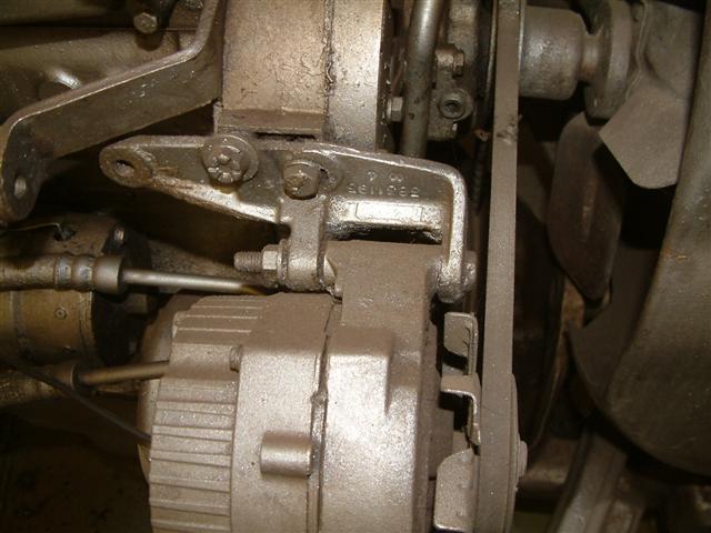

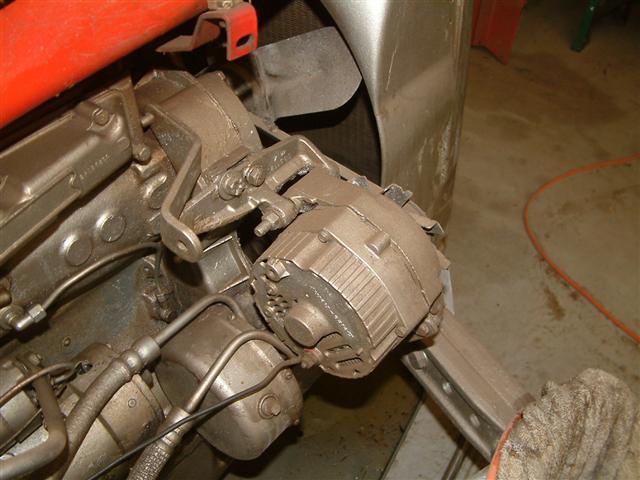

My 1964 MF-135 diesel originally had a generator. A previous owner replaced it with a Delco Remy 12-3 single wire alternator. Here are a few photos of that setup.
The top bracket has the number 3831195. It looks like an MF number, but I can't locate it in my MF135 parts manual.
Good luck.
