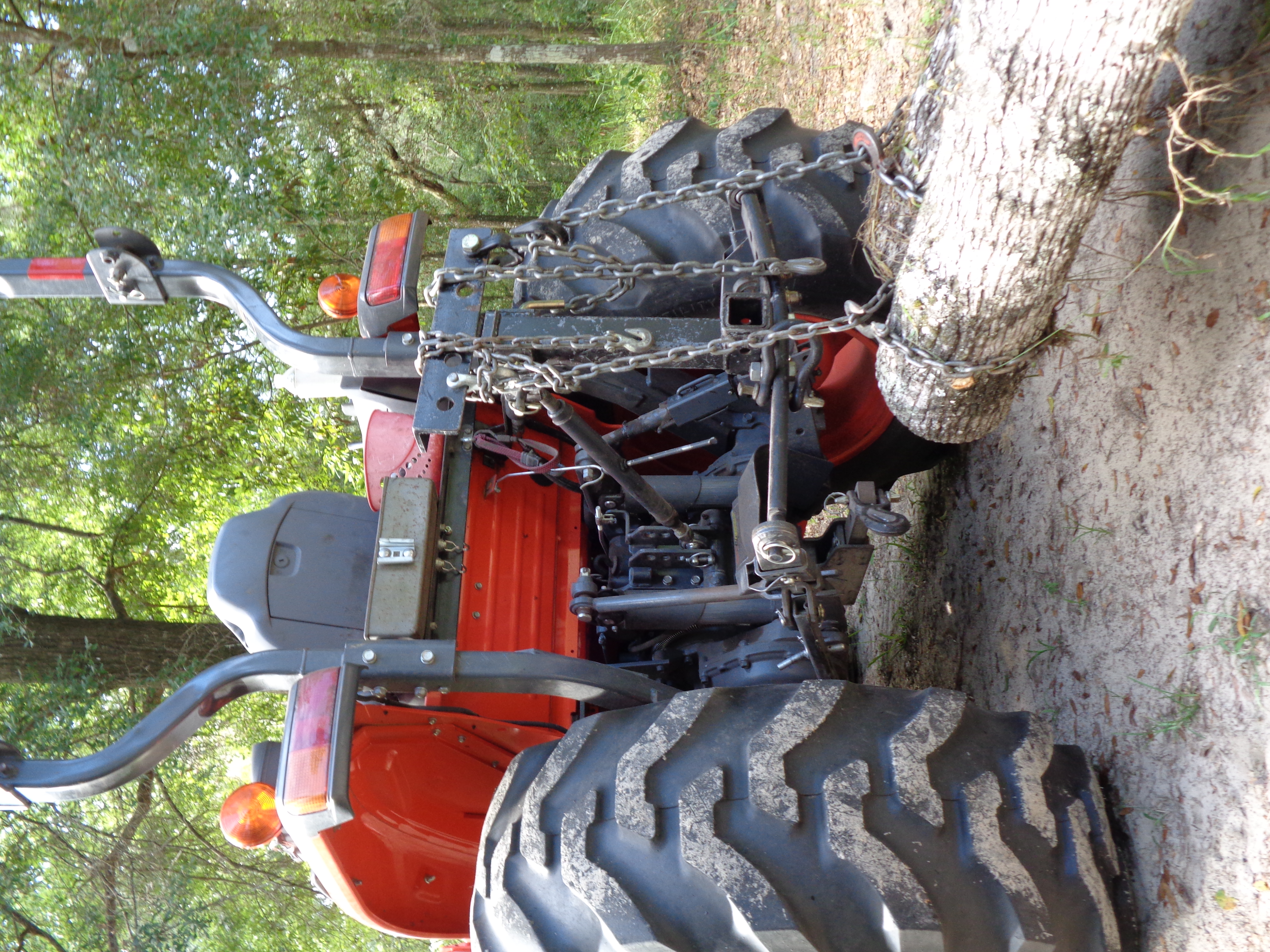

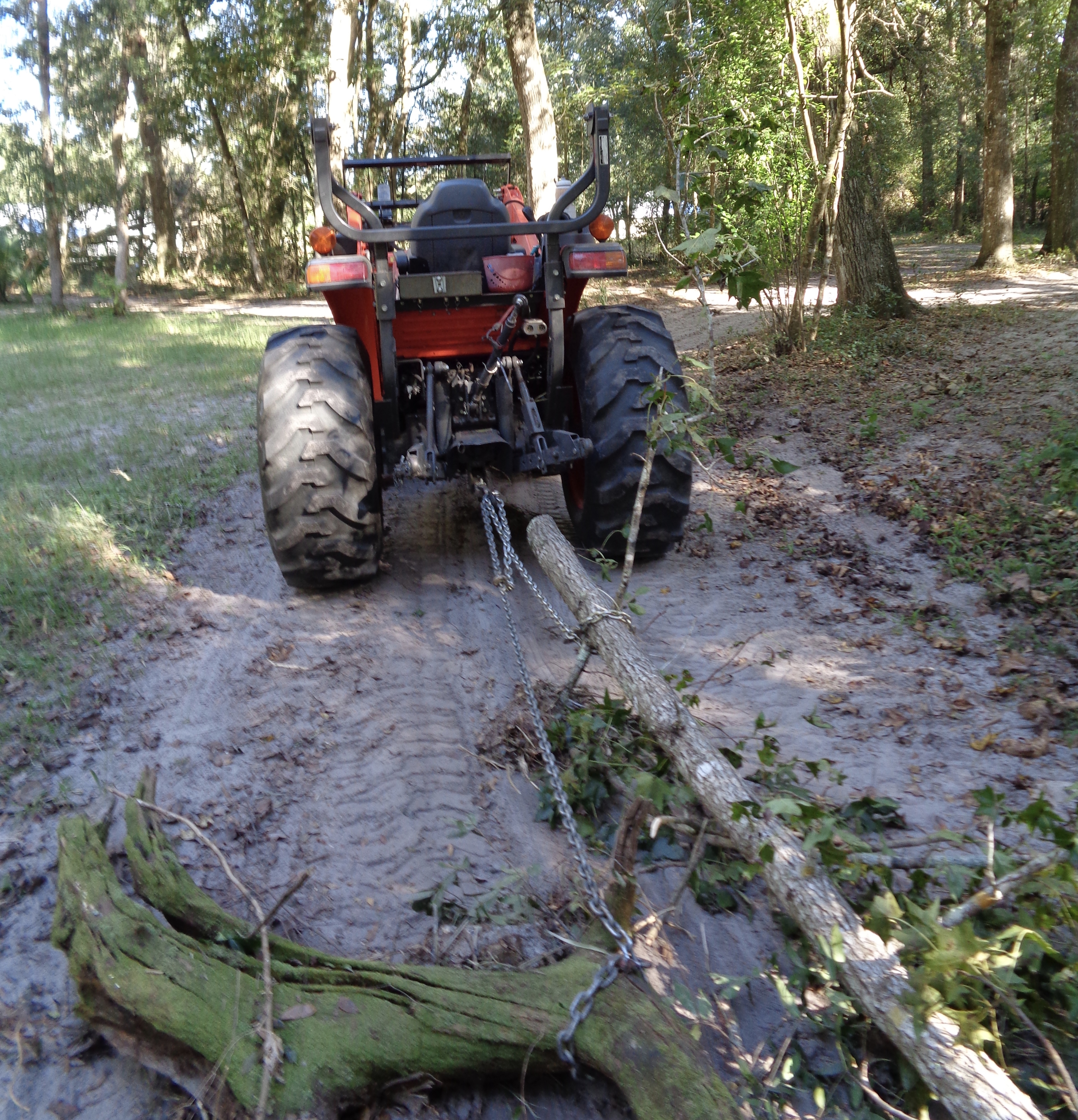

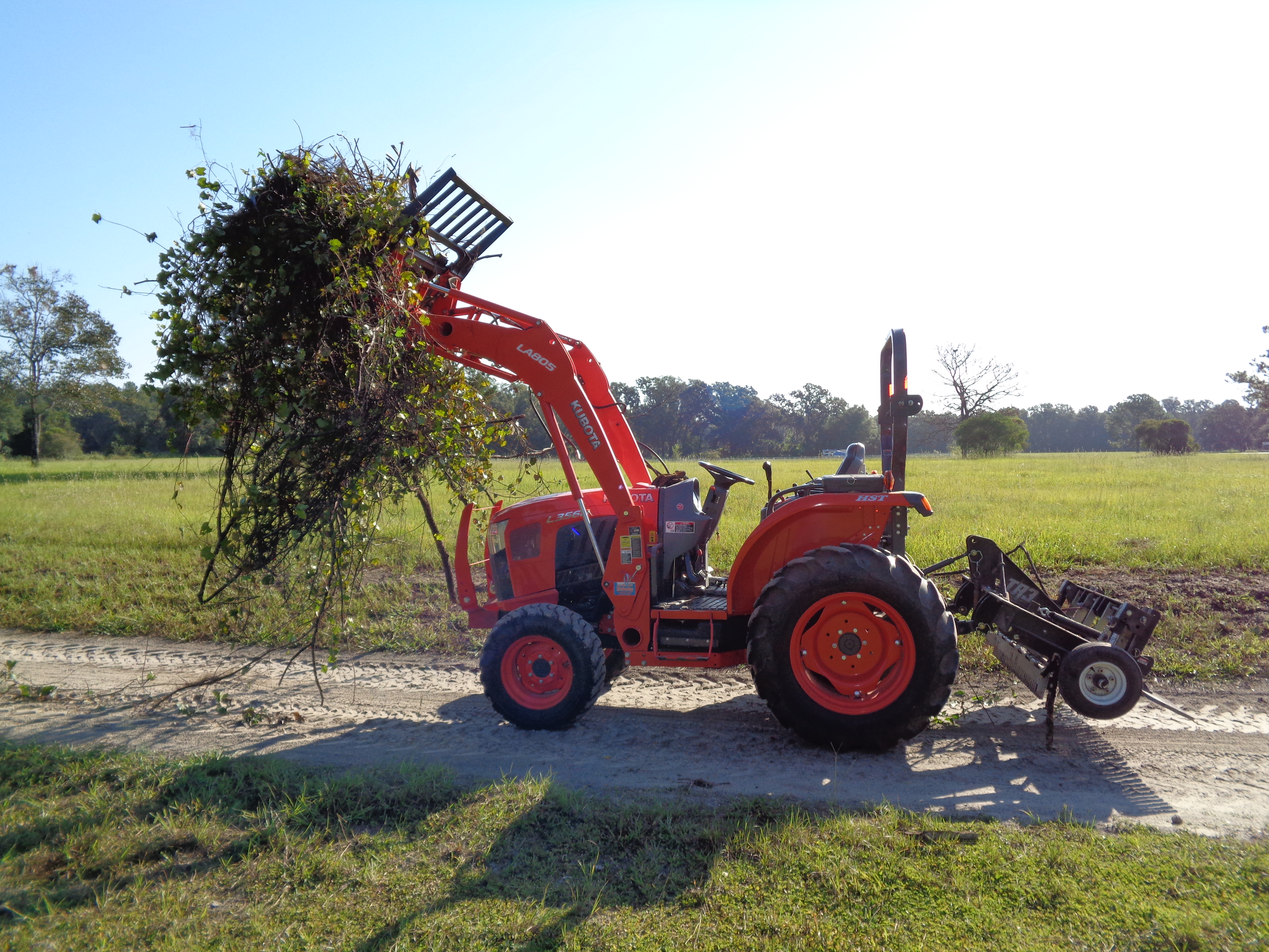

From my experience a tractor with a bare weight of 4,000 pounds and 66" to 70" width is ample and safe for your expressed needs on ten acres. (My tractor is 3,700 pounds, bare tractor weight.)
It is simple to install fixed spacers under most tractor seats, which raise seats 3" to 6".
Most tractors of 4,000 pounds bare weight will have a FEL lift capacity of 2,000 to 2,600 pounds.
Some would fit in your garage.
When considering a tractor purchase, bare tractor weight first, tractor horsepower second and (narrowly) rear wheel ballast third.
Consider a PTO-powered Skidding Winch to safely accomplish some of your applications from the tractor positioned on flat ground.
