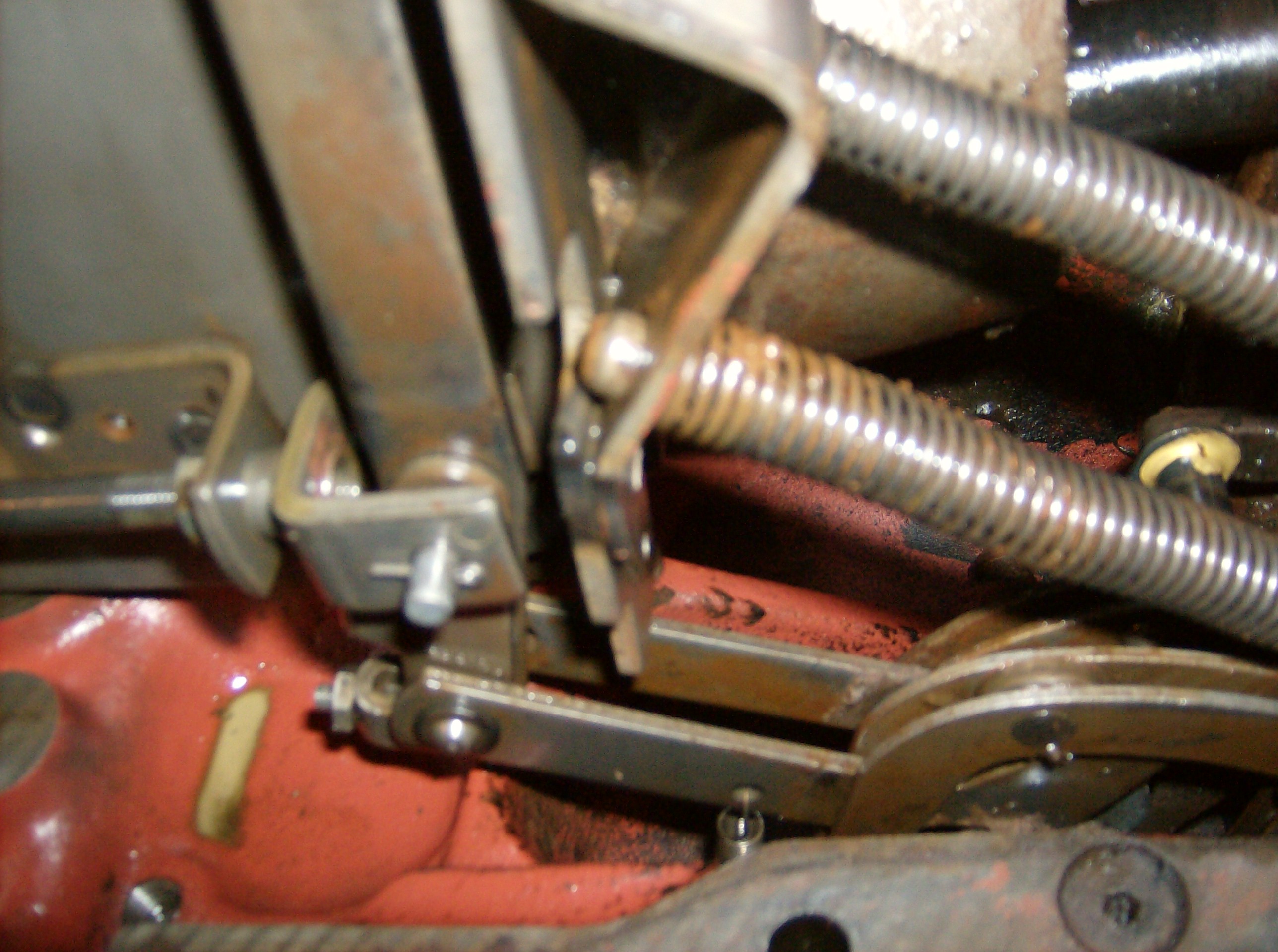

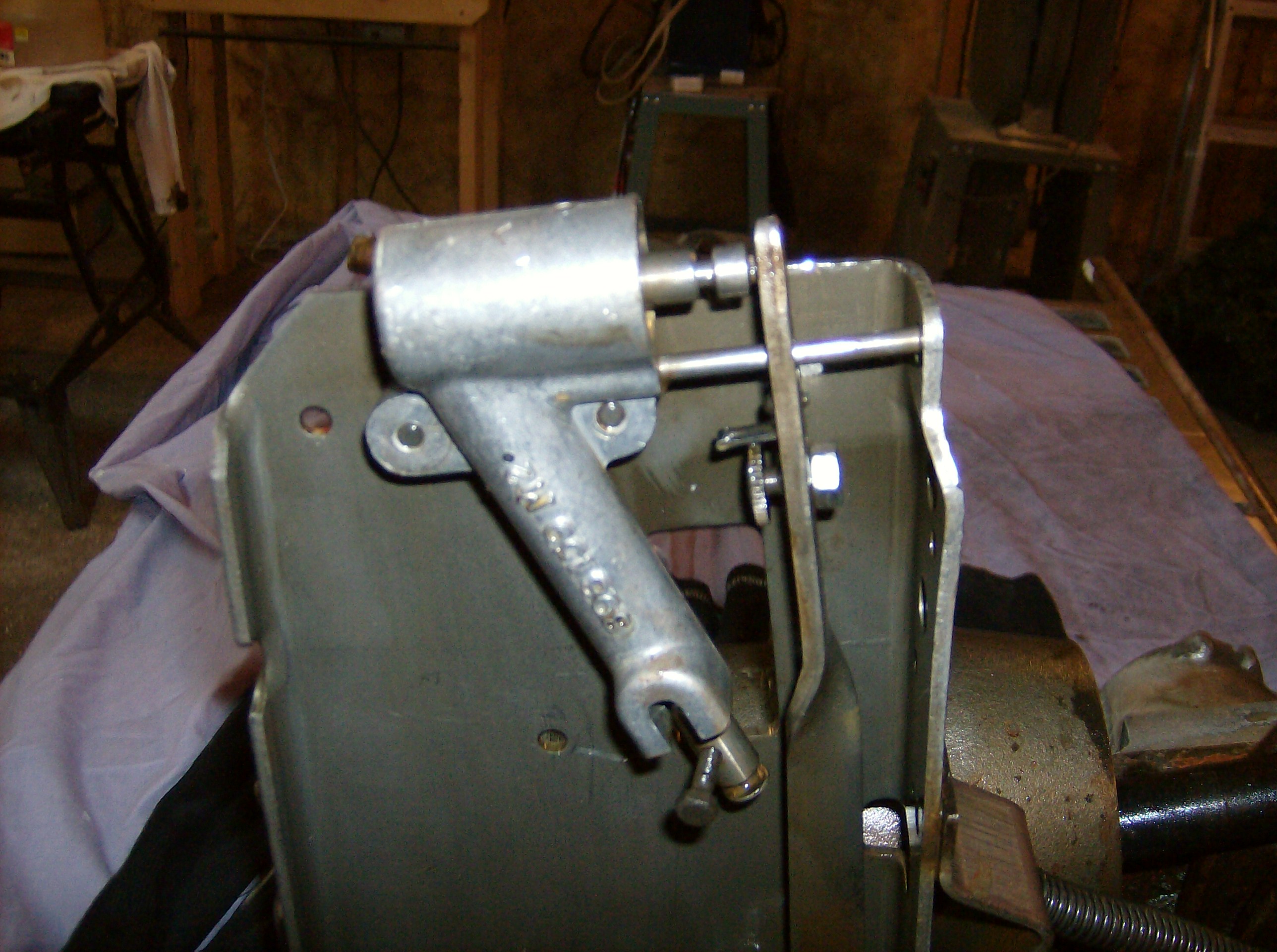

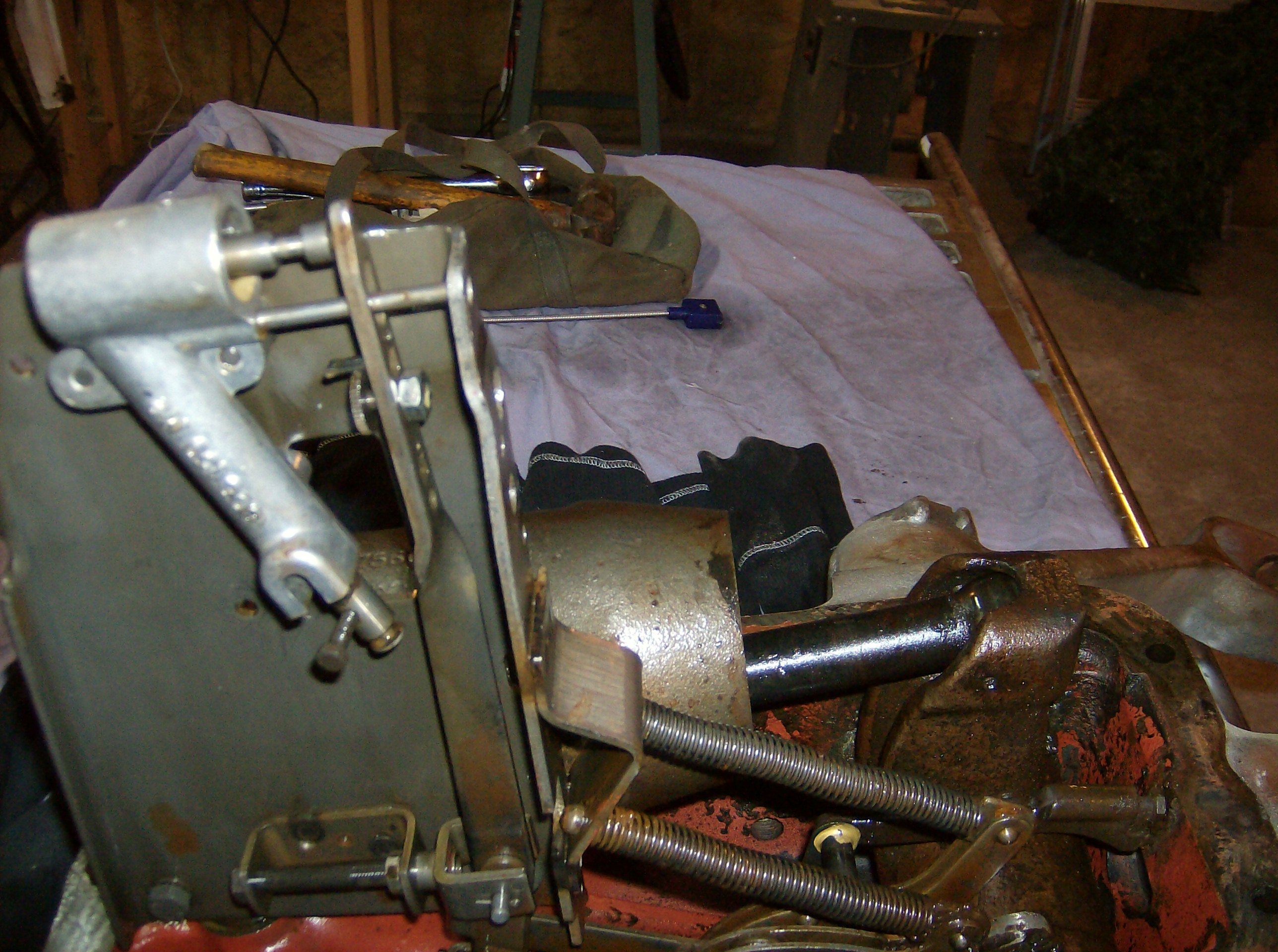

I had to make similar adjustments to the stop on mine. This adjustment was made after I had checked the lift piston and pod (had been contaminatd with sludge from the oil) and reinstalled the cover. The hyd fluid had been contaminated, not only with water from cracked boot shift levers but from my over-greasing the three point lift arms. It wasn't lifting / travelling to what the manual said were were its limits.
The hardest part of the job was removing the top cover, not because its particularly complicated but because it weighs a ton and most of its weight was aft. If I were to do it again I would be looking at using a hyd lift or block & tackle.

I would say that you now know how heavy the lift cover is and I hope other members and readers take note the risk of serious personal injury plus the damage that can be done to the tractor does not bear thinking about, I am only to glad you survived and hope as you say the next time use an engine hoist or chain block I hope you got it fixed o.k after all your efforts ,if not just ask in the site .
Incidentally the hydraulic lift cover in the photograph is of a mark two pump different to the mark three in the 231.
