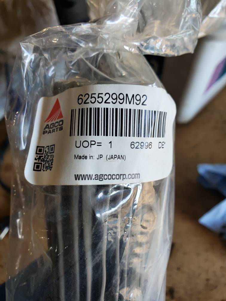

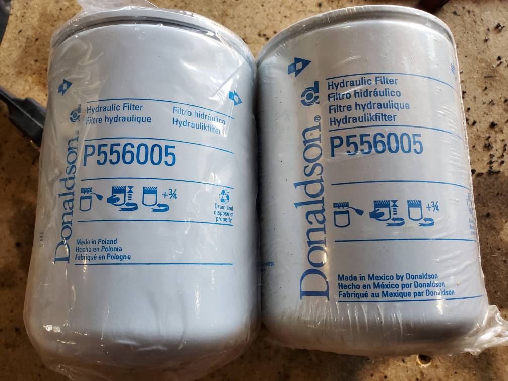

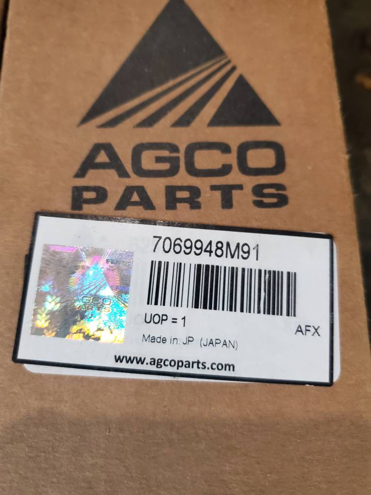

Just an update...
The original part number for the metal-mesh suction filter is 7069948M91 but I believe that number was replaced by 6255299M92. Those are Agco numbers. They are around $130/ea (2 required).
Here's pics of the SKU #.
Also, here's something interesting. I usually use Donaldson filters for my HST filter. I was grabbing one today (I have 2 in stock) and noticed that one of them was made in Poland, the other in Mexico. Makes me wonder who Donaldson contracts to make their filters, and if they're the same between Poland & Mexico... ? May be silly to say, but I feel like the Poland filter is of better quality, subtly. 20190412_174639.jpeg20190413_180842.jpeg20190413_180938.jpeg

Just an update...
Also, here's something interesting. I usually use Donaldson filters for my HST filter. I was grabbing one today (I have 2 in stock) and noticed that one of them was made in Poland, the other in Mexico. Makes me wonder who Donaldson contracts to make their filters, and if they're the same between Poland & Mexico... ? May be silly to say, but I feel like the Poland filter is of better quality, subtly.View attachment 600383View attachment 600384View attachment 600385
I worked for Donaldson for almost 12 years and more than likely those were both built in Donaldson Plants. They have multiple facilities in Poland as well as Mexico. I do not work for Donaldson any longer, but I can honestly say that they do build top quality filters they would never compromise quality for cost and put their name on it.
