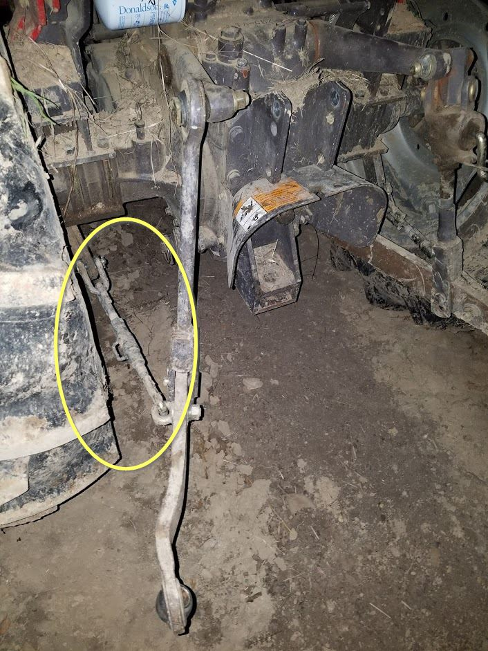

I managed to bend the threaded portion of my stabilizer/check chain. Is there an aftermarket one out there that would easily replace the stock one?
It's the part circled in yellow in the picture:
   / Massey Ferguson 1250 - bent stabilizer link/check chain stabilizer #2
Yep, Tractor Supply sells them. You need to measure and make sure the range of adjustment is compatible for your 1250. Eyeball says yes. I had the same issue with a Kubota and the TSC unit was not a compatible length.
Also I have had some success straightening those threaded rods. Clamp between two scraps of 2x4 to preserve the threads and use a vise. Use nuts in the bent rod where you can get them on. Take advantage of the threaded turnbuckle too. Find a 4ft piece of pipe that will just clear and go over the rod assembly for bending leverage. Just keep fiddling with it until you find a way to unbend it. I advise against heat.

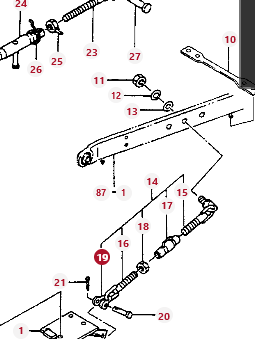

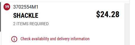

agco parts lookup
couple models (serial # split it looks like) so maybe able to find part number. if I am right its part # 3702554M1 listed under (oddly) trailer hitch linkage section item # 19
Is 19 just the shackle, or the whole assembly? Item 15 or 16 would be the part that's bent, I can't remember at the moment which threaded end is bent, but it's definitely either 15 or 16.
   / Massey Ferguson 1250 - bent stabilizer link/check chain stabilizer #6
19 was just the end threaded shackle think the other 2 pieces were about same price IF I looked up right model number.
The diagram looks correct. I may have to go to my local AGCO dealer I guess and see if they have it, which is unhandy, but such is life. Drives me nuts I can't just order online from somewhere.
I did find this part for about $50, it says it's for 24"-27" of length, I'm currently using about 14" of length +/-2", I'm thinking maybe I could cut off 3 or 4 links of the chain to get the correct length to make it work:
