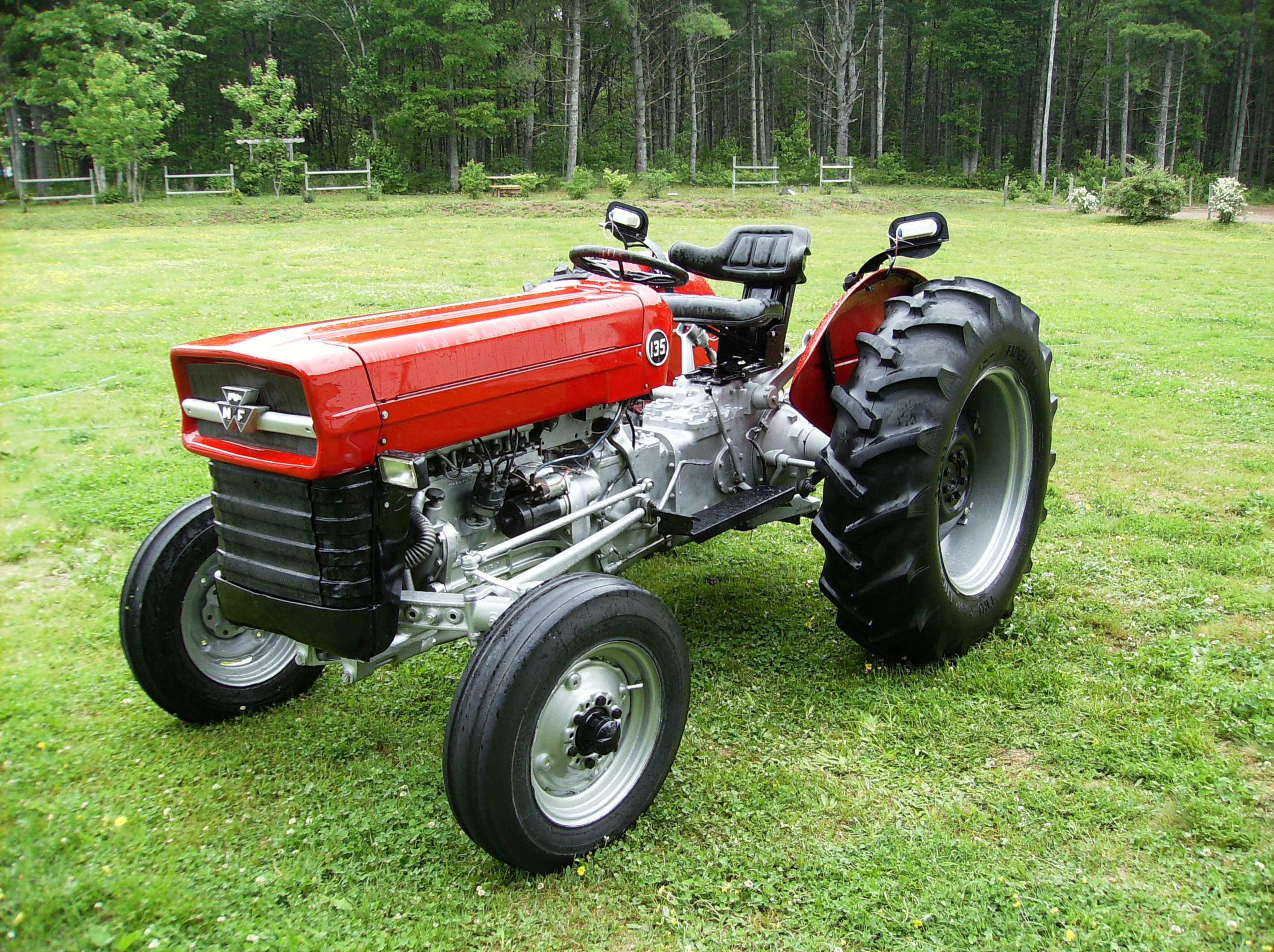

I have a 1964 MF135 diesel deluxe with multipower. Bought it in Jul06 for $3600 with 4600 hours showing. It was in pretty rough shape, but running OK. It's a field tractor that's been modified with smaller 16" dia rear rims and shorter front axle spindles to make the tractor squat low for work in the previous owner's olive orchard.
I repainted and serviced the tractor

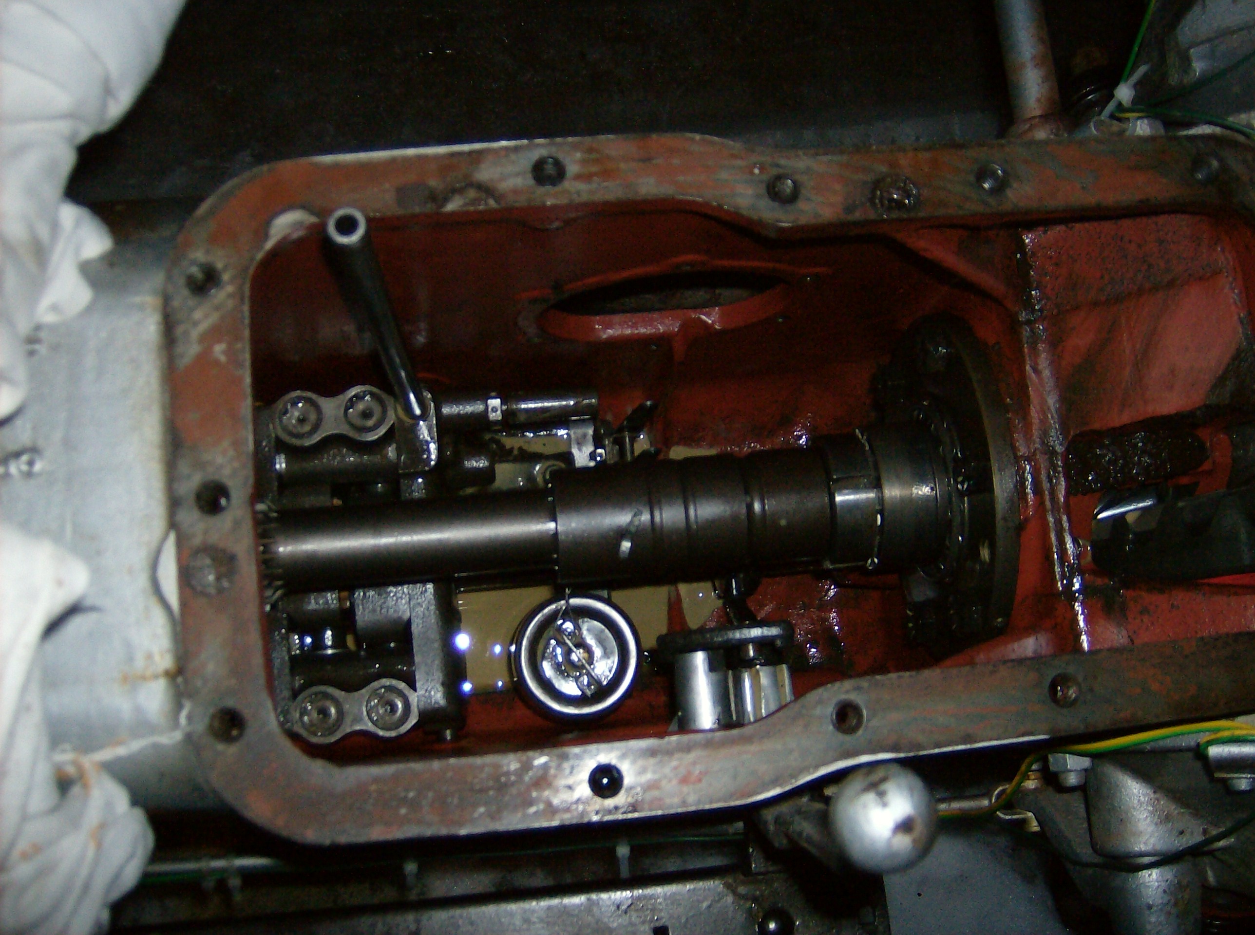

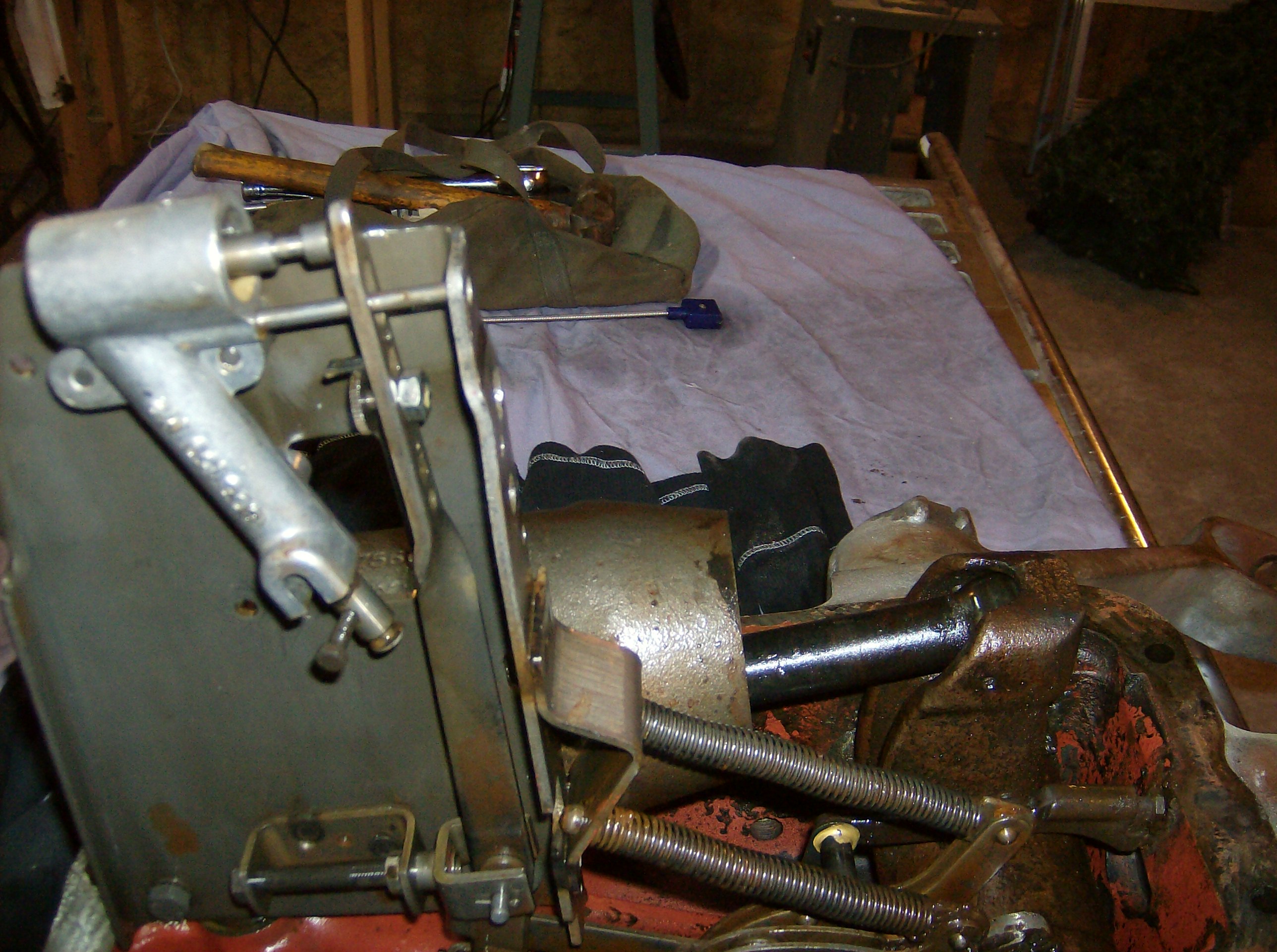

It's in my shop now with oil leaks around the engine and the rear pto shaft seal. Also the 2-stage clutch probably needs to be replaced, which means splitting the tractor.
The 135 gasser is also a good choice. You can work on that engine yourself. The injection pump on the diesel has to go to the shop if and when it needs repair.
Check out the clutch, the tranny gears, the 2-stage clutch, the 3pt hitch and the pto for proper operation when you're eyeballing a potential purchase. Don't be surprised if the steering feels stiff. The 135 is a heavy tractor with "power assisted" steering (not true power steering) and many of these old 135s have steering problems. My 135 steering is getting very stiff and will need to be serviced/repaired soon.
There are two weep holes on the bottom of the clutch housing that sometimes have the original cotter pins (loose fitting) still installed. Use a piece of small diameter wire or a small twist drill to ream the dirt out of these holes and check for oil leakage. A few drops is normal. Significantly larger leakage could mean the rear engine seal needs to be replaced.
