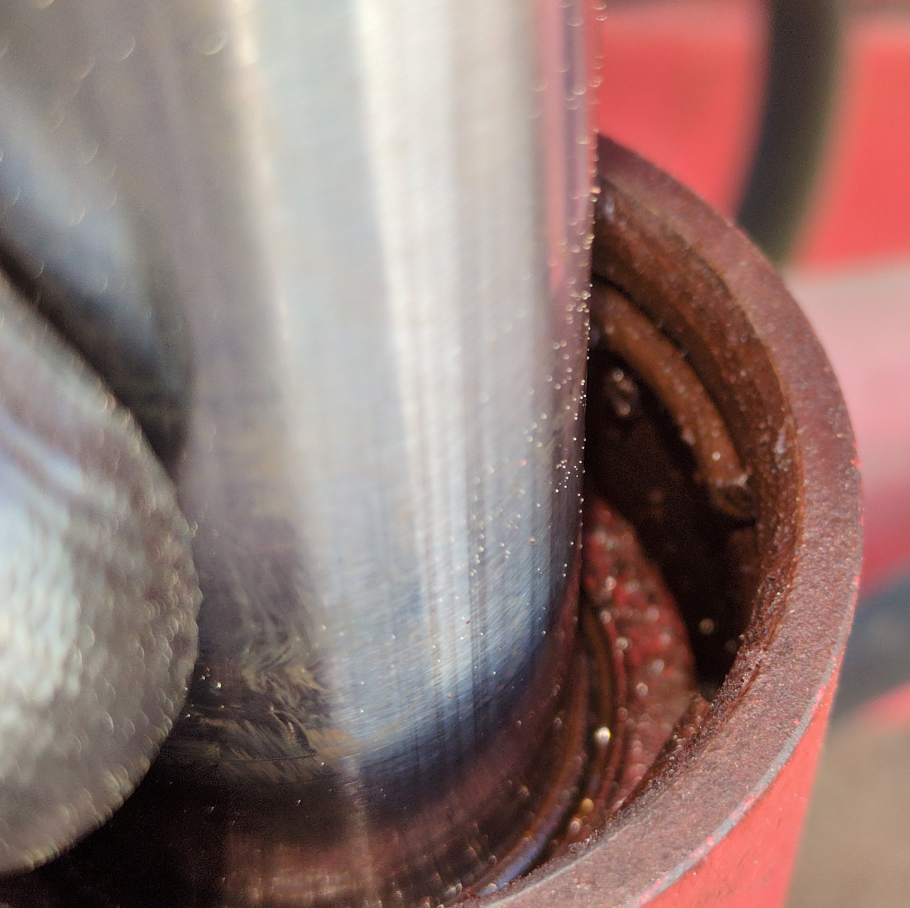

My (age-unknown, has >600 hours) MF1525 FEL curl cylinders had an internal leak so that any significant load on the bucket would tilt it down.

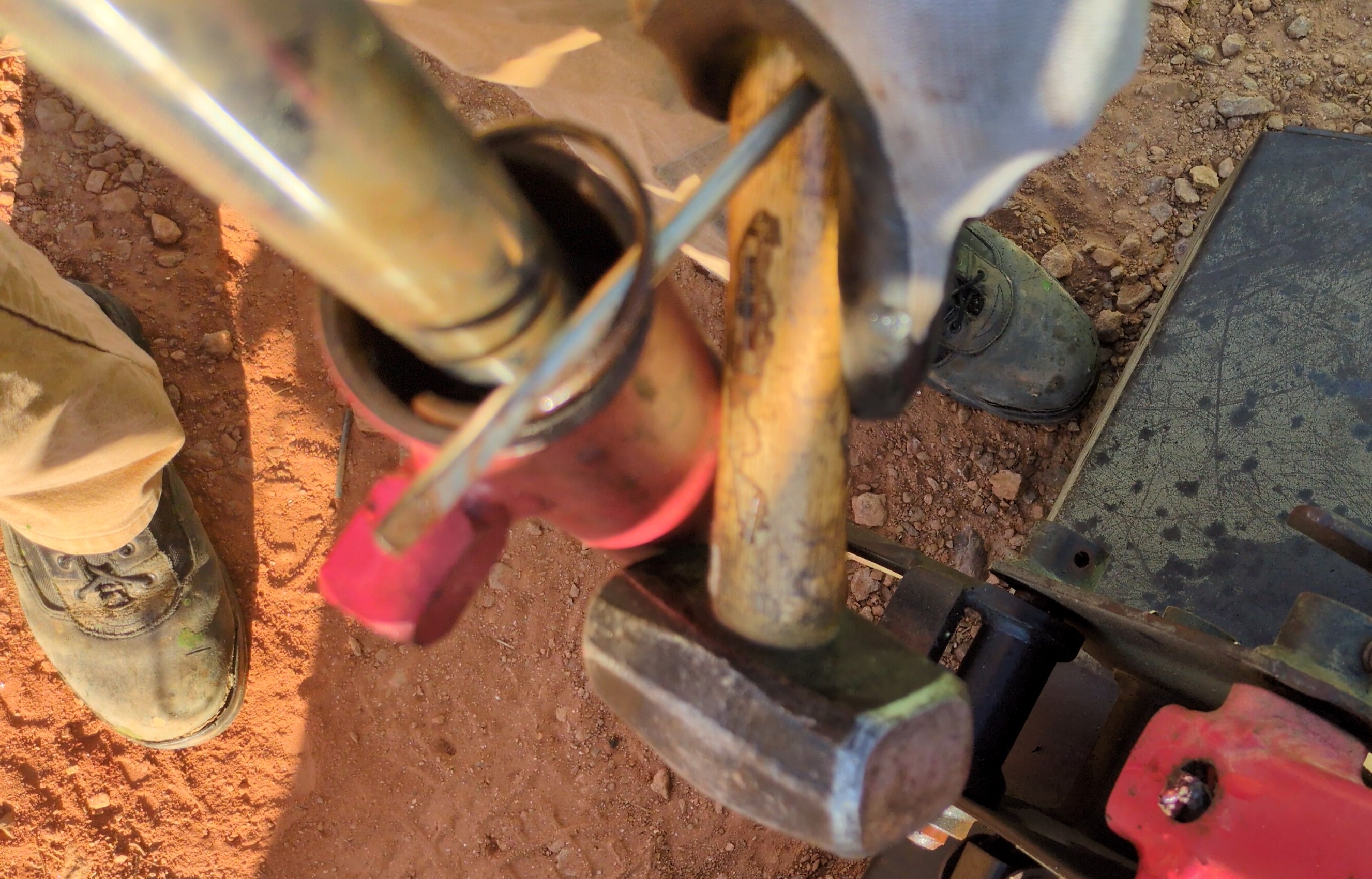

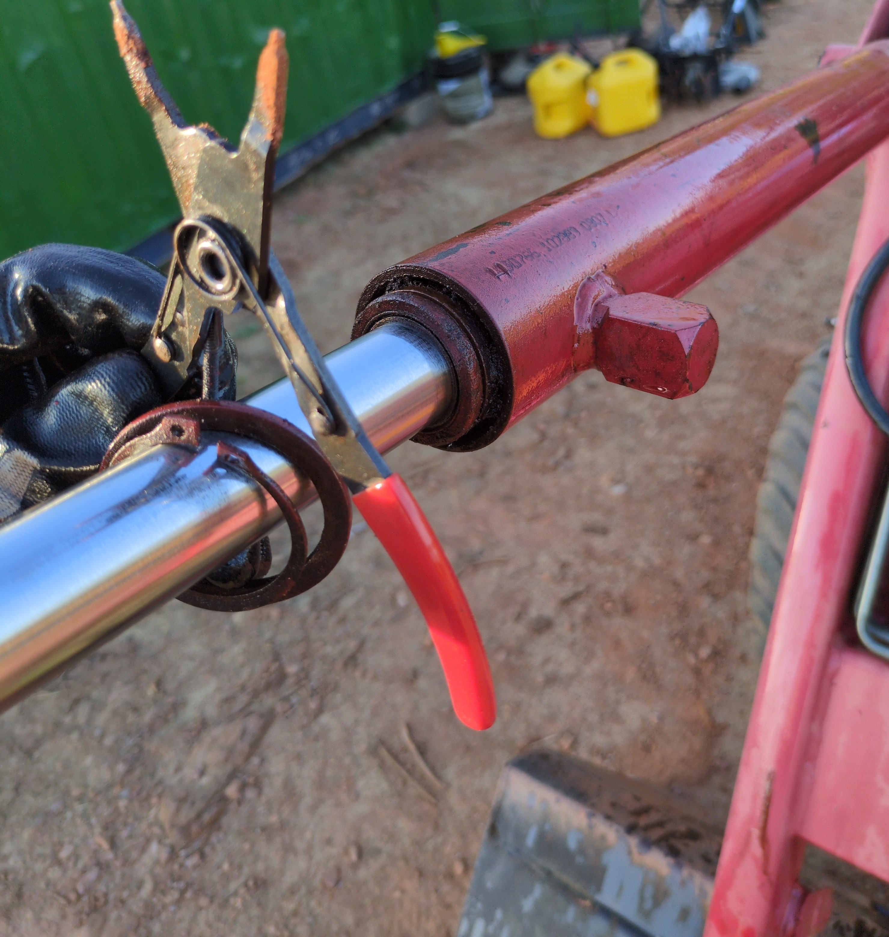

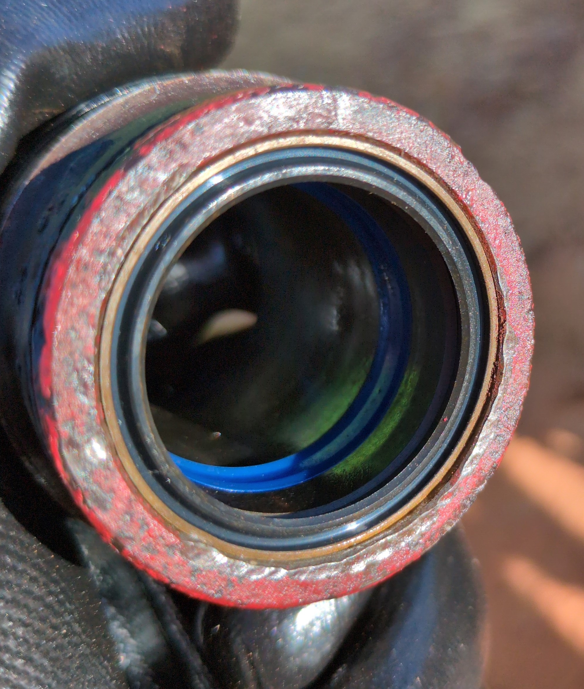

I used a hammer and punch to push the gland inside the cylinder ~1/2 inch to where the wire retaining ring was visible and could be accessed.
To remove the wire retaining ring, I found that a medium sized flat blade screwdriver with a tap by a hammer to push one end back (inside) went easiest. With that end back, I could get the screwdriver behind the outside of the ring and pop the other end out.

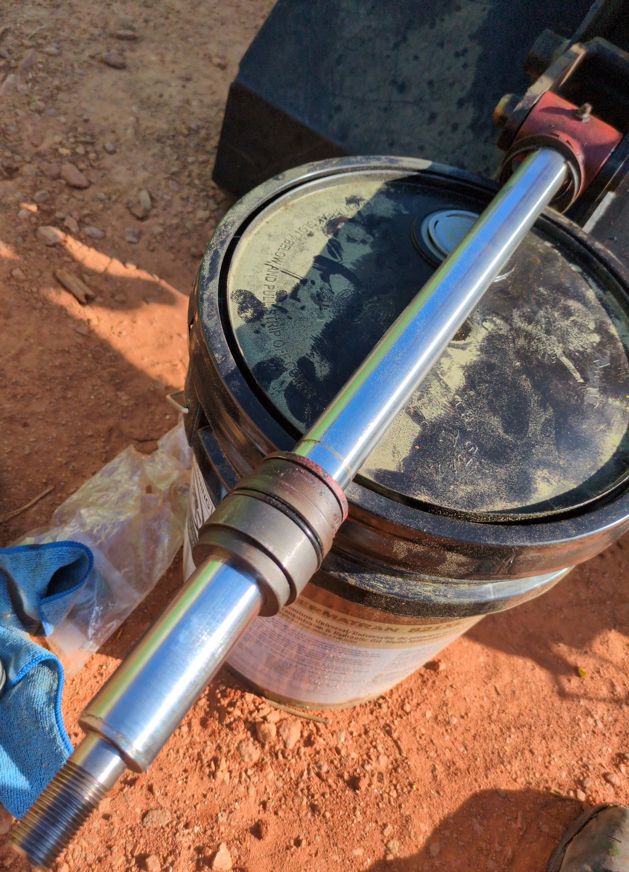

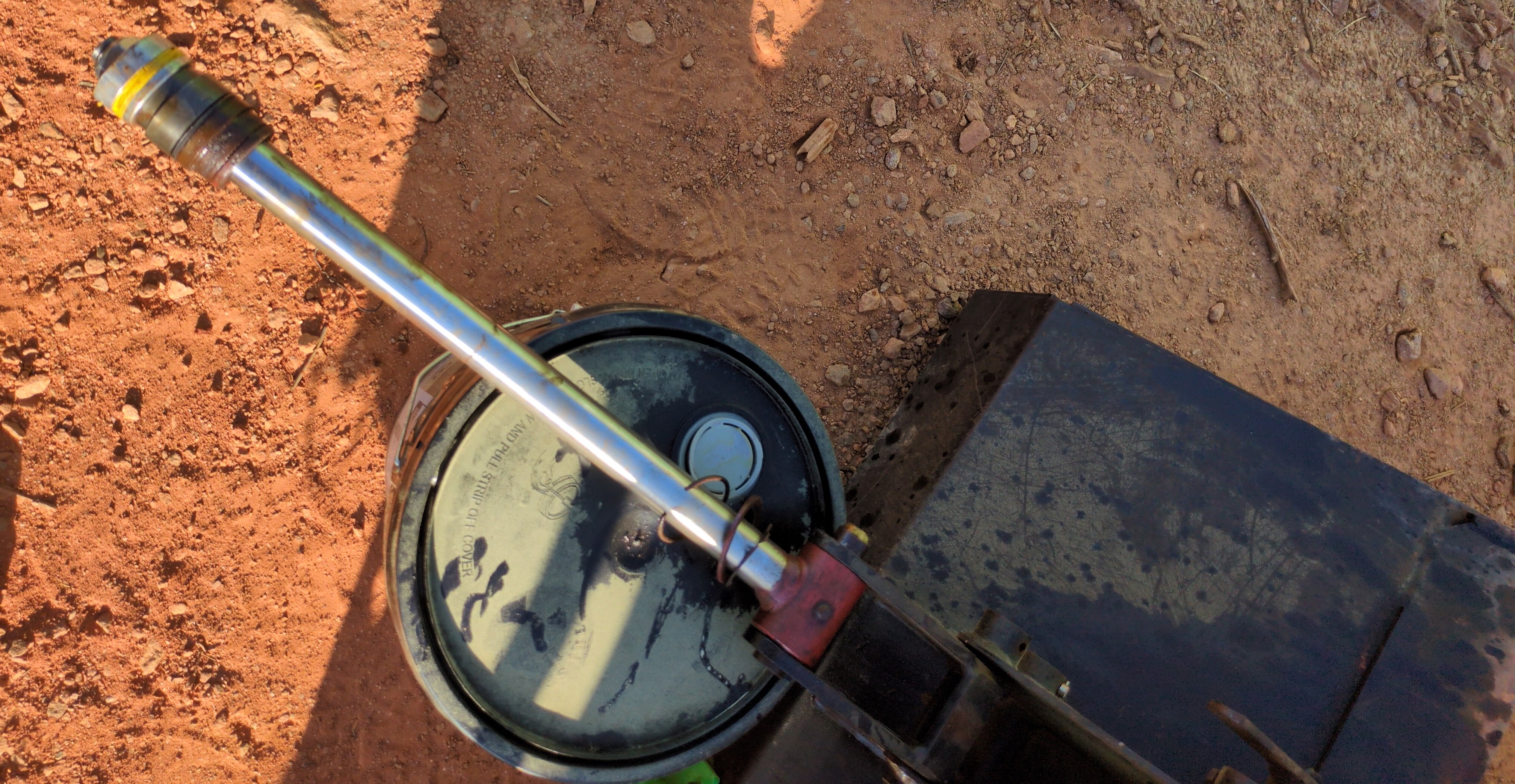

I turned the cylinder back over, re-pinning the piston to the lower bracket. With my FEL bucket face-down, it set the piston at the perfect height to allow me to lay the piston across the top of a 5gal hydraulic oil can.

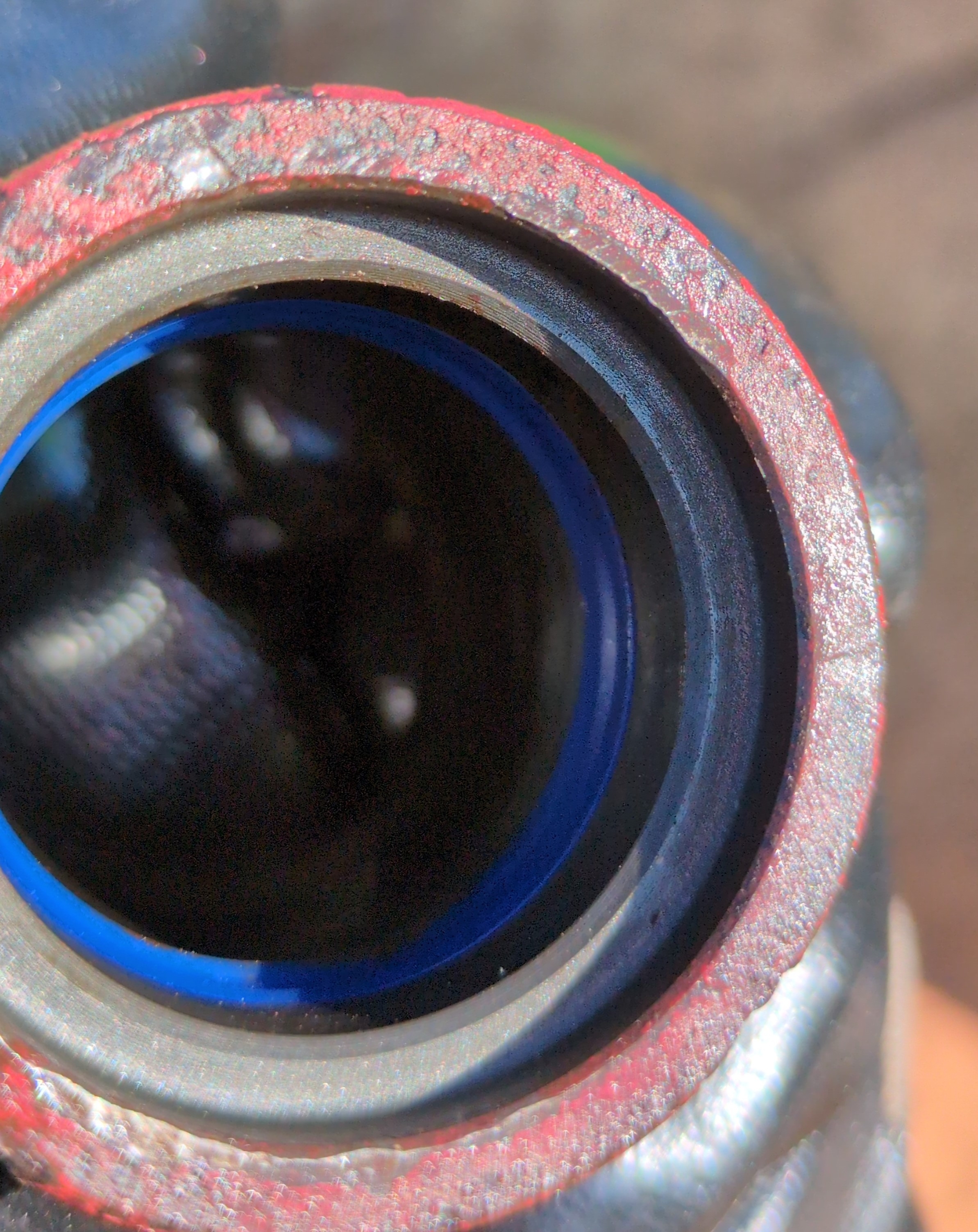

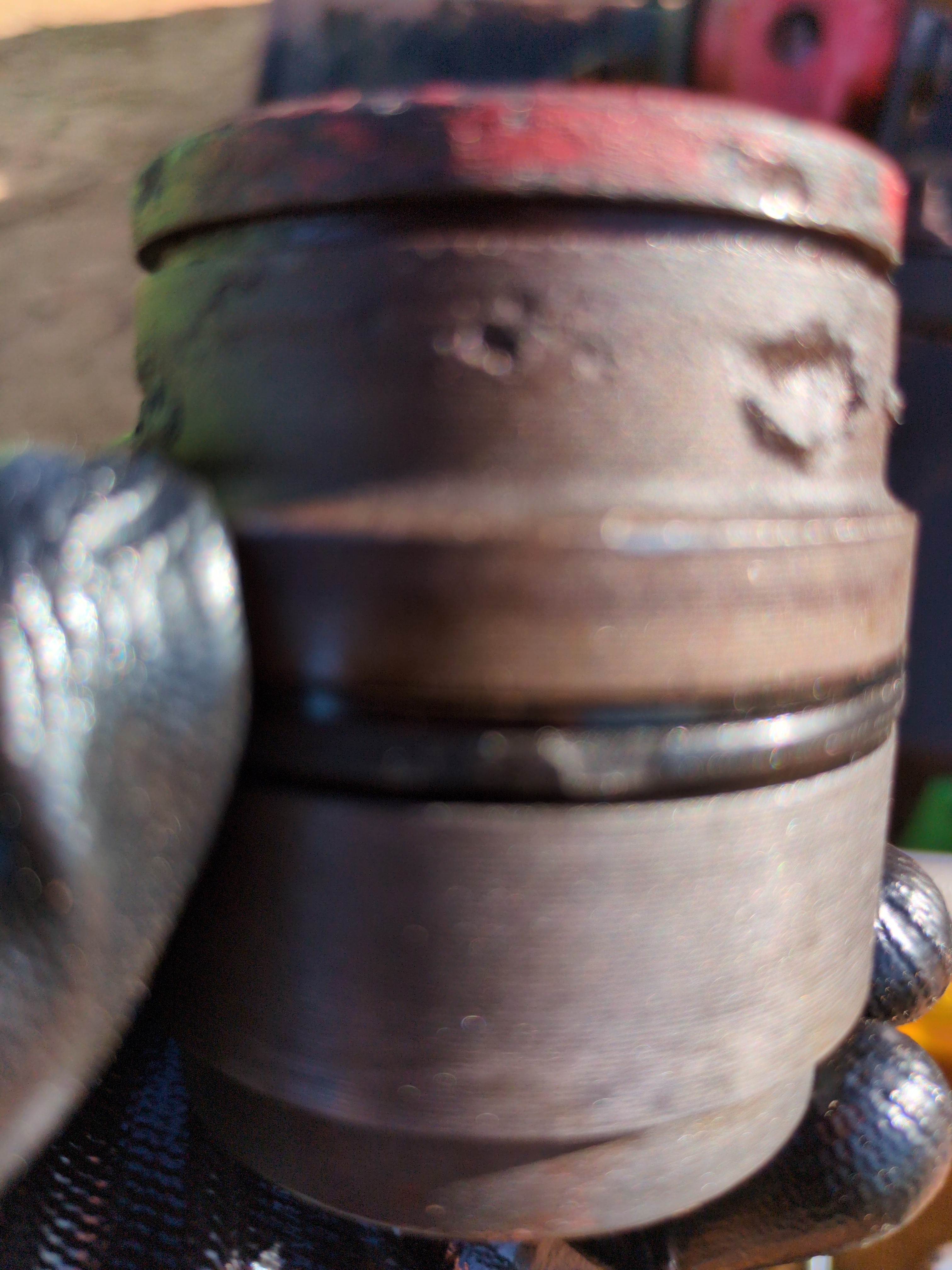

My seals were so shot that the cylinder case came off easily.

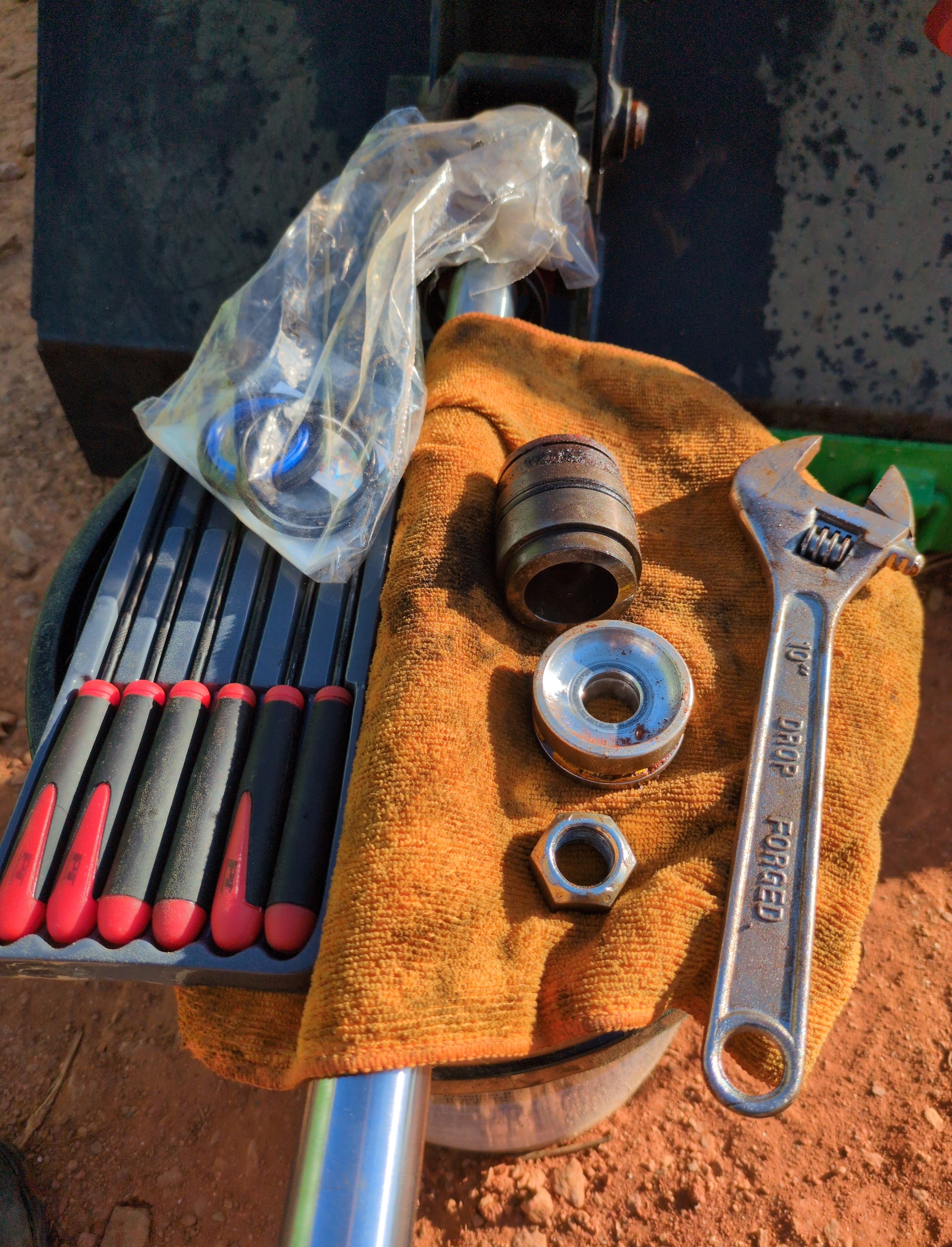

With the piston still pinned to the tractor, it kept the piston from rotating while I used an adjustable wrench to loosen the nut. The top of the 5gal can made a decent shelf for the task.

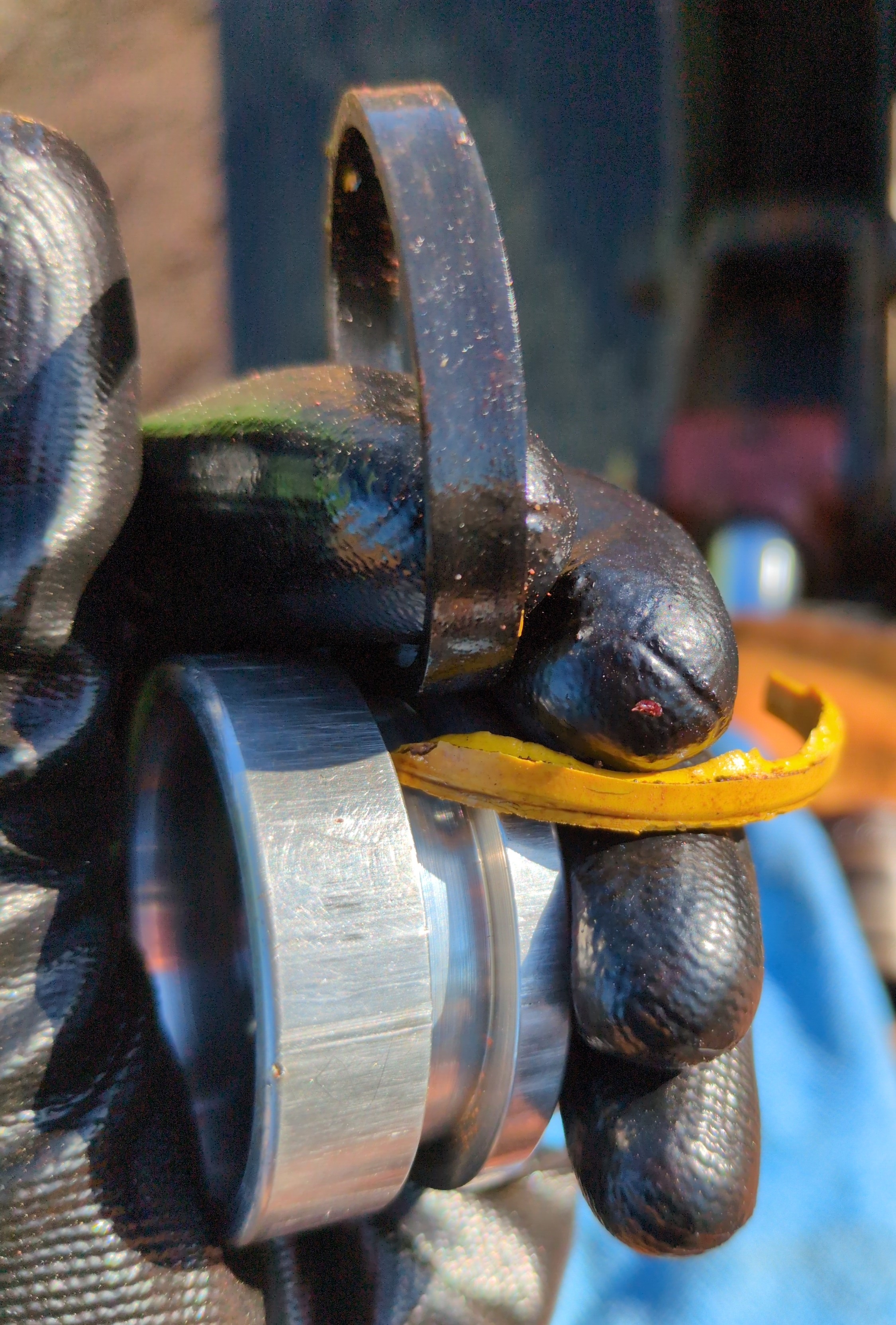

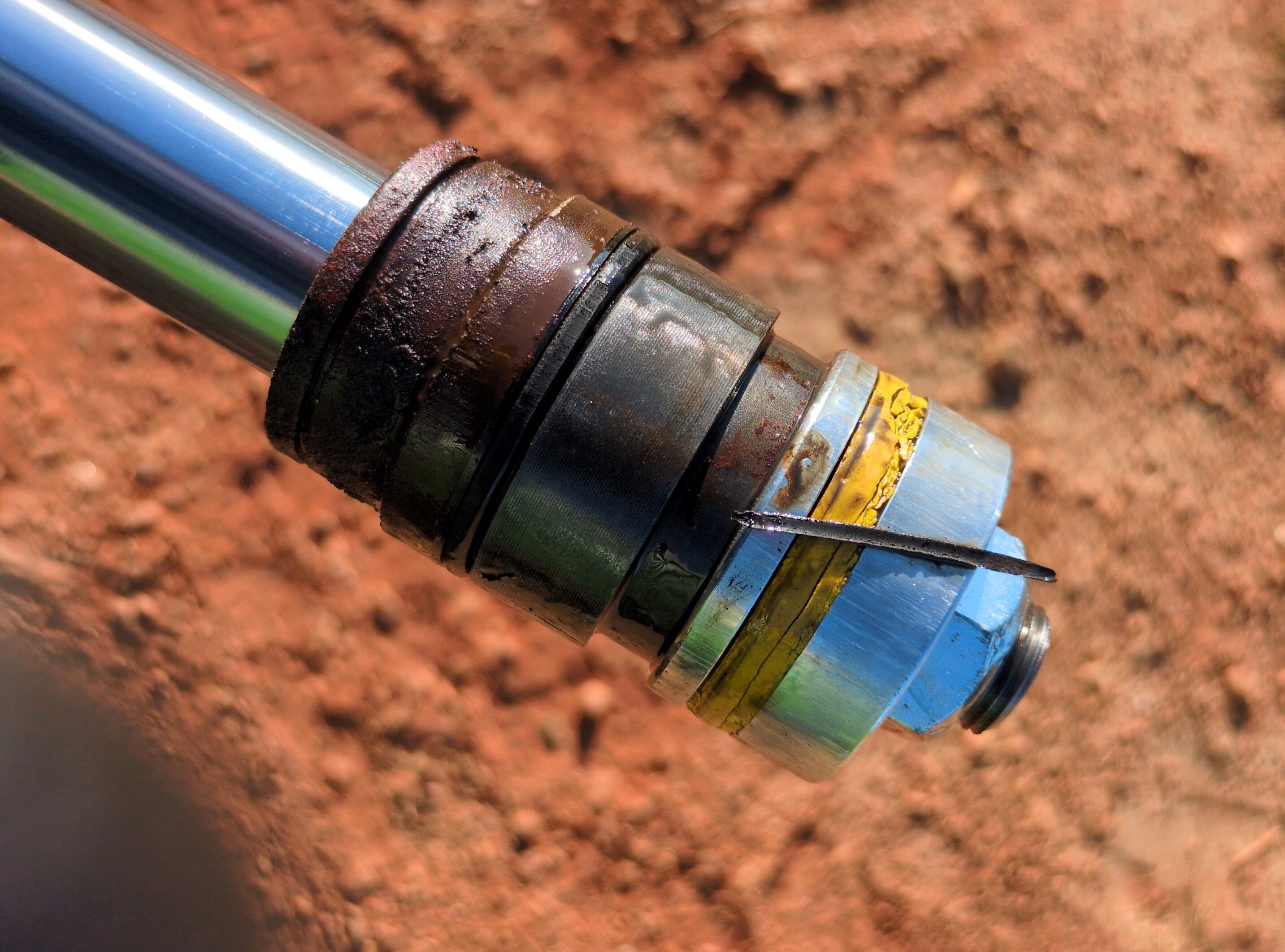

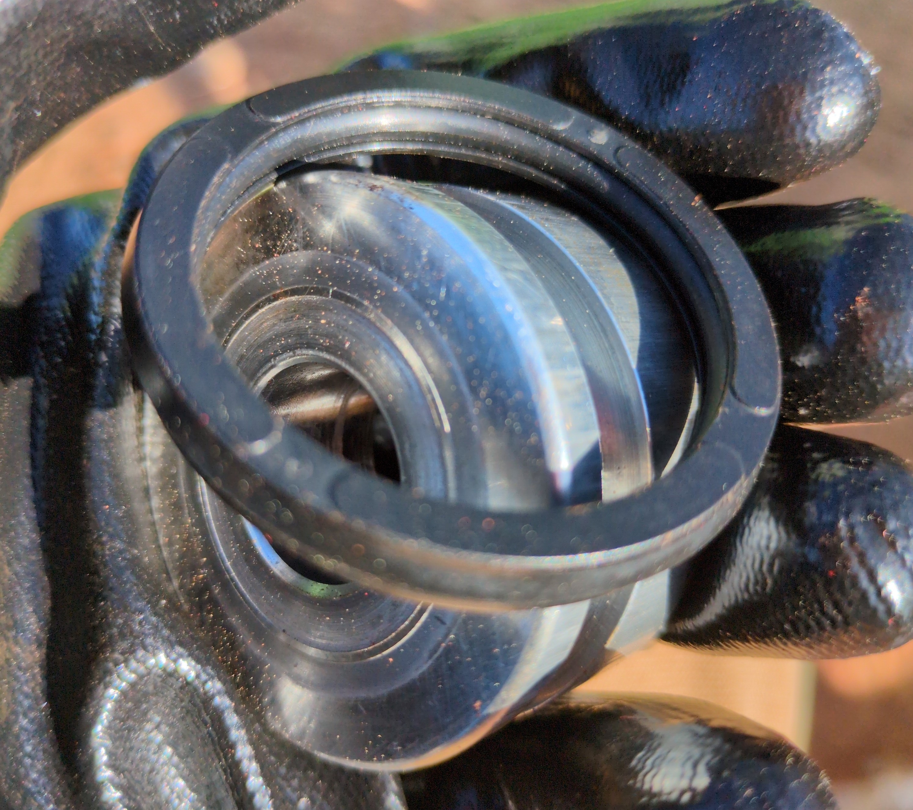

For the end piece, there was the two-part wipe on the outside and nothing on the inside.

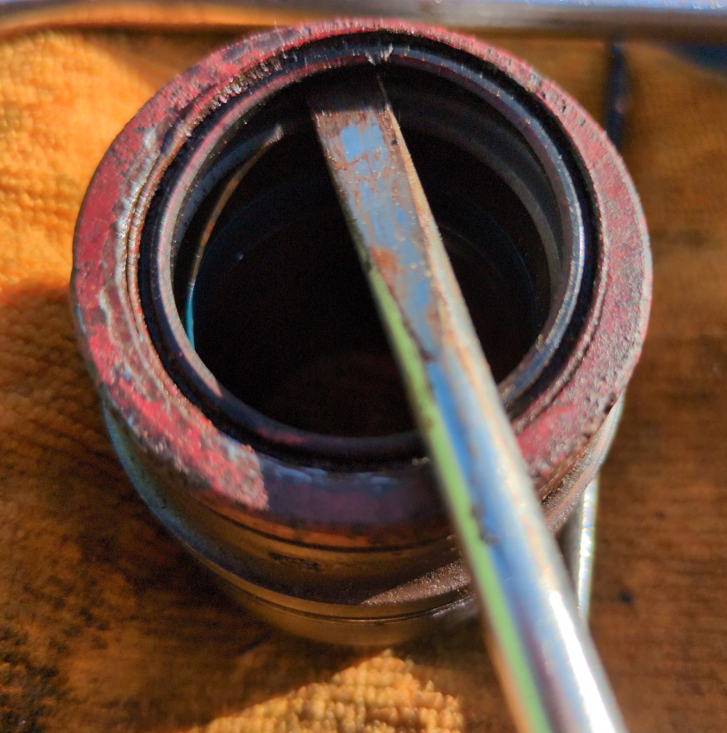

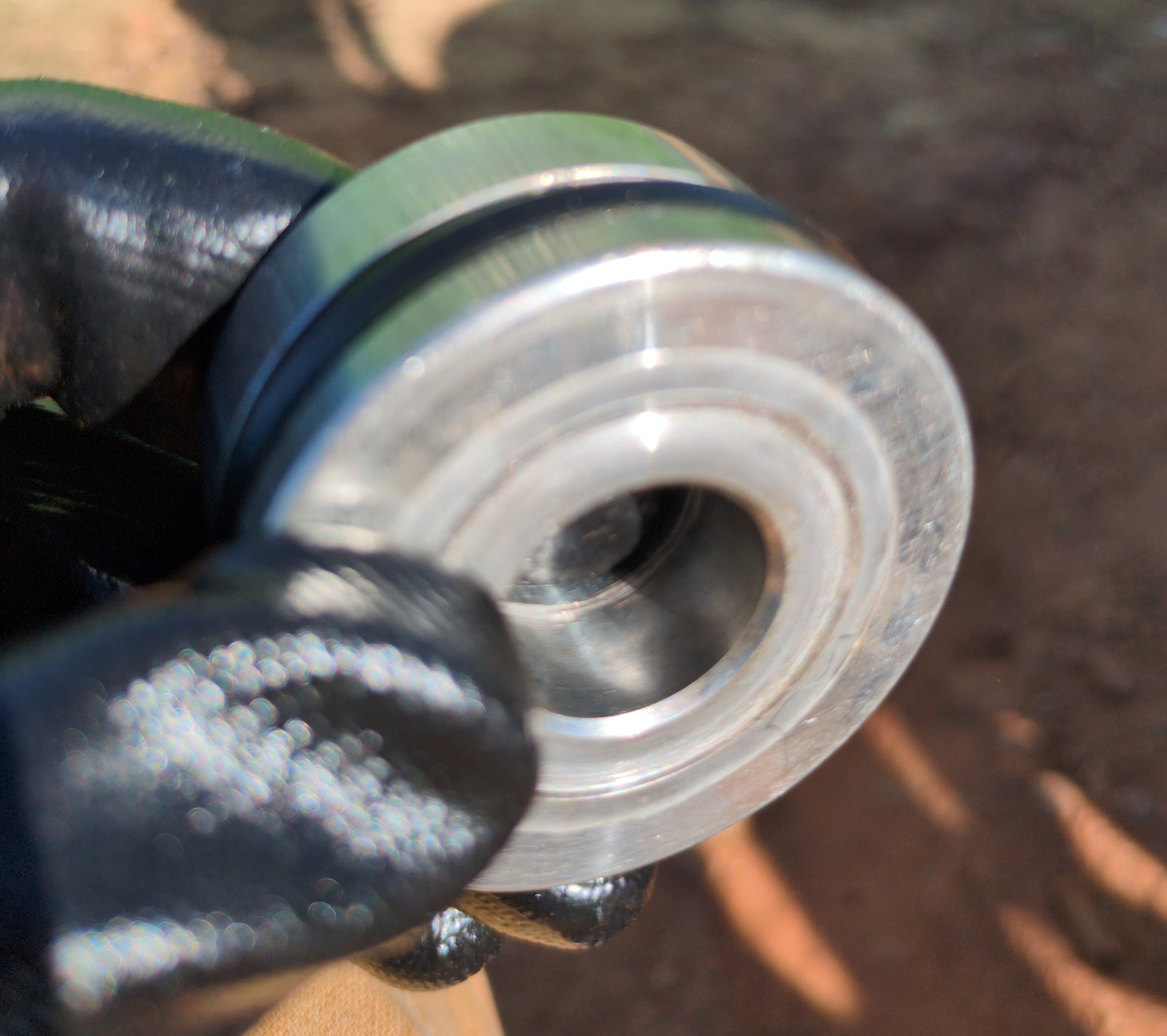

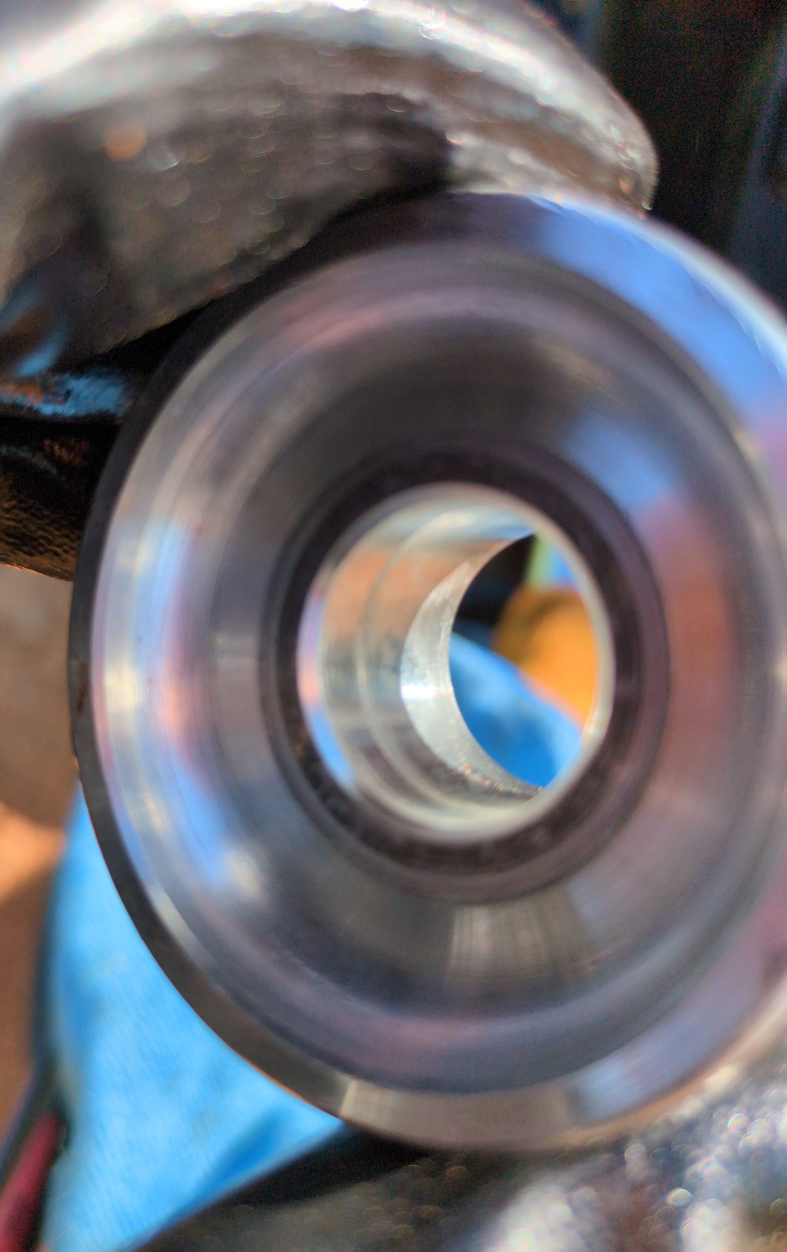

On the gland, there was a bushing / dust cover that was pressed into the end. The flat blade screwdriver fit in underneath and it didn't take much pressure to pop it out.

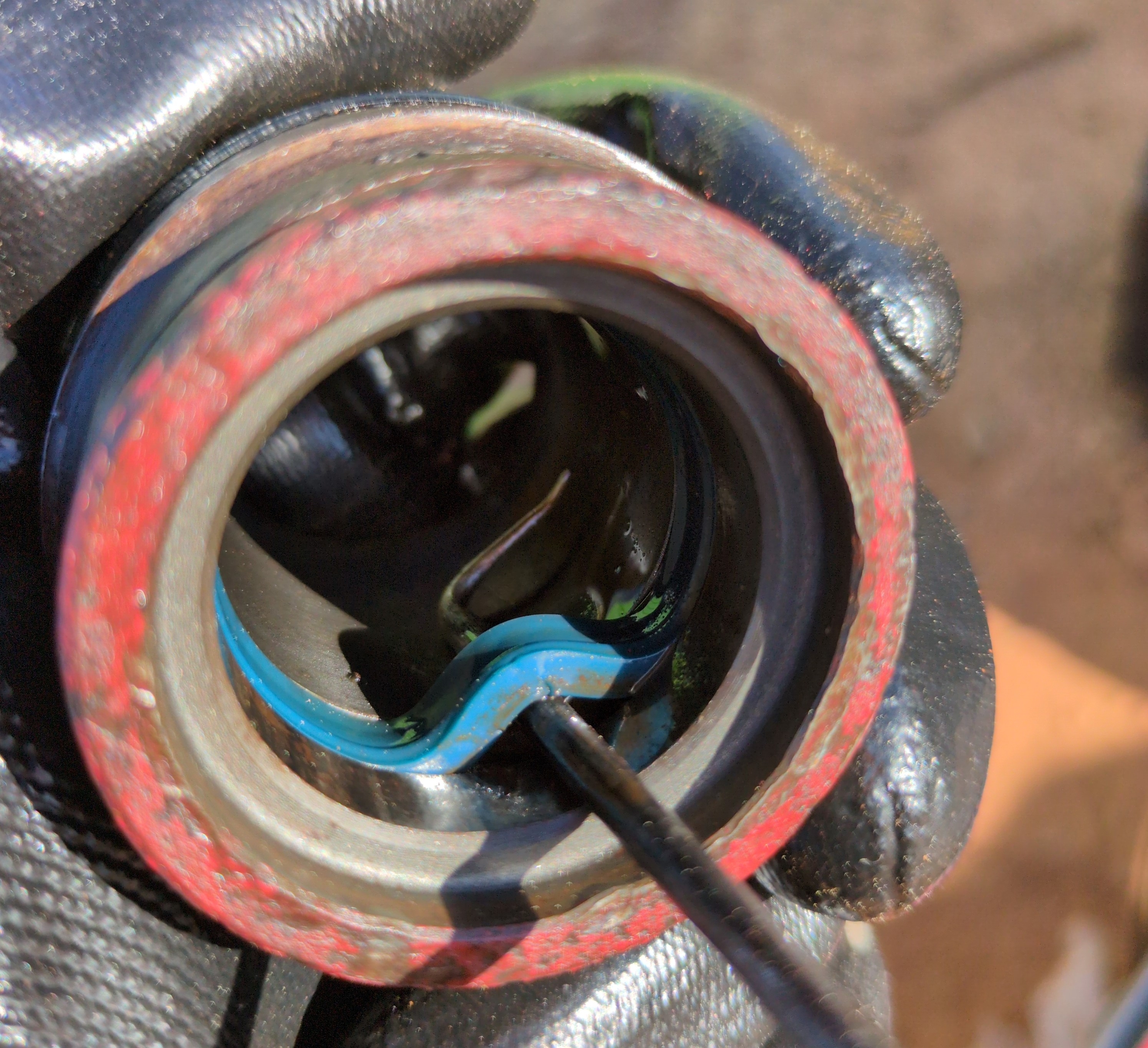

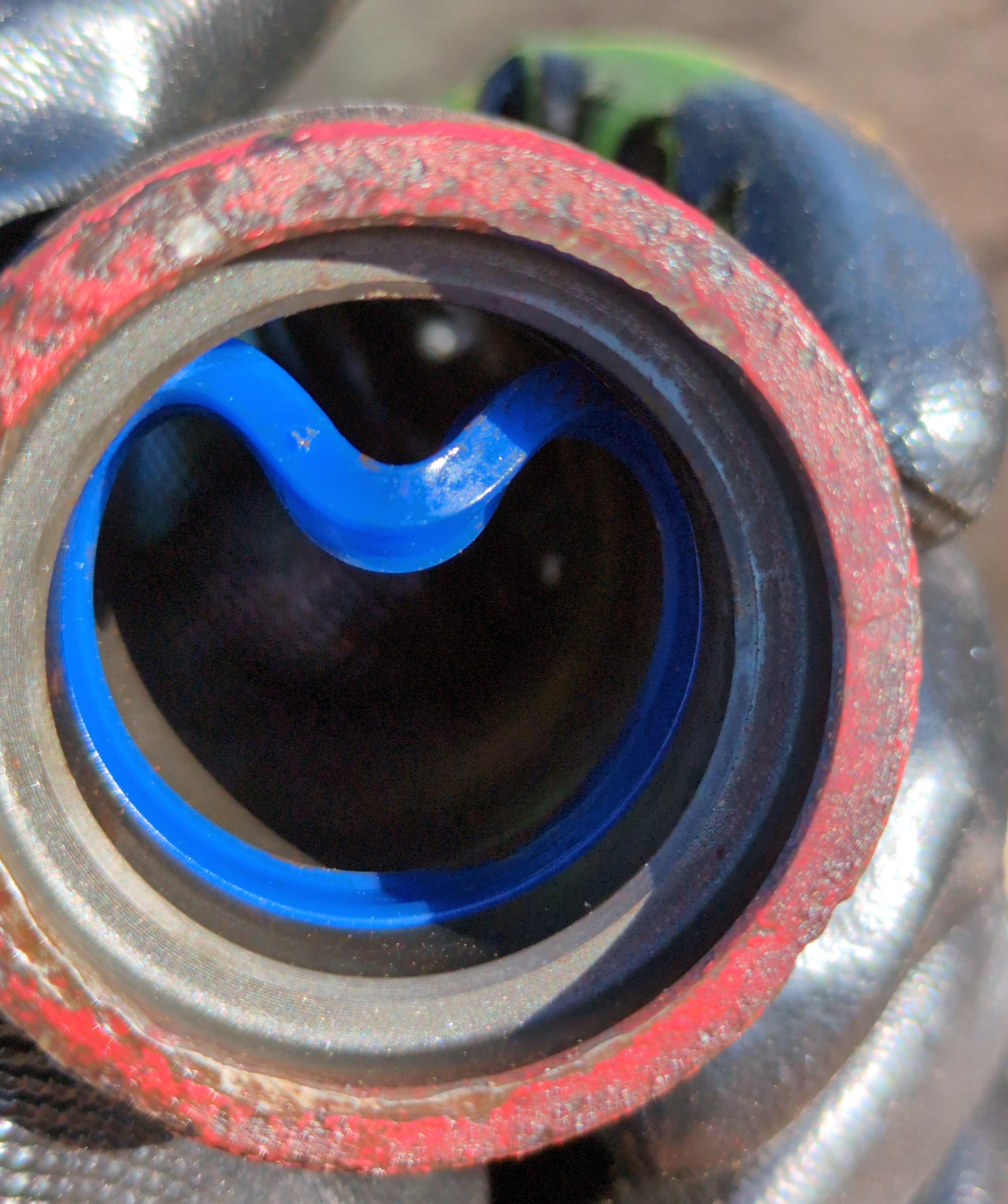

The outside of the gland had a flat wipe backed with a thick O-ring, which came right off. The inside of the gland had a squared wipe which also came off easy with a pick.

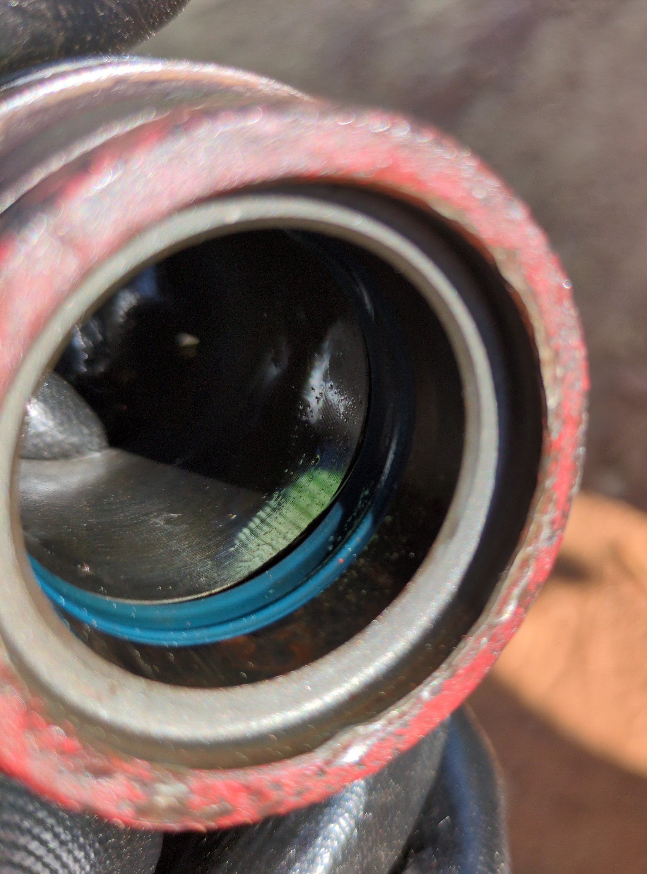

The trick to getting the inside seal in is to shape it like a kidney far enough to get it into its grove inside, then with a nudge, it'll pop back into shape.
Note: There is a 'front' and 'back' to the blue wipe; make sure it's oriented the correct direction.
The bushing went into the gland nice and tight.
NOTE: I got over-eager on the 2nd run and smacked it with a hammer and put a slight roll on the edge of the bushing. It would've gone better had I used something flat between the bushing and hammer.

The replacement external wipe for the end was completely different than the original (two flat pieces, yellow in the earlier pics), it's an o-ring inside a 3-sided ring. I found it easiest to put the o-ring on first, then the outer ring. That way, the o-ring seemed to help hold the outer ring in place vs. doing them together.
