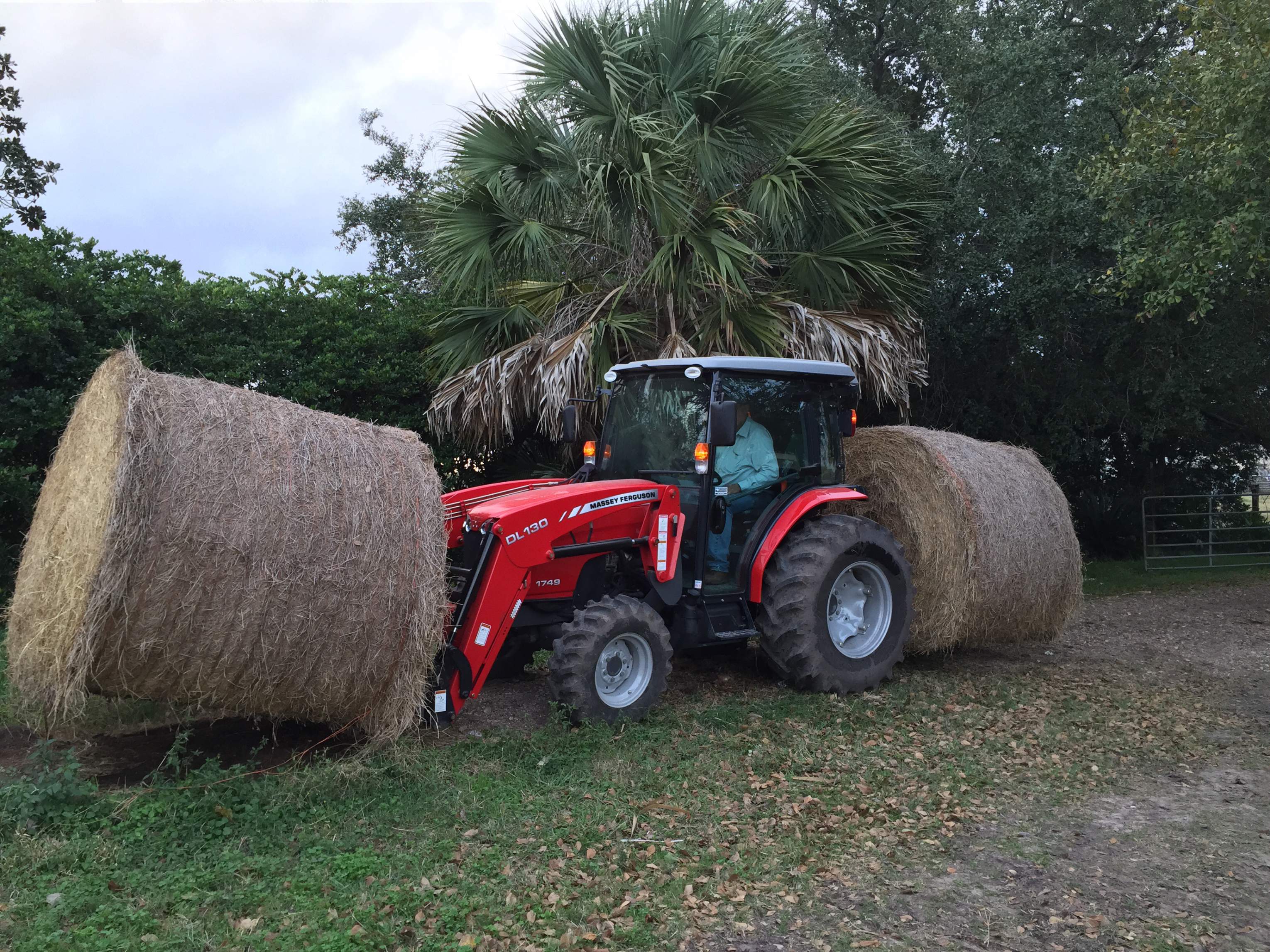

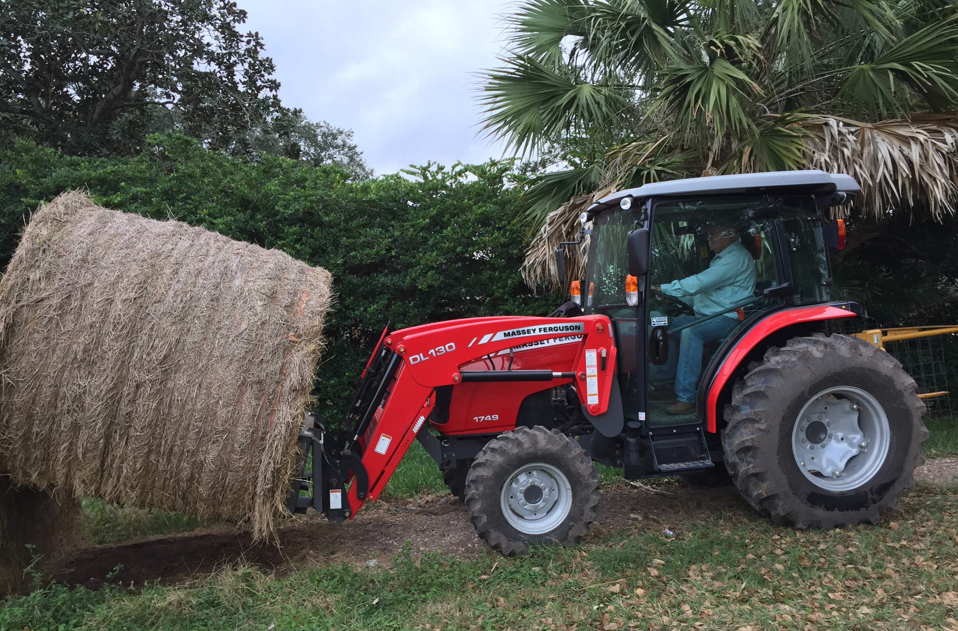

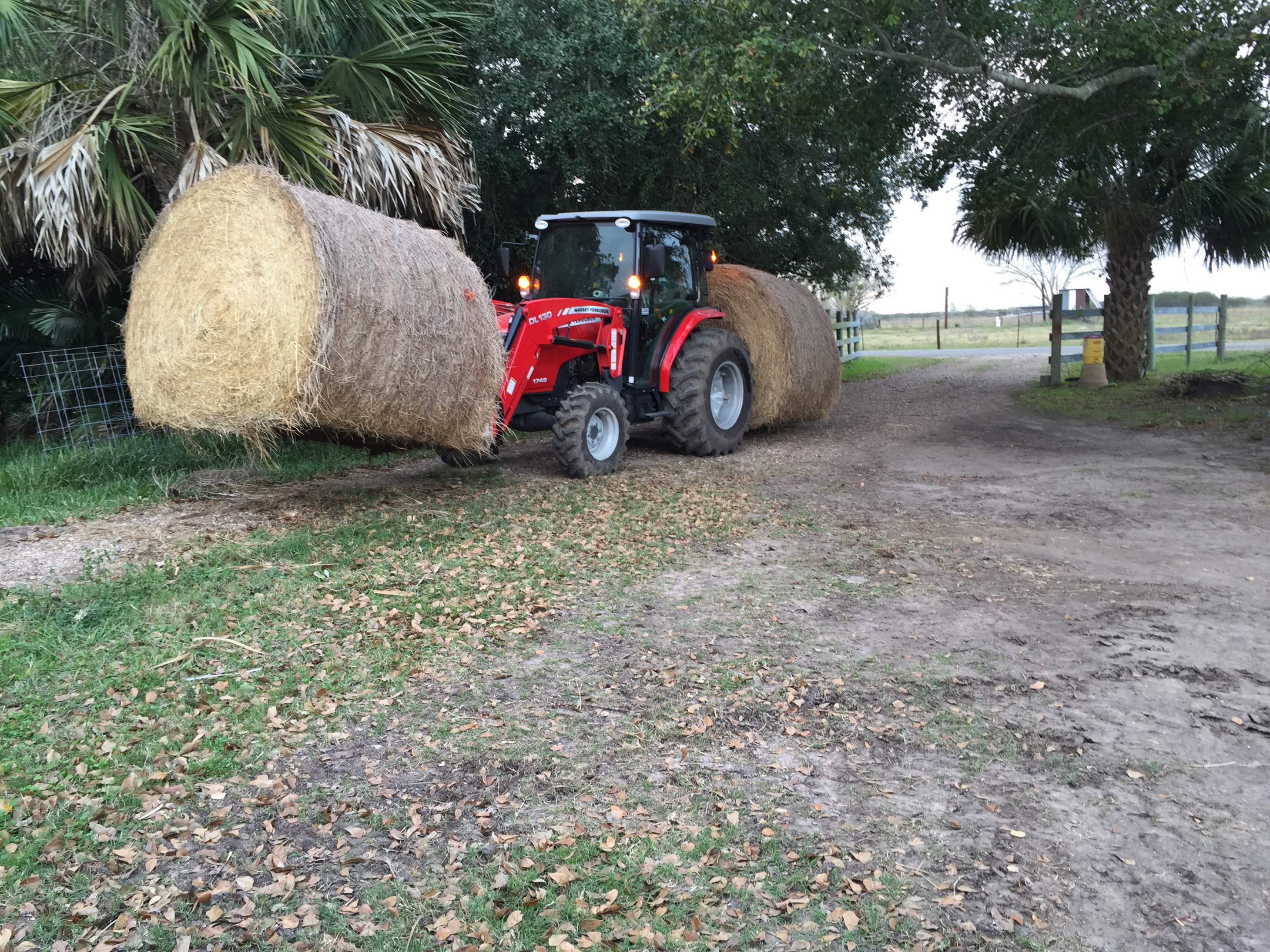

My father owns a 1749 with cab and HST, he paid a little over 40k for his after adding extra rear remote and some other options to the tractor. His had to order his, took right at 6 months to arrive.
Been a great tractor for him, no serious issues so far, but if you're planning on lifting 2000lbs on the front you should know that the front tires are really loaded when he lifts close to that kind of weight, unless you have something heavy on the 3ph. for counterbalance. Also, he has to slightly rev the motor to 900 - 1000 RPM or it will not lift large, 5'x6' round bales on the front.
