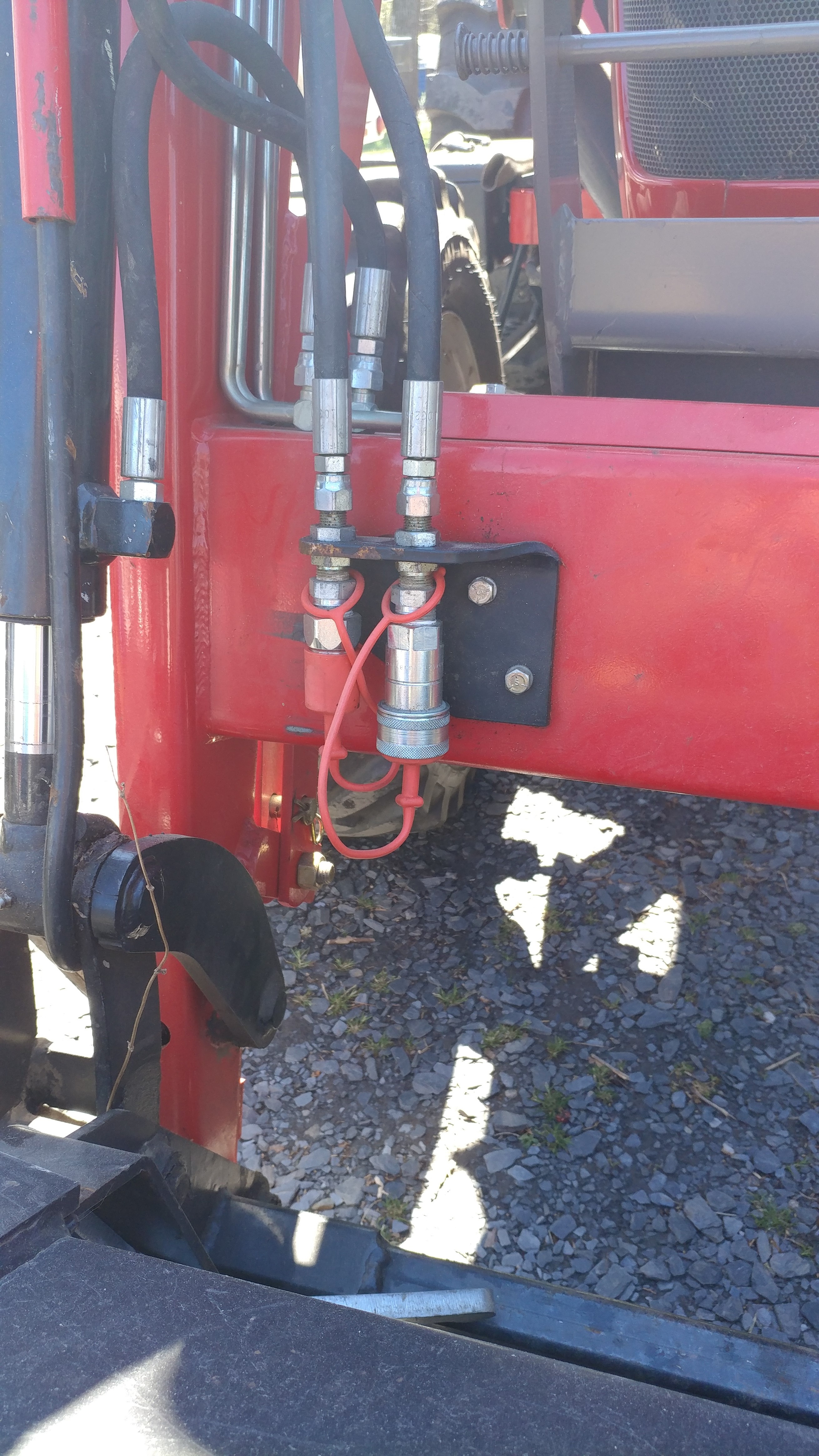

Congrats on the purchase of your Massey! Sounds like you have a nice machine headed your way. Something to consider with the use of a grapple: I have a rear remote on mine but also have a diverter valve on the loader that diverts from the curl position which I decided to use instead. It is electrically operated with a trigger on the joystick. It is instantaneous and operates only when I press the trigger, returning to curl as soon as I release the trigger. I don't notice it as a problem during use not being able to curl at the same time. It works well not having to take my hand off the joystick. You will be amazed at the amount of work you will be able to do with the grapple however you choose to work out the hydraulics.

My diverter was dealer installed and on the tractor when I bought it so I can't give you much more information than the photos. There is a power plug near the loader hydraulic connections that I unplug if I take the loader off. I shut the tractor off and release any hydraulic pressure to make my connection to the grapple. It really is a couple of minutes to make the switch at the most. I like having the control button on the joystick.

I ran lines from rear remotes to the front of the loader like you are anticipating, ran the lines thru some old 3" fire hose from the back to where it comes up at the loader arm (also used the fire hose on the grapple lines).
Where the lines ran along the loader arms I bought these:
3/8 IN TWO WIRE DUAL HYDRAULIC HOSE CLAMP
and was able to weld two nuts together and just bolt them on where the existing mounts for the curl cylinder lines run.
