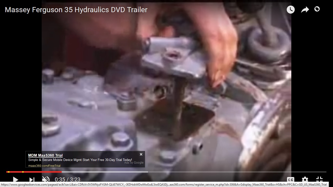

"Remove the small plate (Transfer Cap) under the seat,(front right hand corner of the cover) 5/8 or 11/16 wrench) the one that has the small LUMP in the centre when the cap is of the pipe with the O ring on it should stick out about 5mm if it sticks out more that that it means that the pipe has pulled out of the pump to put it back use a Philips head screwdriver one that will fit inside the pipe use the handle to guide the pipe back into the pump using your left hand inside to feel the hole in the pump when the pipe is in the hole push down firmly and the pipe will Click into place,"
I think this is a pic of an older model version of what shoan13 is referencing ...
   / Massey Ferguson 230. The little tractor that could not #49
yep .thats the sucker.
Hutch.
