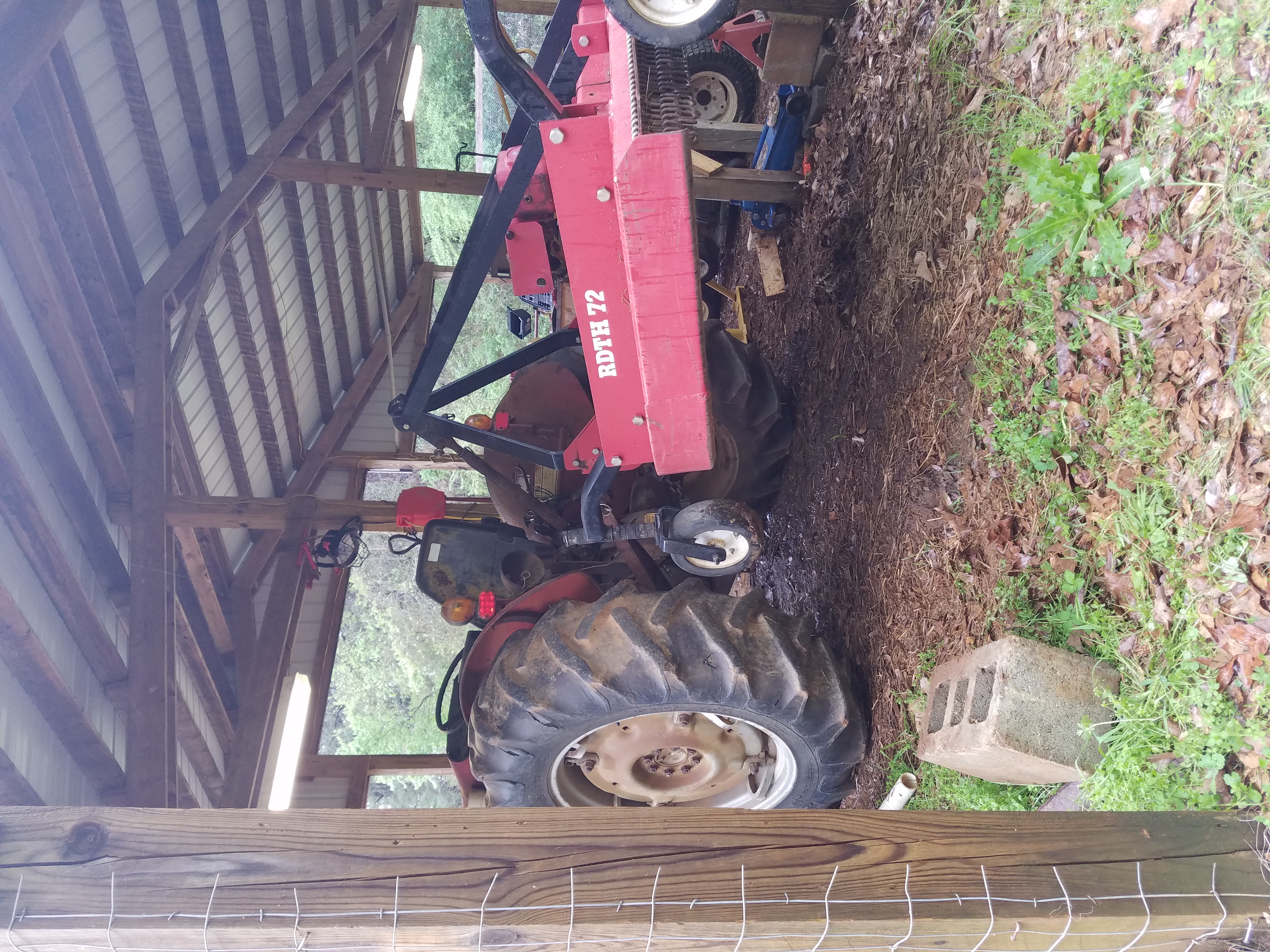

I got my replacment cover in today. Hopfully all will be well and i can get her up and running soon.
I was pleased to see i got a little bonus. The lid has hydro hoses connected where the pump stand pipe comes up. It has a diverter valve connected to that. I assume there will be more parts needed to get a set of remotes running. 20170329_061224.jpg20170329_061250.jpg

I'll need some insight as to how to best get the hydraulic remote to work and what will be needed:confused2:
   / Massey Ferguson 230. The little tractor that could not #89
That looks like it may be a JIC adapter. With that setup like it is now, you can hook a single acting cylinder to it with a JIC hose (see http://www.surpluscenter.com/images/techhelp/JIC.pdf to identify the fitting size), then a JIC to NPT adapter and a NPT quick connect.
For reference, that is probbaly a selector valve such as 3/8" NPT 2 GPM PRINCE SELECTOR VALVE
If you want to use double acting cylinders, you will need to replace the valve with one like 1 SPOOL 2 GPM PRINCE RD-2575-T4-ESA1 DA OC VALVE and run two hoses from the valve to the quick connects.
Aaron Z

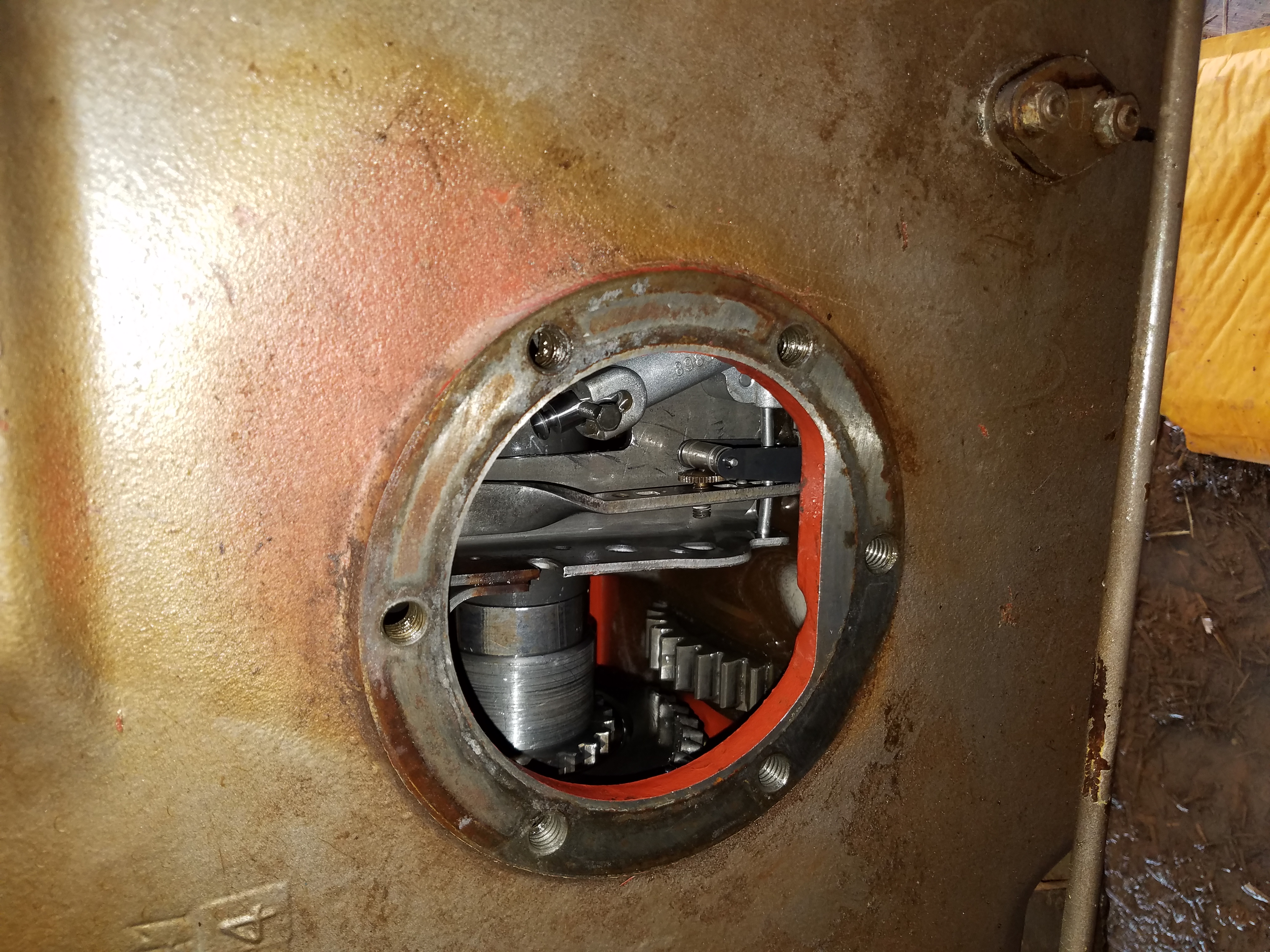

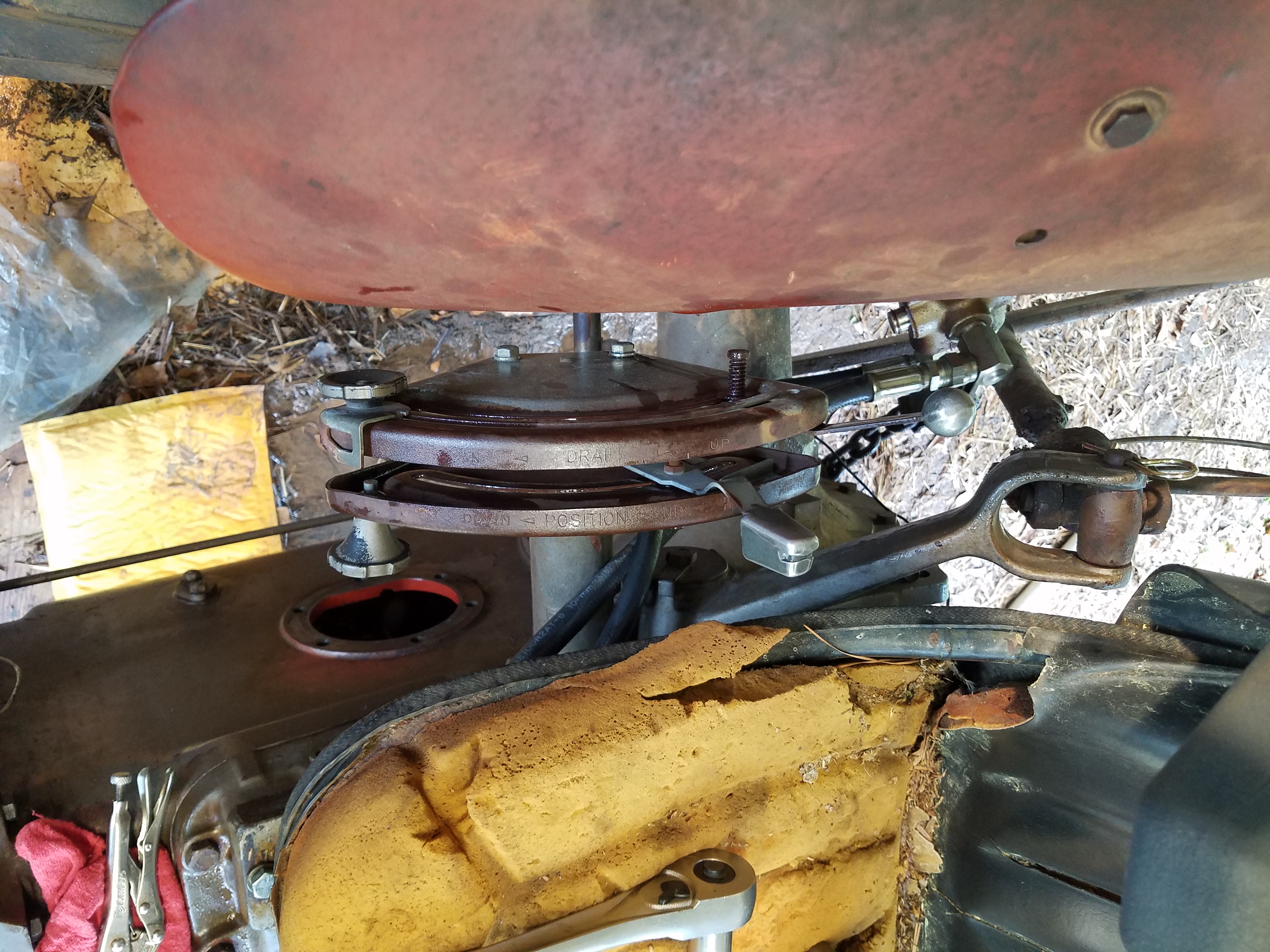

I'm not sure about the adjustments or the draft control settings but at this point the hydraulics seemed to lift implements correctly when the draft control is all the way up, and the inside control lever is used to go up and down. At this point I have not completely filled the tractor with oil it is still below the lowest bolt in the side cover.
I was not sure if adjustments need to be made inside the side cover before I close it up.
I did review the manual but I'm not really clear on setting the draft control up as I don't fully understand it and many of the references discuss pressure control which it appears my tractor does not have.
