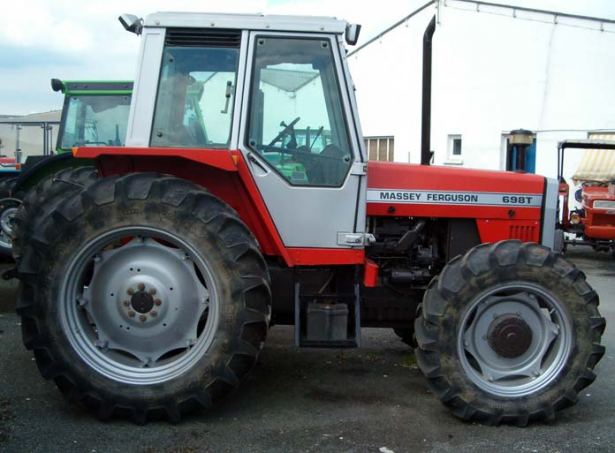

We had 2 mf 698 turbo's that had 318's in them pushing out almost 100hp pto , One did 10'000 hrs opened once and the other blue smoked it's way to 14'000 hrs having never had the head off . Ether is fine if used properly these two had plenty of it :)
