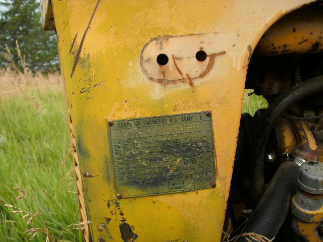

Hey Fat Farmer Andy. I have the same exact tractor and problem. my serial number is( 67960300451 ) It was also the industrial yellow. but now its red and gray. the stamped plate is not a fake. please feel free to contact me . jevanshunting@gmail.com . It also has rear inner wheel weights Z134 engine 4 cylinder gas. sweet tractor

Hello Central Vermonter. I have the same problem as Fat Farmer Andy. I have a MF35 that was once yellow and the serial # is (67960300451) the tag looks identical to the one in his post. please help. is this a government model you think? HappyNewYear!

It appear the 679 prefix on the serial number could represent government purchased tractors. I think the serial number follows those three numbers. JMO. -kid

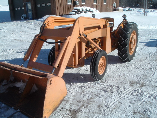

I sent you an email, from what research I've been able to conduct it would appear as my machine had a military dataplate at one time. They were attached to the hood on the left side under where the headlight would of been. I've had a collector send me a pdf file of the only known 'government 35' that I've been able to find parts manuals or information for, and those machines shared MF 35 utility serial number sequencing (serial starts with 655) The first two pictures are of my tractor, and the third is a picture that came off the internet of a similar tractor for sale, with the location of the military dataplate. DSCF0081.JPGDSCF0084.JPGlisting_pic_599230_1374360158.jpeg
You can actually access the 655 series government 35 parts manual through the online ago parts manual database. The only difference my machine has is that it has the adjustable ag front axle instead of the fixed industrial front axle.
