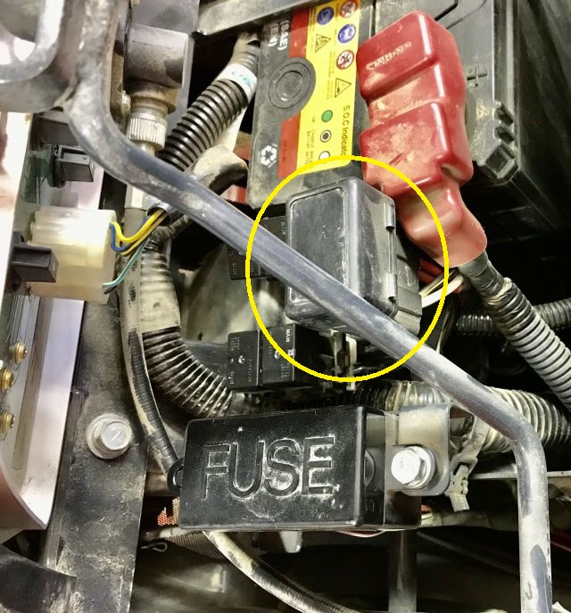

Does anyone have any advice for a temperature gauge for a Massey Ferguson GC 1710 that doesn’t work. I recently bought the 1710 so I have no idea how long it has not been working. Any thoughts or ideas would be greatly appreciated. Thanks

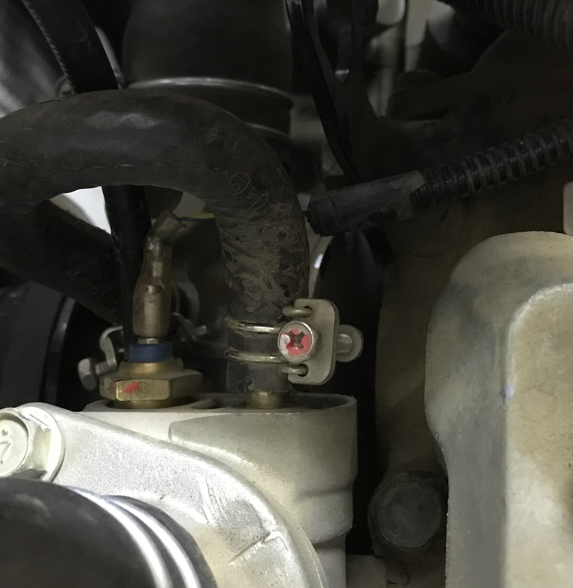

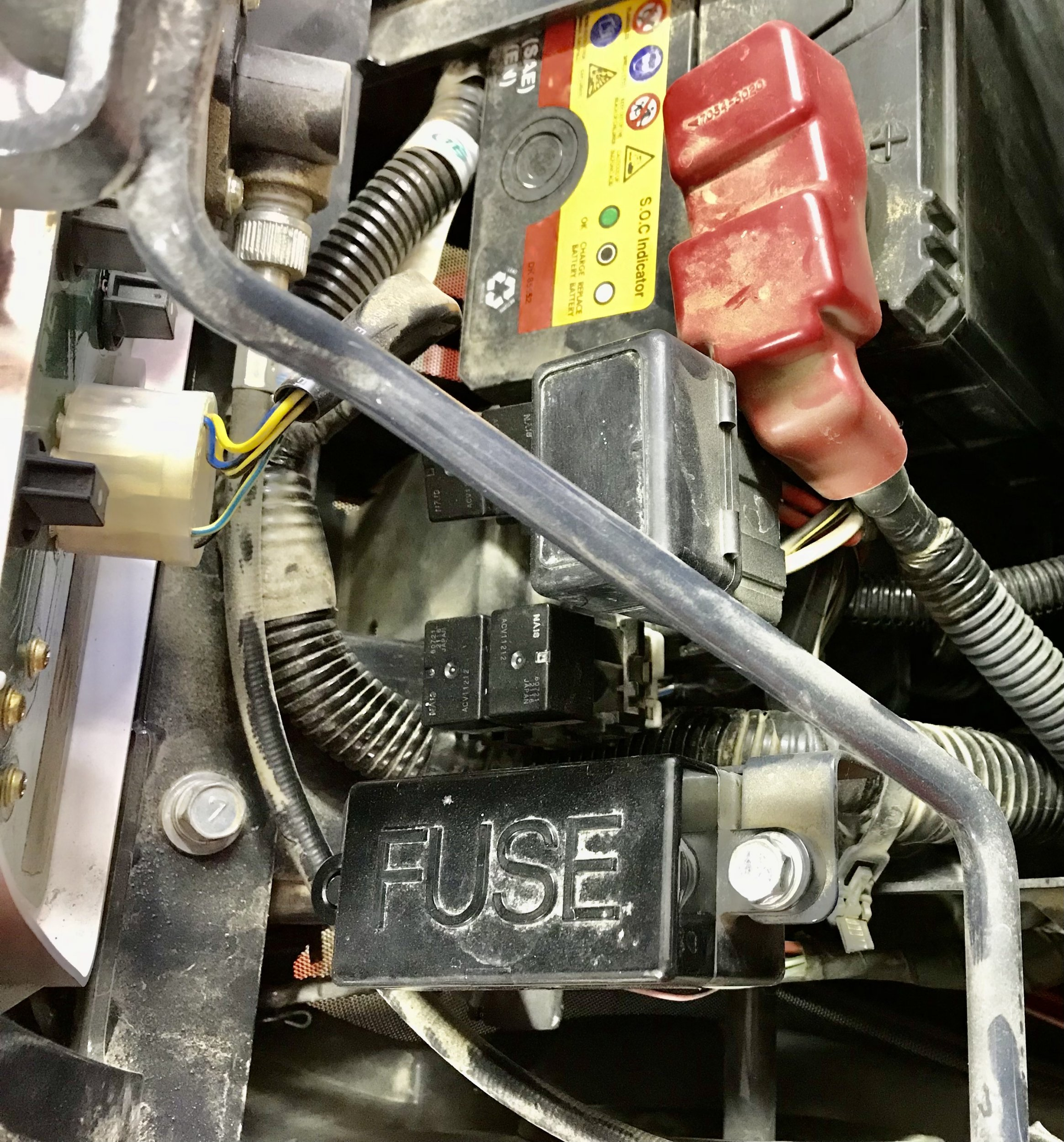

Thanks for the ideas. I appreciate it. I checked the three screws on the circuit board like WranglerX suggested and they were tight. I checked the wire connected to the sensor and it seems like it is connected, which relates to the video seville009 referenced. I also ran an alligator test wire from the wire that connects to the sensor and grounded it to the engine and turned the key and nothing changed on the temperature gauge. I also pulled the plug from the inside of the dash and checked for visual issues and didn’t see anything. Finally, I tried to check the fuse. It appears the sensor wire goes to a slow blow fuse. However, I can’t figure out how to remove the slow blow fuse. The slow blow fuse is just above the use box. Picture 2 is of the sensor.

   / Massey Ferguson GC 1710 temperature gauge not working #5
There are 2 40 amp fuses under the cover, there is a tab on side of cover opposite hinge side.... Lift on tab, open cover, fuses pull directly straight out...

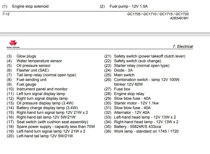

One fuse is for alternator output if fuse is blown alternator will not charge battery or power system.. (fuse 29 is electrical schematic)
One fuse is for "electrical system " power. if this fuse is blown there will be no power anywhere in system and all electrical control will be dead....(fuse 31 in electrical schematic)
If you ground input wire to gauge (at temperature sensor) and gauge does not move then problem is with gauge mechanism.... The temperature gauge uses same +12vdc supplied to most functions of your dash board...
