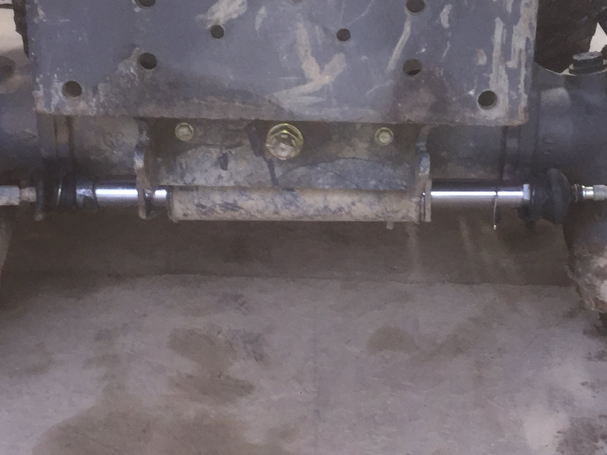

I have a question, when adjusting the steering lock bolts do you have to take into account for when the front axle pivits to max angle ( tire rubbing against frame). Seem I’ve read this somewhere.
they touch at same point no matter the tilt,

Having never been, AFAIK, "played with," here's what the steering stops look like on my 2007 GC2310 (990 hrs), after turning to the point of "complaining" and then releasing the steering wheel and setting the brake.
I do see where one stop bolt has more threads exposed that the other, which would probably explain the difference in the gap -- 3/16" on the left vs. none on the right.... Looks a lot like DMW's above, except reversed. (Perhaps I need to make a small adjustment there!)
Yes i did check when adjusting that it would not rub the frame but i dont think the ram on the GC will push the pivot far enough for the tyres to touch anyway.

I had the same issue awhile back on my 2011 2410. I remo the brackets and pounded them straight and replaced. I'm not sure how mine got that way but it seems like a poor design.

It seems like there are really only a couple of things that can cause this.
One is the stops bolts that have been discussed not being adjusted to prevent the wheel from turning further than the steering cylinder is designed to go. And this could really only happen if you had the wheel turned to full lock in one direction or the other and then hit a significant bump or rock or something the put inward pressure on the side you are turning from.
The other is too much lateral pressure on the leading edge of the wheel. This could be caused by an alignment issue, incorrect toe in adjustment. Other things that could cause this might be turning too tightly with a loaded bucket, or even just having the bucket on and making fast tight turns, or for that matter turning sharply while going to fast might even create to much pressure on the outside wheel. Even mowing on an incline as I do all of the time, could in theory be placing extra pressure on those stays.

Adjust your stops if it has any also check toe in
If you are turning hard and hit something and stops are not adjusted right it
Would push cylinder
