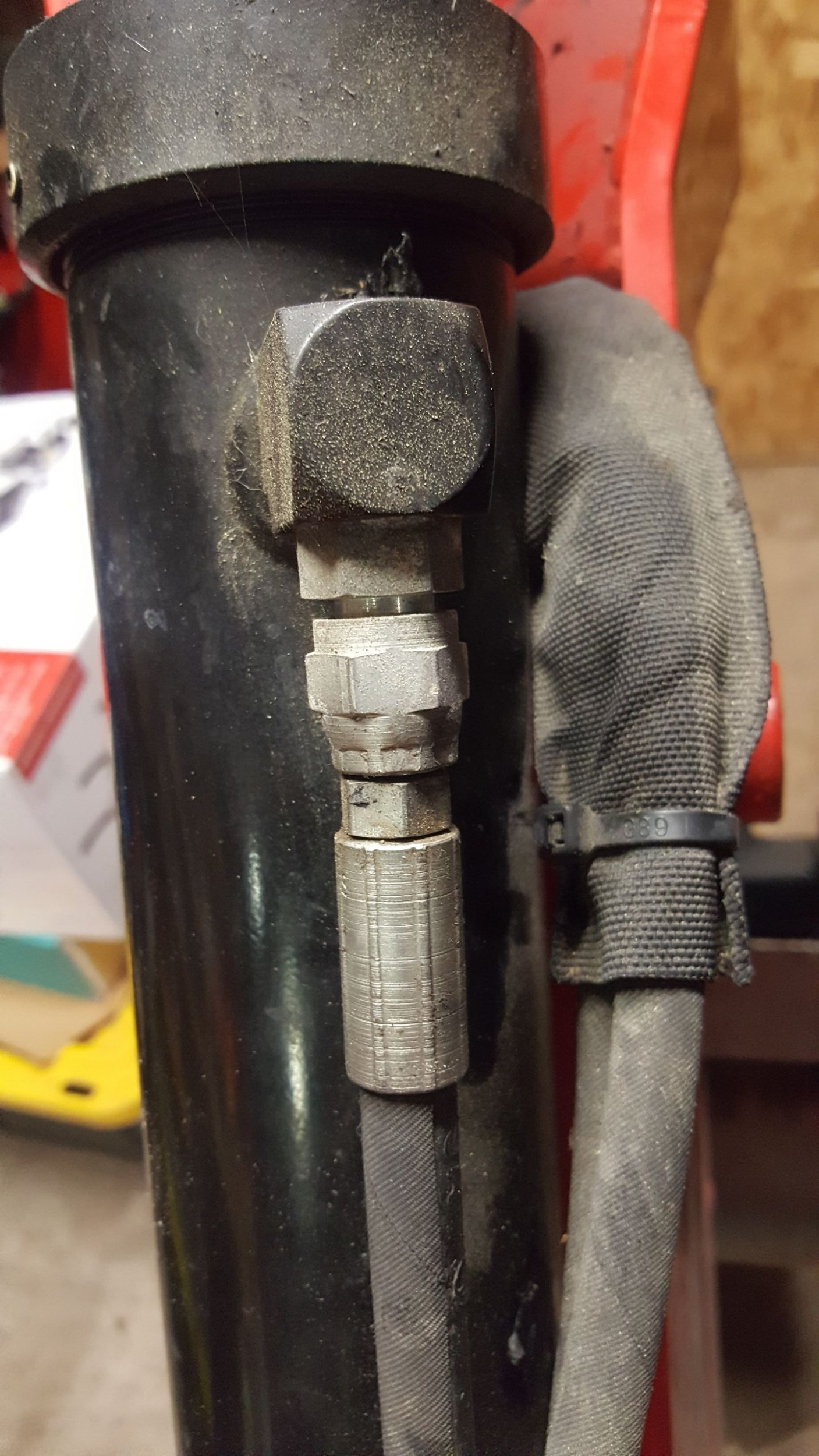

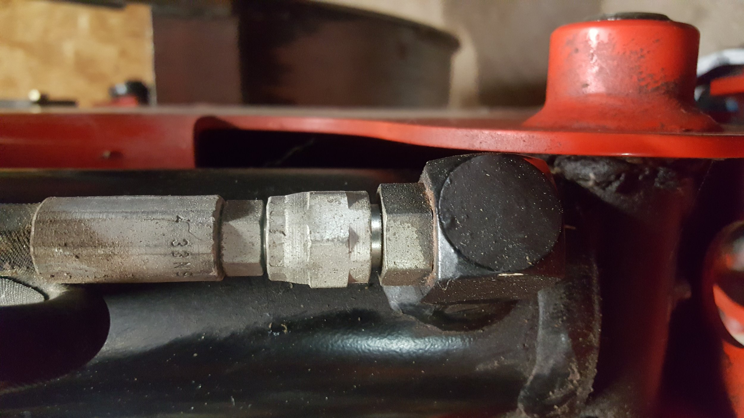

After reinstalling my backhoe last week, I discovered a hydraulic fluid leak from the boom cylinder hose that makes it's connection closes to the tractor.
The hose has a pinhole leak near the upper boom where the hose makes a 180 degree turn.
This hose has been rubbing near the squared off edge of the metal plate at the upper end of the boom assembly.

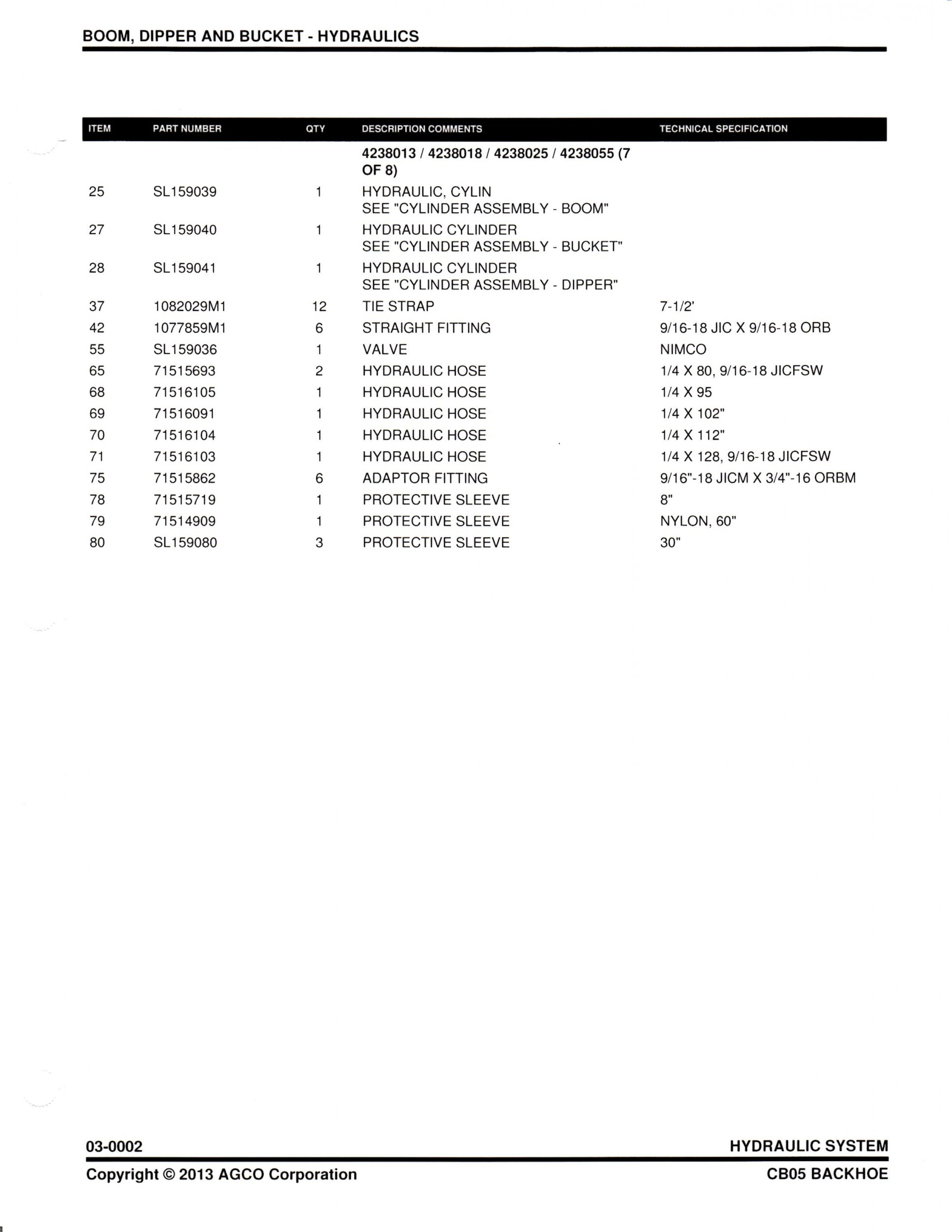

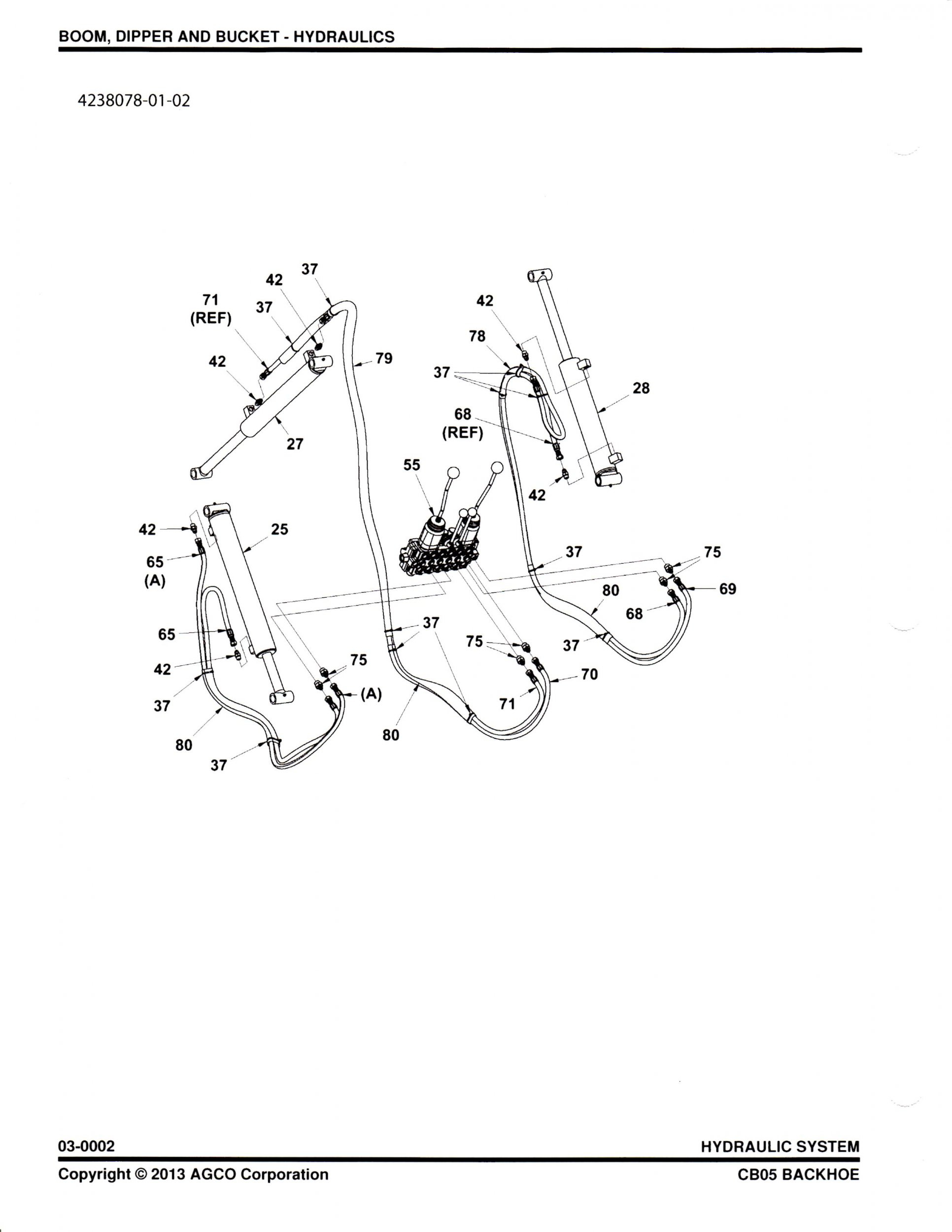

After my research regarding the 4 end connections, yesterday, I ordered 2 replacement hoses from DiscountHydraulicHose.com
I ordered 2- 1/4" SAE 100R16 Hydraulic Hoses, 80" long each.
All 4 ends are: Part # FJX-04-06W (1/4" Hose x 3/8" JIC 37 degree Female Swivel W Series).
I will give an update when I change out these hoses, and with luck I ordered them correctly.
Here's 2 pictures of the Dipper Hydraulic Cylinder's hose connection, and 2 pages of my CB05 Parts Catalog:
Maybe this information will help others ?

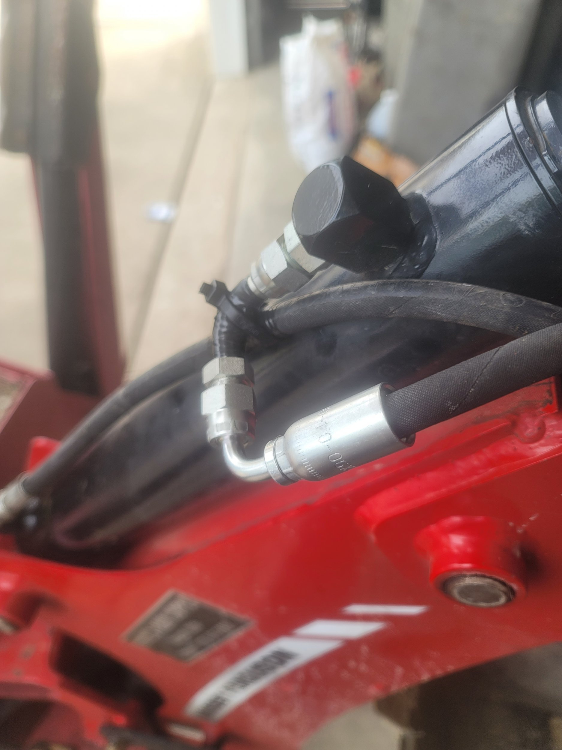

I had the same issue, I shortened the hose and added a JIC 37 90 and a hose 90
