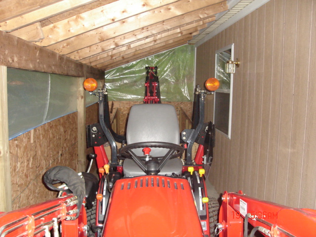

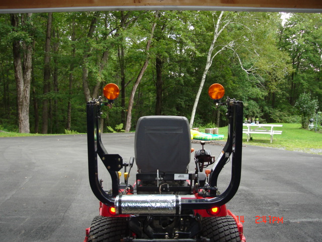

I also went through that on my 2310; the "mickey mouse" lights on that model had no guards at all. After banging, breaking and re-gluing the plastic lights three times, I priced replacements. Not as bad as yours, but they were expensive at $60 or so several years ago.
I ended up replacing them with far less expensive Kubota (NO!!!) lights, and then (after hitting those, too), finally did what I should have done in the first place: moved them to the INSIDE of the ROPS.:thumbsup:
No problems since. It's just darned unfortunate that the OEM lights are the widest point on the tractor, and it seemed I was always looking down for clearance when close to things instead of up at the lights.:(
I can sort of understand the position outside, where they won't interfere with operation of the BH when the seat's spun around, but I've found I don't have any problem with the lights on the inside. And it doesn't really show, but the Kubota lights are a bit smaller in diameter and a bit thinner, too-- but just as bright.
Here are before & after pics (oops, after & before):
