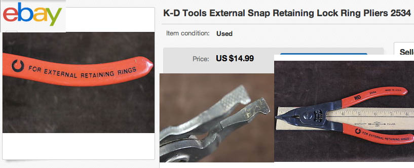

You will need a snap ring spreader to get those bearings off (without dulling all your sccrewdrivers and cussing a blue streak).
Note there is a 3/8" threaded hole at wobble-shaft-center at the forward end. Screw a long, all-threaded bolt in, to push the crankshaft out towards the back. I'd spray everything down with liquid wrench a few days before working on it. My MF 31 disassembled OK (after Mr. L. Wrench) and went back together nicely too.
