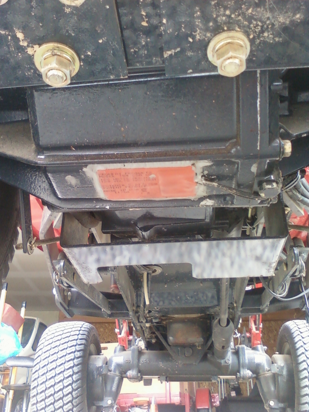

I use a silicone pad heater on the transmission. They are not expensive, and easy to install. Amazon.com: Proheat Heavy Duty Fluid Reservoir Heater Model 154-22 (125 Watts, .5 Amp, 22 Volts) Ideal for Oil Pans up to 1 Gallon of Lube (3.5 Litres) and up to 1 Gallons of Hydraulic Oil: Automotive
It is a small heater. So, it is not an issue leaving it plugged in for long periods of time. It is unable to "heat" that much oil. But, it does keep it from getting cold soaked.
