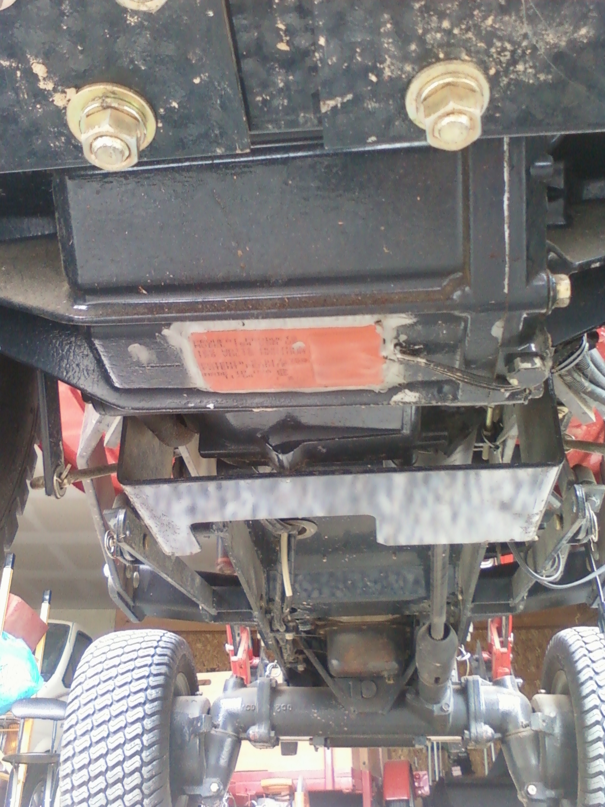

I have a 140 watt glue on, silicone pad heater on the rear axle. ($30)
It keeps the fluid from getting cold.
