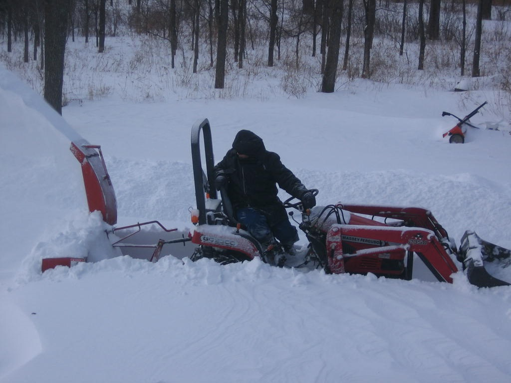

This would be to do several driveways in one area. The machine will have a heated cab. Can this sized tractor and blower handle northeast snowfalls? Any other thoughts on the machine in general?

I haven't lived in the northeast, so I don't really know how much snow you might be talking about. I've heard of places like Buffalo, NY getting feet of snow in one storm. I generally figure on 1hp per 2 inches of snowblower width for up to 12" of wet heavy snow working out pretty well going slow. Is this a front mount blower or on the rear?
   / Massey GC1725M - will a snow blower be productive with this? #3
I live in the North East. We typically get wet heavy snow..Which is less than favorable for snow blowers. I have a Cat 246 standard flow skid steer...I tried a blower on it in 6-7" of snow..It sucked. I had to go so slow for it not to clog that I think I could have shoveled it faster.

What kind of blower are you talking about? Front or rear PTO?
I cannot comment on the front blower they make for these.
I have a rear facing Woods SB54S on mine.
I live in the NE. I would consider last year an "average" year. Plenty of snow and wind. We get 2+ feet of snow at a time and the wind can make 6+ foot drifts. The blower chewed through any snow I put it to last year. Although there were a couple of times I needed to pull down the drifts with my bucket so that I could blow the snow away. It will easily go through up to 3+ feet of snow.
I would say yes, this tractor is very capable of handling NE snow, yes, you will need to slow down when it is heavy or deep.
   / Massey GC1725M - will a snow blower be productive with this? #5
48" rear blower, drifts over 40" no problem, HST allows you to match speed to conditions.
Heated cab would be wonderful, but spend the extra and get a front blower. By the time auxiliary controls are added to a rear blower, the cost becomes a lot closer.
