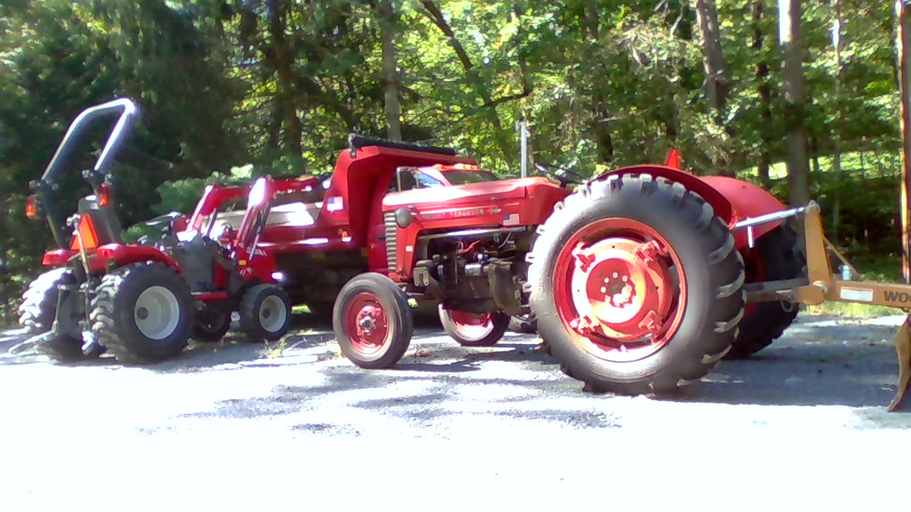

Hi all, I bought this MF50 Z134 a couple years back because it had a loader and it was (I thought) a good price but non running condition. The guy said the starter went bad and while replacing it he dropped a nut into the flywheel, then he got sick and it's just sat since. When I drained the oil about a quart+ of water came out with the oil and I went into panic mode. I dropped the oil pan and it looks like the water has been in there some time as there's rust on the rod bolts. I knocked a couple pieces of scale rust off that looked loose and then coated a rag with oil and wiped it across the rust to see how much came off, not a whole lot but some. I sealed the pan back up and filled it with oil, then put some large magnets on the bottom of the pan, away from the sump, but curious if this engine is even worth starting? The tach shows 2300 hours but we know how that goes. Any insight is appreciated.
