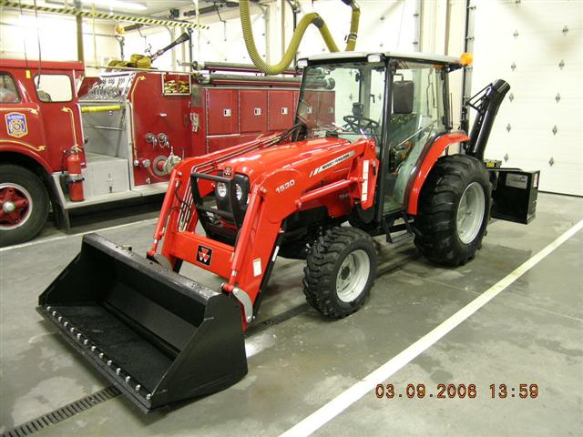

Fredartic, what your dealer means is you need hydraulic remotes on the rear of your tractor to operate the chute turning cylinder, and possibly a second set for a cylinder for the deflector. You can kinda see the deflector set up on my blower in the attached pic.
