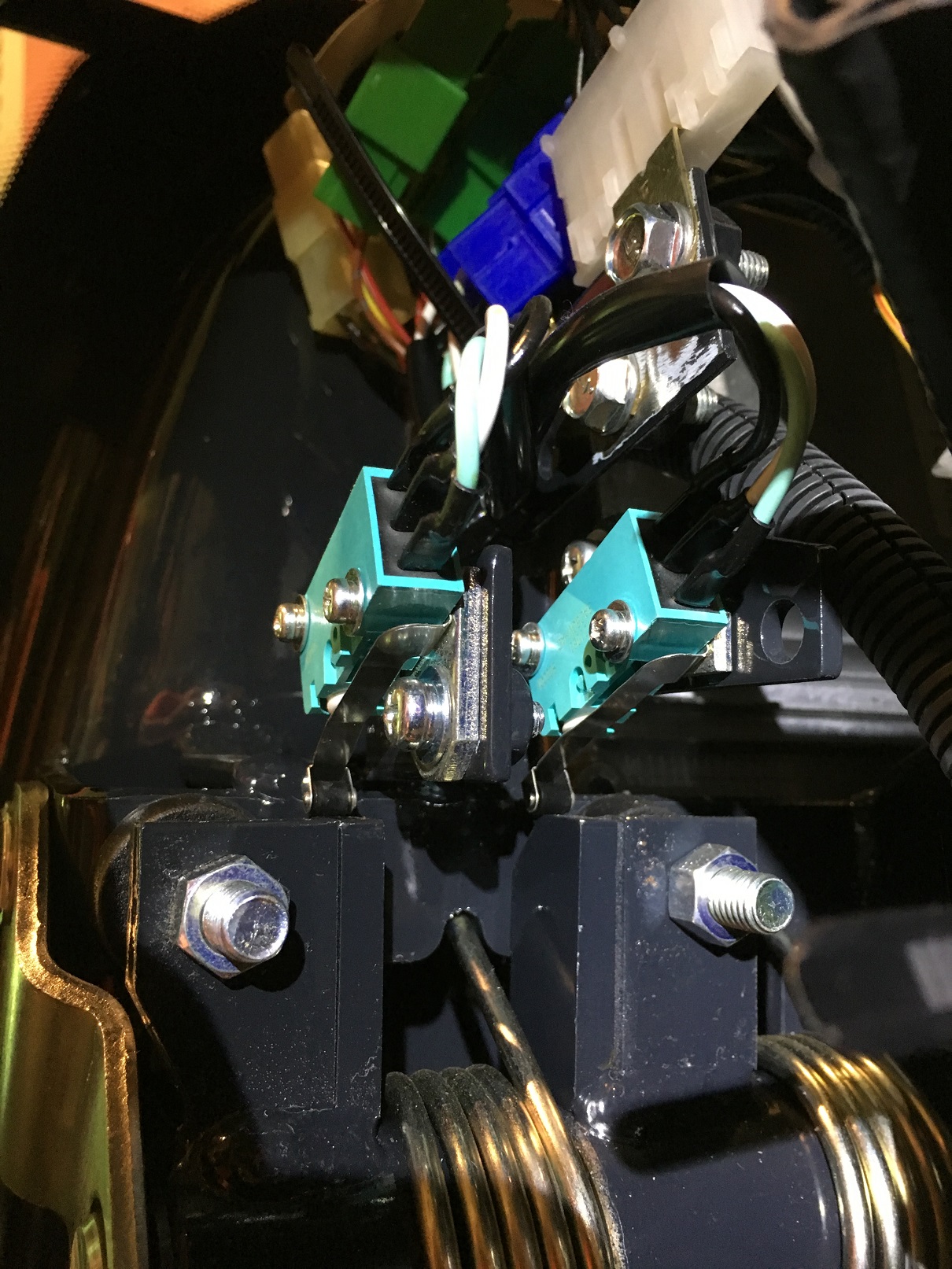

That's precisely what I did yesterday. The greatest incline on the dealer lot was ~5% though and I couldn't create more than about an inch of travel.
I drove the power shuttle too which was surprisingly nice. Still want the HST though.
I'm glad you were able to test drive one, I'm only guessing but I would say the incline where I experienced the drift was 10-15%. When I get some time I'm going to look at the switch a little more.

Yea, depending on the type of switch, I was thinking a momentary switch would be a good bypass. I wouldn't want to use a latching switch in fear of forgetting to revert to normal operation. A spring loaded momentary though would work well I think.
Foot on brake --> Hold down momentary switch defeating brake switch ---> release brake --> apply HST pedal and begin moving --> release momentary switch --> normal operation.
I was thinking the same exact method to temporarily defeat the seat switch for situations where you wanted to stand up just for a second or two.

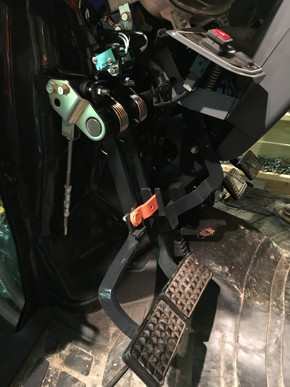

I spent a little more time looking at the brake pedals on my Massey 1736 yesterday. In the pictures you can see the light blue colored switches which when open disables the hydro from engaging.
Interestingly enough, I had never used only one brake pedal as you would if you wanted to steer the tractor by braking either the left or right rear wheel while still moving forward, thus my problem was solved.
By splitting the brake pedals, lifting the orange brace which interlocks both pedals and applying only one brake (either left or right) the hydro is allowed to be engaged while the pedal is applied.

Third, and while I am guessing this not as much a pedal issue, but more in the design of the hydrostatic system. On my New Holland I can be on a hill facing down and take my foot off the brake and creep backwards at the slowest of speeds without ever moving forward. With my Massey, as soon as you remove your foot from the brake the tractor begins to roll forward down the hill. I've tried pushing down on the reverse pedal before I let my foot off the brake but there must be an interlock which does not allow the transmission to engage if the brake is on. While the delay is only a second or 2, you can roll forward almost half a foot before the reverse kicks in, which is not a comfortable feeling.
side by side hydro pedals on my massey, no issues. you must have had it in high range. rocker pedal on my husqvarna riding mower, the exact issue you noted.
