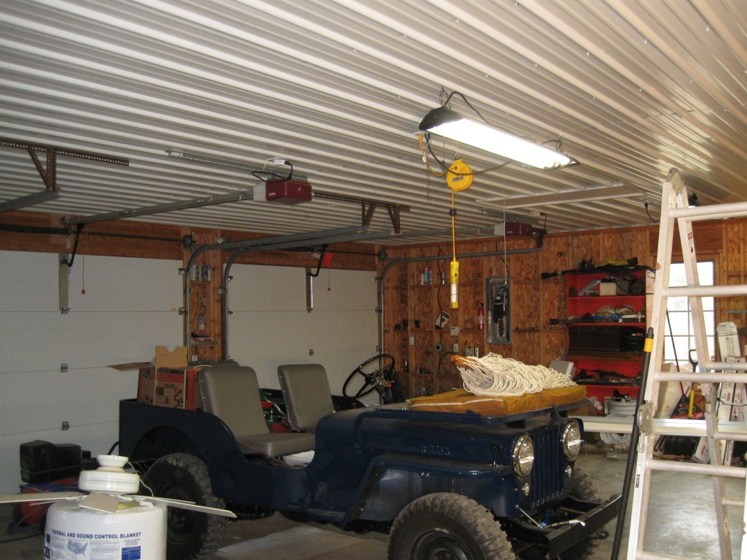

Purchased a furnance for my unfinished garage. Before I install it, I want to close the ceiling. The contractor doing some remodeling work on the house right now says he will enclose the ceiling with either 1/2" OSB or white metal panels. The panels will be $700 more, but he likes them because there is no painting and do a good job reflecting light.
Anyone use white ribbed panels? Good or bad experiences?

We use white steel for ceilings all the time and prefer it over OSB.

I have white barn metal on the ceiling in my shop and foil board in the lower bays. The shop ceiling has been in for over 20 years. I would do it again. The lower bays have 15' ceilings so the foil works good there. I wash cars in the shop and handle steel that hits the ceiling some times. A few small scratches but I am totally pleased with it.

Thanks for your note. I need to make my decision today and was still debating the extra expense. I was concern about how it would hold up long term. Based on your experience and other comments here I think I'll commit to the extra bucks.

I've had white metal ceilings in my woodworking shop building for 10 years now. Works really well and very easy to put up (provided you have at least a couple of people to help hold it in place while screwing it in place). I had insulation blown in on top of it and I have been very pleased - the insulation works great for heating/cooling, and dampens sound reflection off of the metal as well.
