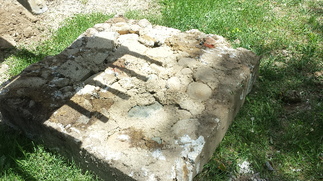

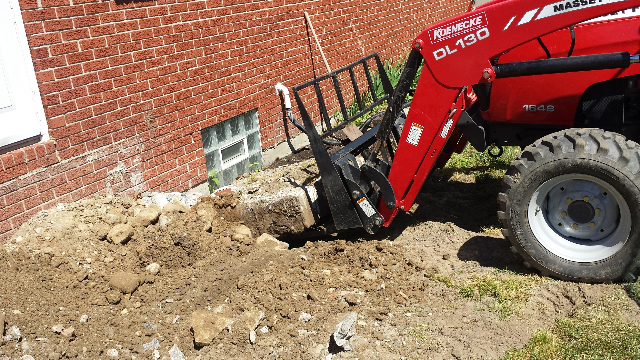

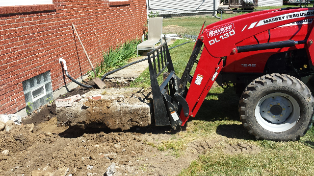

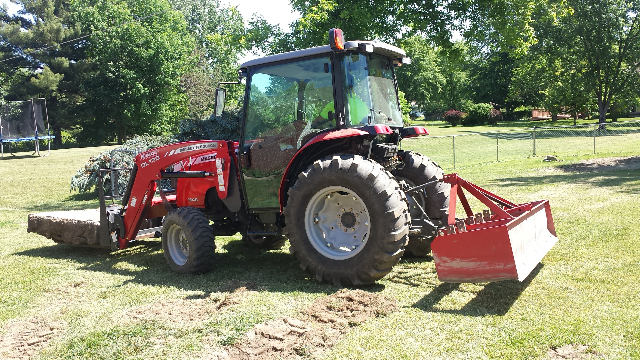

Lifted this the other day, tearing out an old porch for someone. Really interesting to see a 4'x4' slab at 10" thickness! The concrete weight formula works out to be right around 2000 lbs, and I was just ..... barely .... able ..... to lift it. This loader is funny though; if you can get it up the first 2", it'll pretty much go all the way up, easier than the first 2"!
When I flipped the slab over, I discovered that it wasn't just solid concrete ... it had large stones cemented in the mix! Anyone know if this would make the slab any heavier or lighter?

Geometry of cyl pins & loader arm pivots suggests max lift will be part way up. Keeping it there would seem to be easy enuf. Got anything to help with the first few inches?
Tip it onto logs/fence-posts & roll it? That's what we do with big sheds. Can you tuck in skids & drag it?

You say it just barley lifted that 2000# slab, but "barley" I'd hard to quantify.
Have you considered putting a pressure gauge on a tee in your lift hose/circuit? That's the easiest way to figure these things out. You can see what your max pressure is, and then when you lift things like that slab, you can see how close to max you really were. And then further break it down to percentages and figure what you can actually lift.

Does the boiler have to be lifted. Can it be placed by skidding. Boiler well strapped to loader, use curl function and back up.
