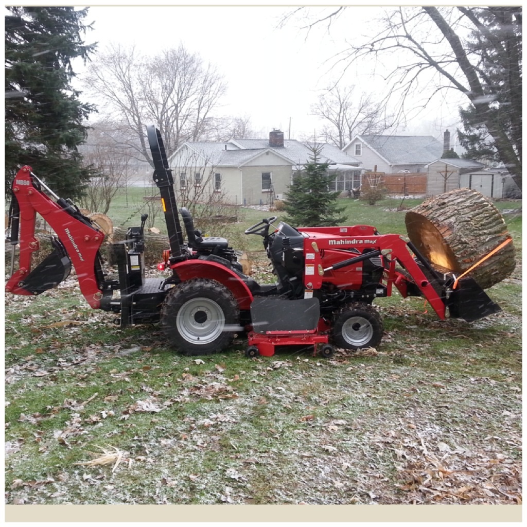

Items 1 and 4 are removed drawbar can stay as it needs to hold up deck pin A is removed turnbuckle flops around to end of 3point lift arm. They attach to bottom of bhoe
Look at attached pic down lo just at end o 3point arms it is pinned to backhoe

That's a big ol hunk o wood on the front of that rig. Nicely done!

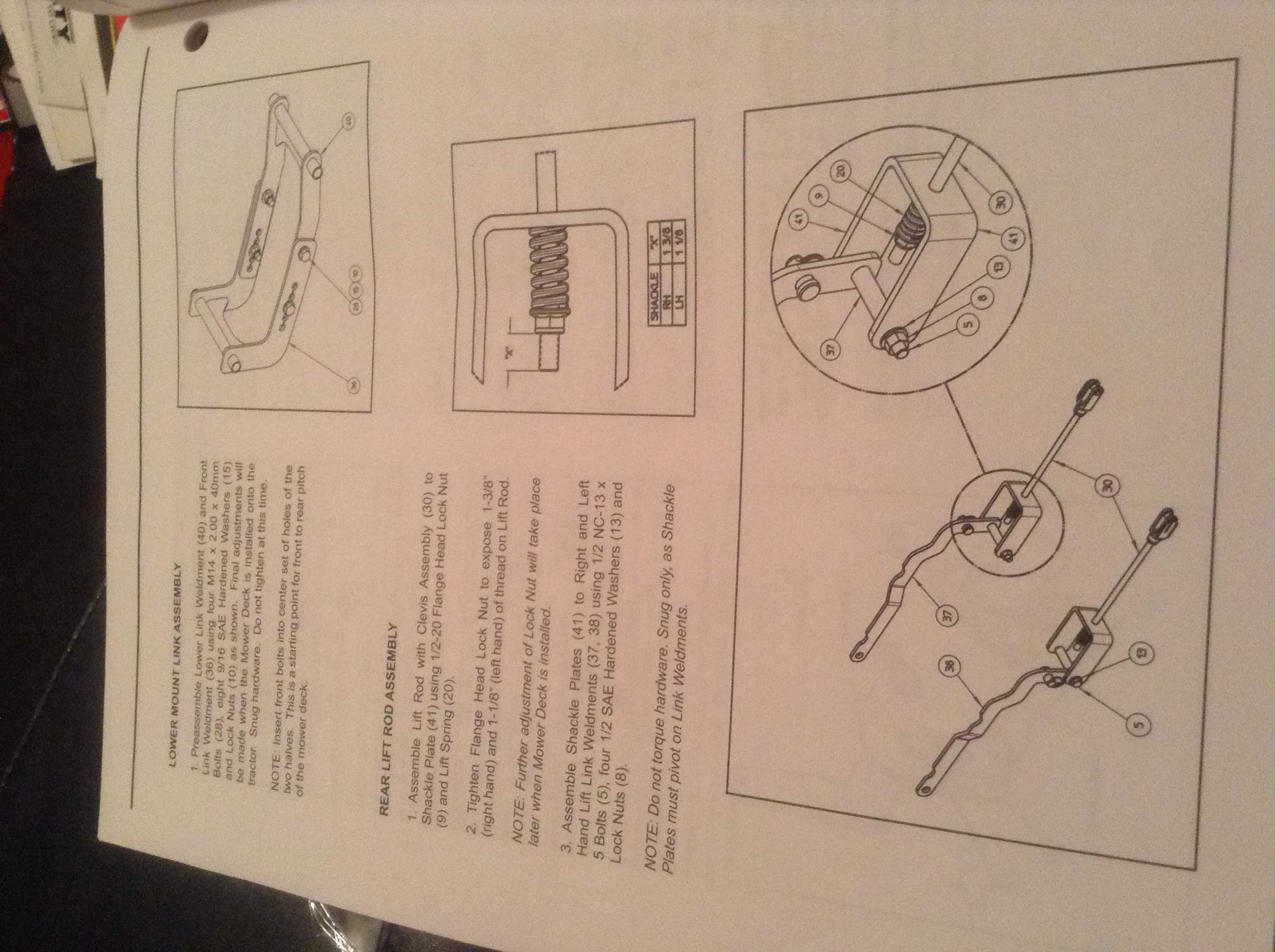

image.jpgimage.jpgimage.jpg. Might need to have adjustment done. Attached pics from manuals to help

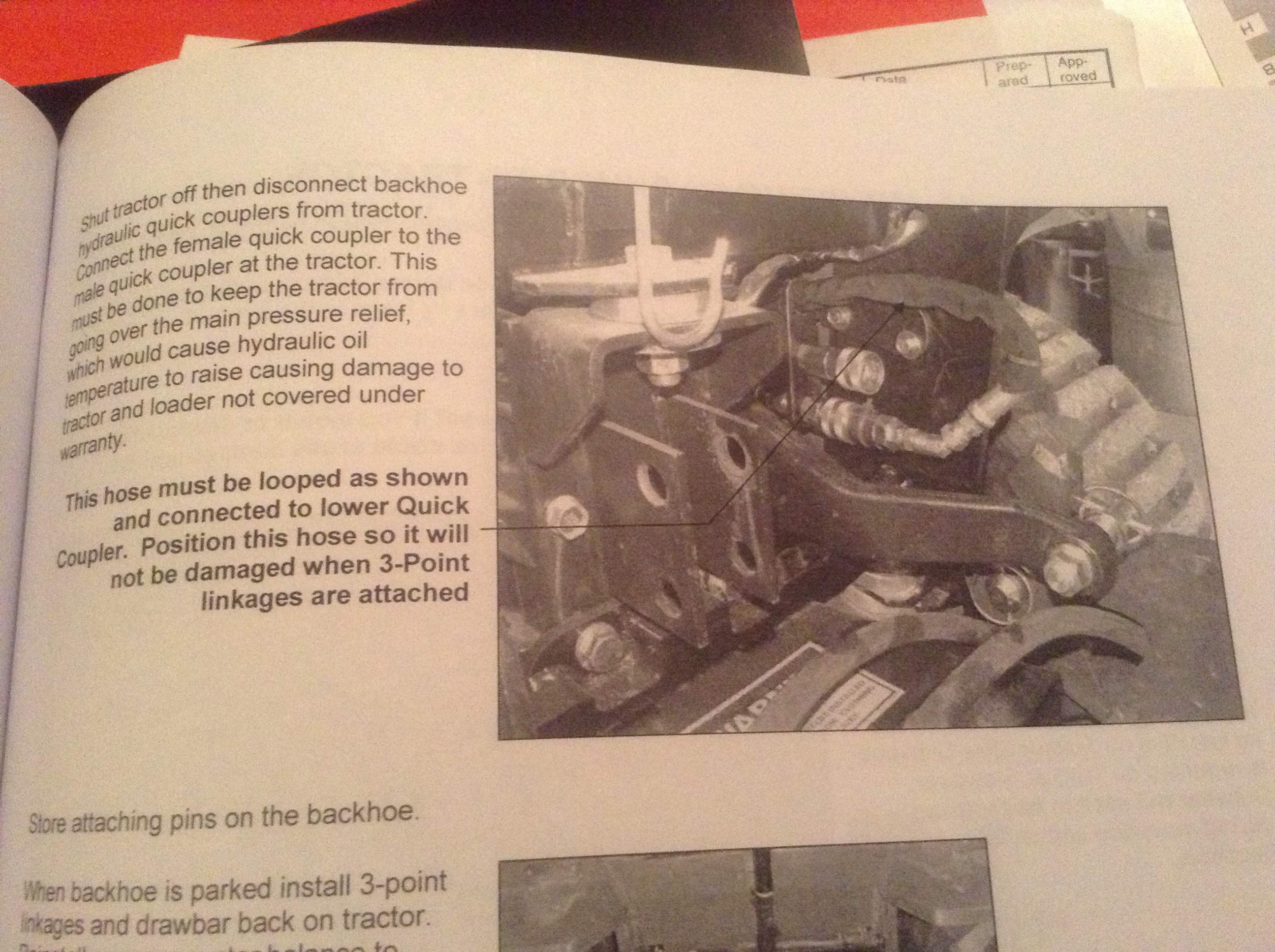

If you have the BH mounted, did you take off the hydraulic links and put it back into the bypass mode?
   / Max 25/28 MMM with backhoe subrame? #28

View attachment 372035View attachment 372035View attachment 372035. Might need to have adjustment done. Attached pics from manuals to help
Nope. As I mentioned, I can raise it fully by adjusting the nuts on the rods, but that does nothing for the height pin bracket at the rear.
Yes, I already have the stop bolt at the lever backed off completely
Rob- I appreciate the pages, but I have all my ops manuals and I have been through them pretty thoroughly and I am confident I'm not overlooking a setup or adjustment there.
I did however answer my last question by reading closer that the multiple hole locations are for adjusting the ANGLE of the deck.
I do not have the BH mounted and yes the loopback hose is connected.
