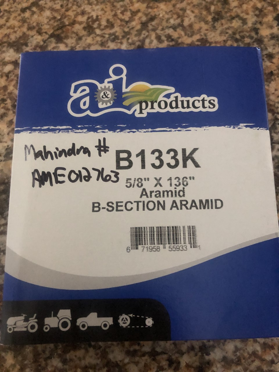

My belt broke and I made the mistake of ordering the AME 012763 belt from 4mymahindra.com The belt was over $200. When it arrived I found the belt was not an original Mahindra belt but one produced by A&I product part # B133k. I am fine with the A&I belt its the up charge that 4mymahindra.com made. If you order the belt straight from A&I it only cost $49.88 plus shipping vs $200.
B133K Aramid Blue V-Belt (5/8" X 136" ) | AllPartsStore
