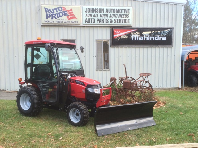

Yes, Mahindra sells a front mount plow for your Max 28, ( same as the Max 26) you remove the loader and has a full frame that goes under the tractor and attaches by 2 pins, one in the front and one in the rear draw bar mount.
We have sold several and had no problems or complaints.
I would check with your local dealer for pricing and availibilty.

Here are a few pics of one mounted on a Max 26 cab tractor.

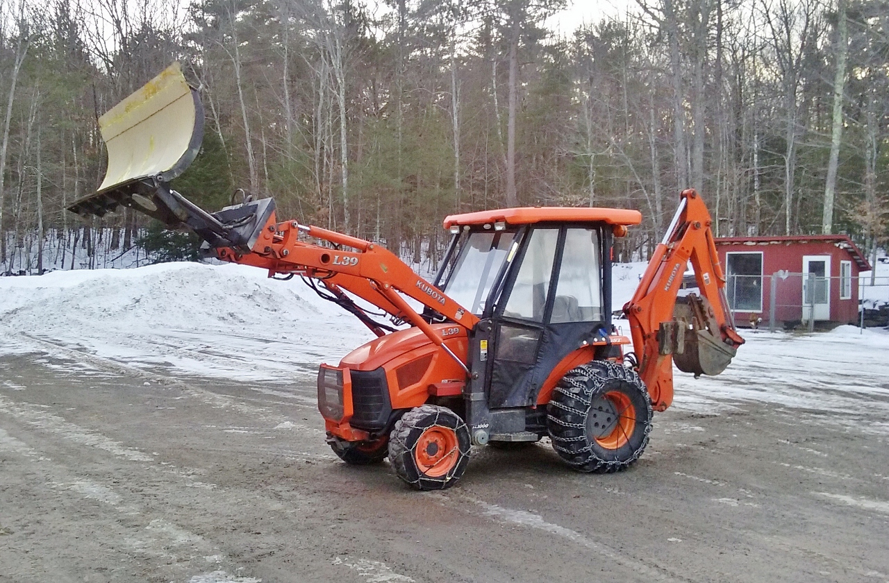

I'd go on Ebay, Craig's list , etc for a 5' rear snowblower and forget the plow unless you only have a small area. If you want to spend some money a front mount blower is sweet. If you go with a plow, get front and rear chains. Max is a bit small for a plow.
