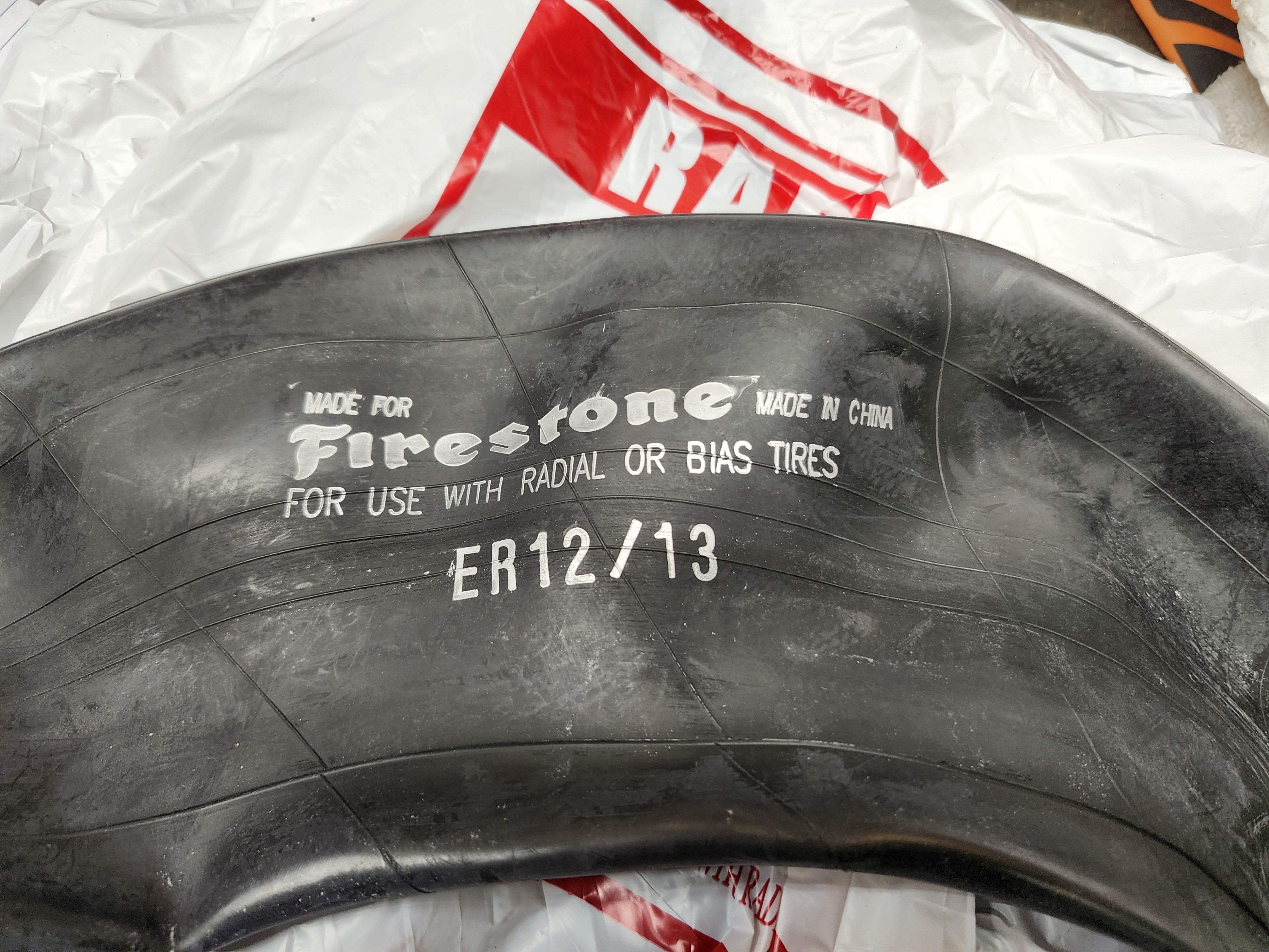

Recently I had to buy some inner tubes for ancient trailer wheels that were all rusted and was amazed that I couldn't find any made here in the USA that would not quickly disintegrate. EVERY one I looked at on line said "Made in China" and most were brands I had never heard of. Finally came across some Firestone tubes that were supposedly made in USA. This is what I found when I pulled one out of the package:

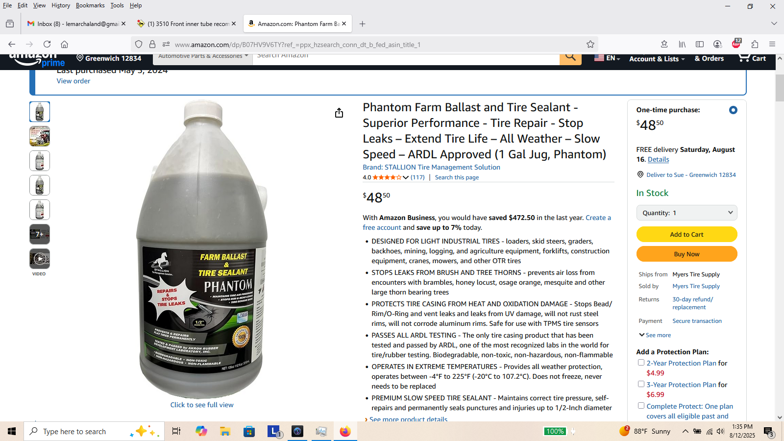

As far as stop leaks I have been pleased with the performance of this brand;

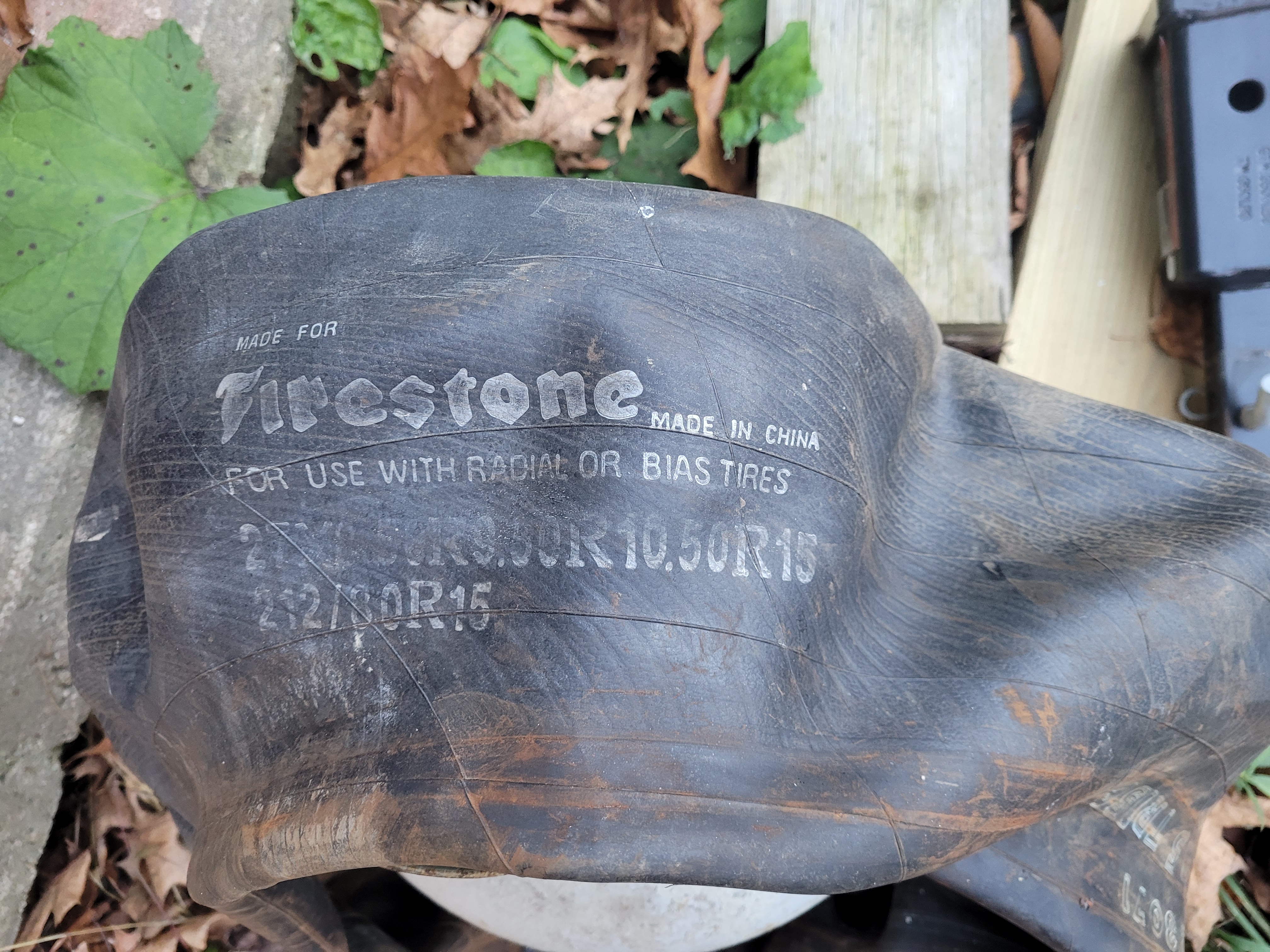

I found a pic I took of the tube I took out of it. It had been in the tires for about 10 years or more. One was even patched once and put back in.
I ordered two replacements to be here by the end of the week. My tire guy couldn't get them right now, so Amz* to the rescue!
Wow! If the ones I just installed last at least 10 years I'll be a happy man!

The stuff you linked is preventative to stop punctures, right? How many are needed for the tire tubes?

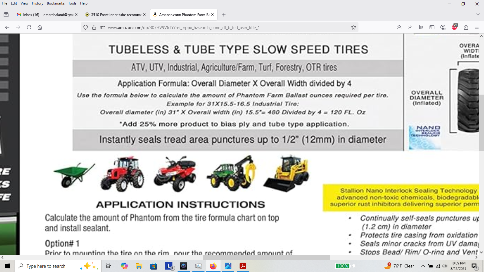

Translation: "How much of the stuff do you put in a tube?"
So 28x8.50-15 would be 28 x 8.50 = 238 / 4 = 59.5 or about 60 oz.
