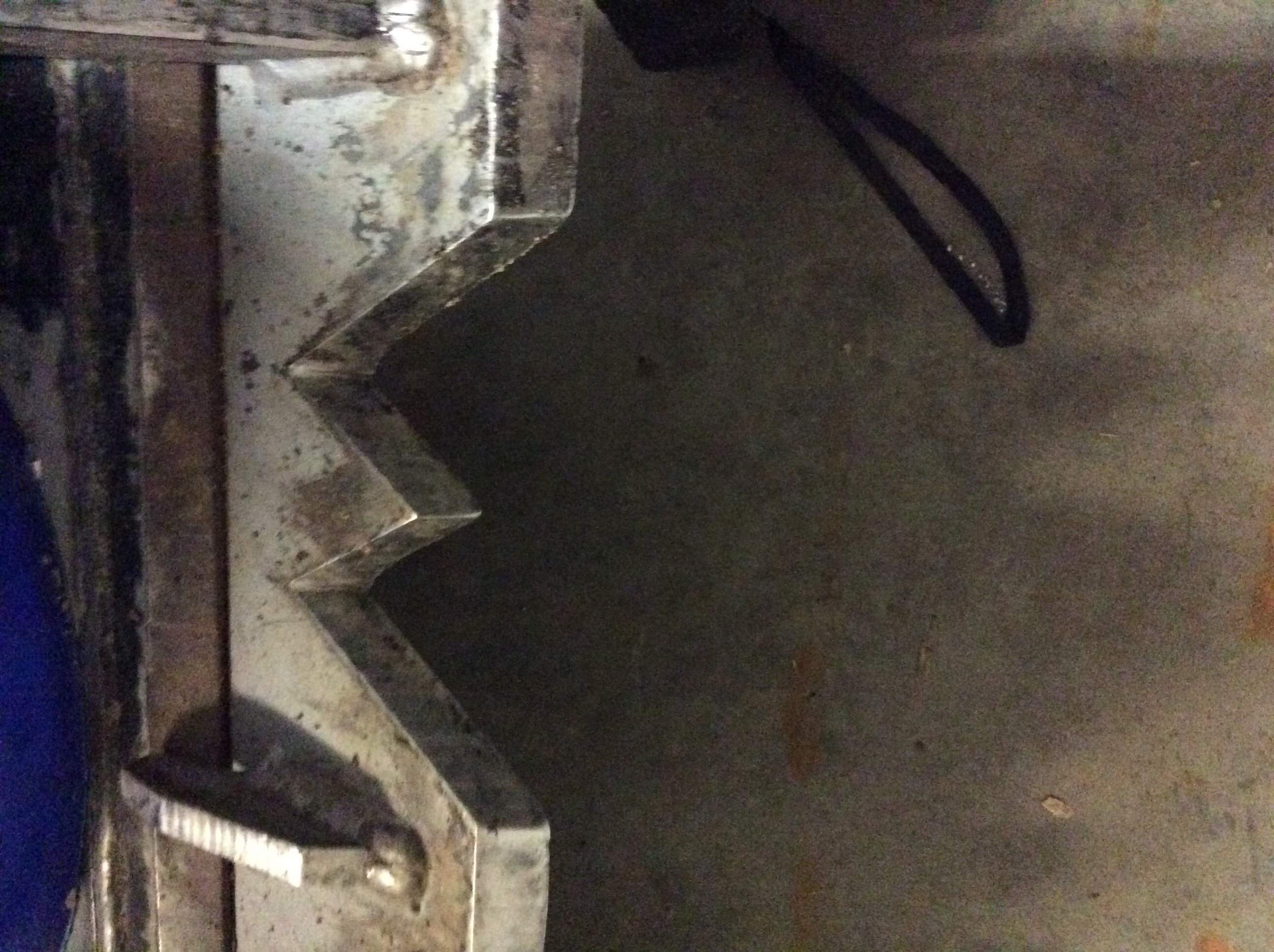

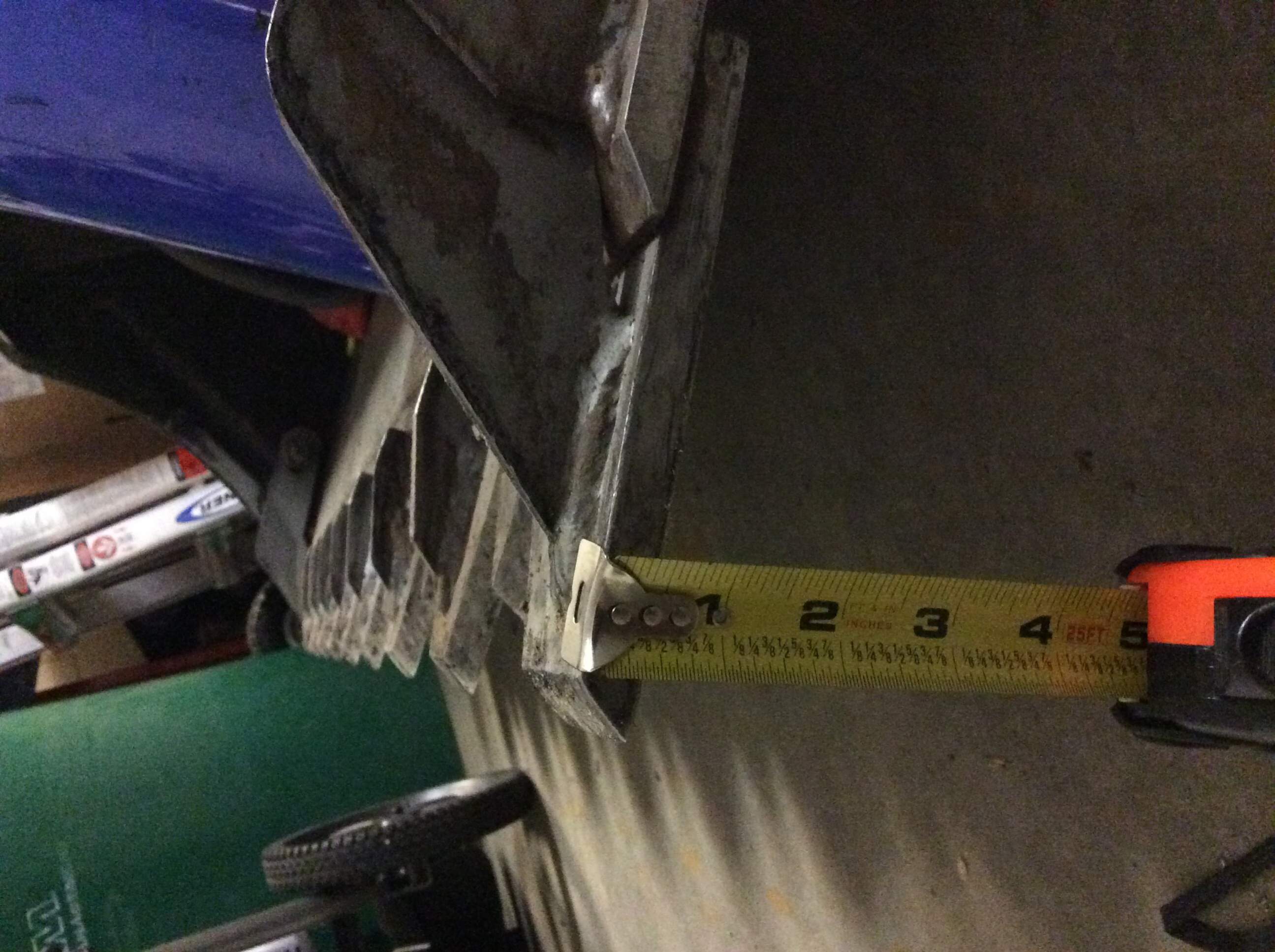

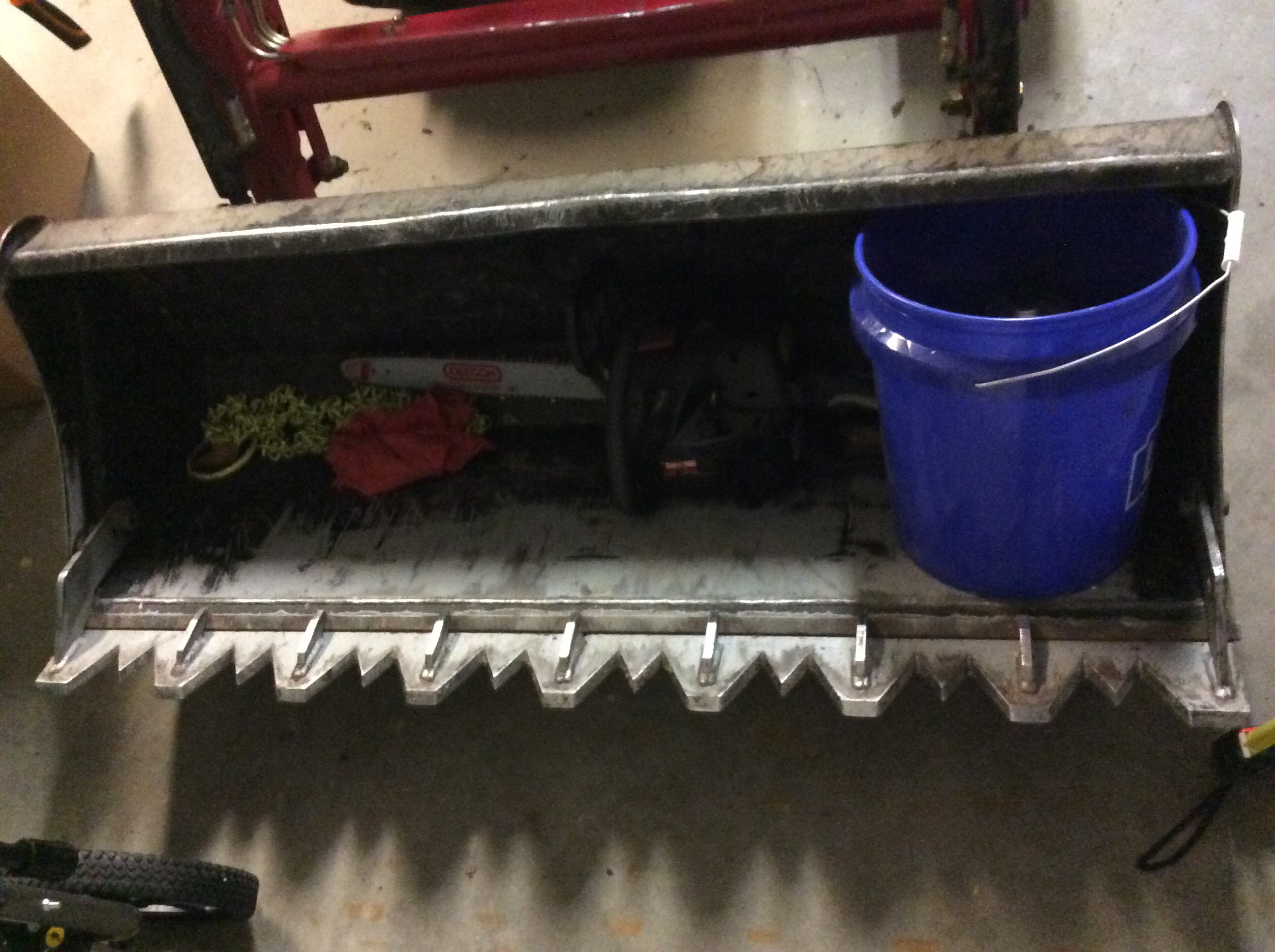

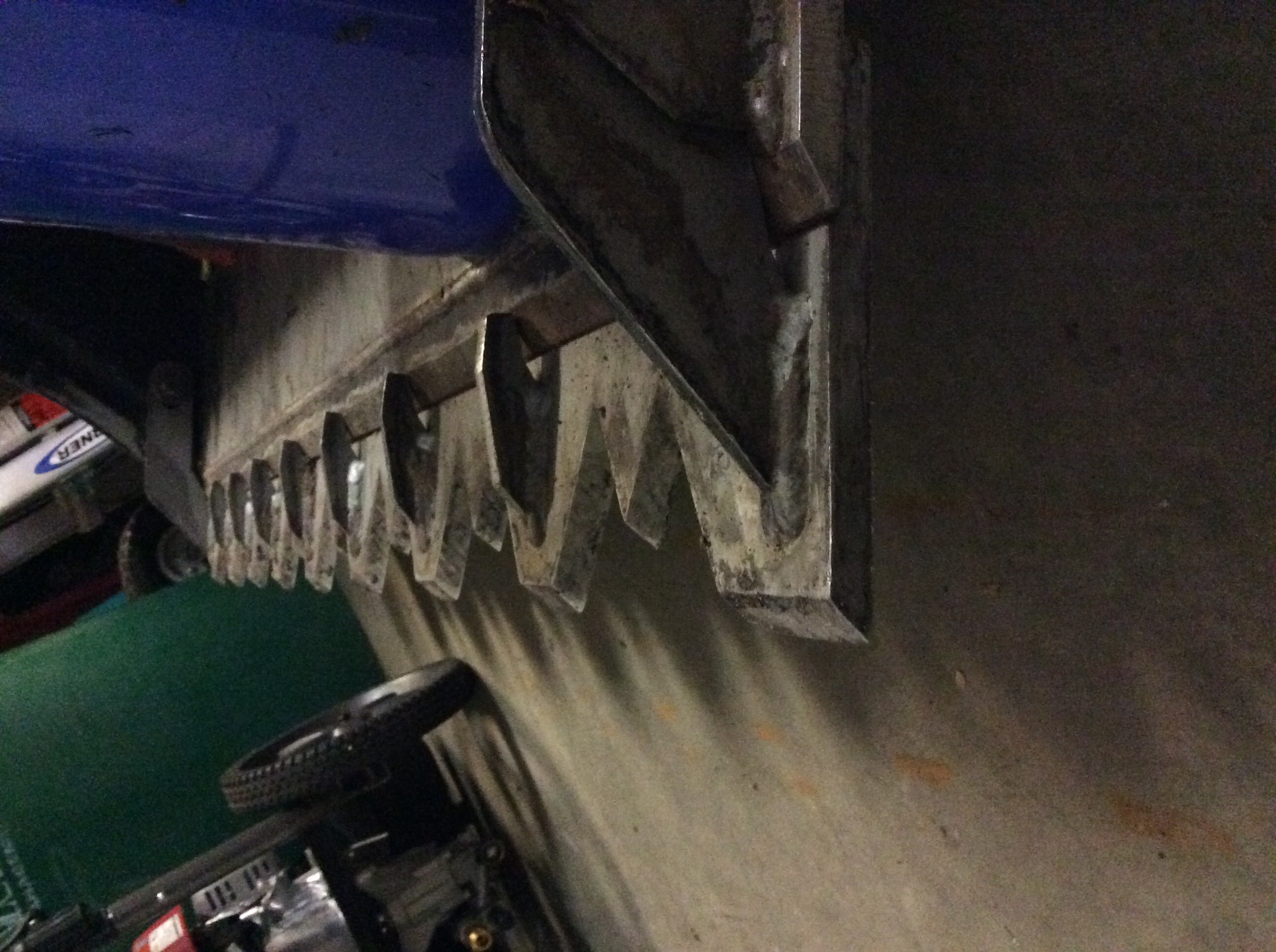

Custom length but same cost. Measure per their instructions as the max28 had 2 different size buckets during production. Mine measures inside 52". Cutting edge has a significant bevel. I think 45deg. Here are some pictures. image.jpgimage.jpgimage.jpgimage.jpg
   / max 28 tooth bar #9
Custom length but same cost. Measure per their instructions as the max28 had 2 different size buckets during production. Mine measures inside 52". Cutting edge has a significant bevel. I think 45deg. Here are some pictures.View attachment 409932View attachment 409933View attachment 409934View attachment 409935
Thanks for the Pictures.
Reasonable price and will ad a bit more capacity to the bucket. My bucket is just shy of 52-1/2" inside dims., so anyone who orders best measure exact,as the welders are not real fussy.
