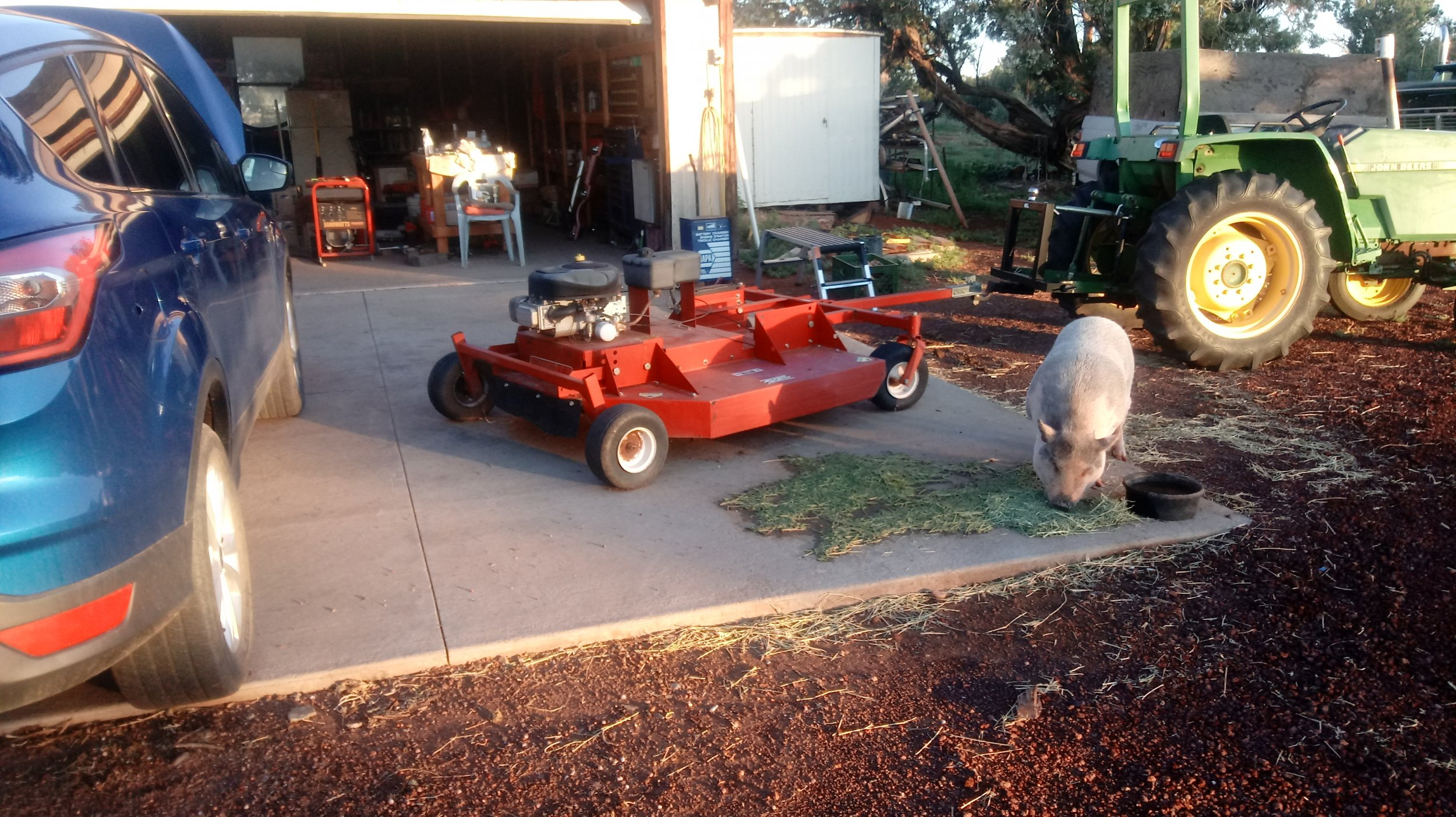

The 3033 is rated for a 72" mower, so power wise, it should be fine with a 72" brush cutter. If weight is an issue, leave it on the ground until you can lift it safely. My 52" pull type Swisher only has a 10 hp brigs, no power issues at all. If the tractor will fit over the brush the cutter will cut it.
