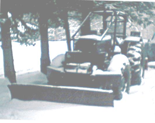

Max acquired his name because he looks like something out of the movie, Mad Max -- The Road Warrior. He was a right of way mower for a Mass. power co that I bought at auction. He is a Massey Ferguson 399, 100hp, 4wd. with the full skid pan, forestry package and 50 ton winch up front.
The first photo is from last winter with the 9ft plow mounted and blower on the back.

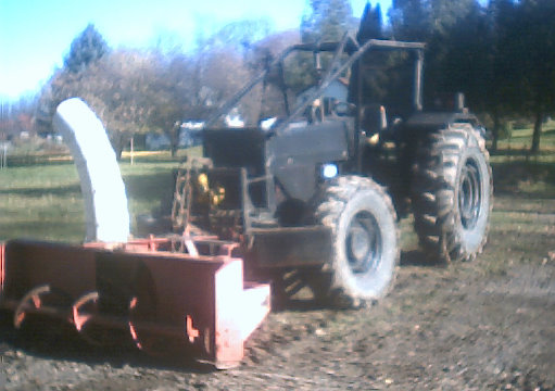

Second-- with the blower up front and a scraper blade will be in back.

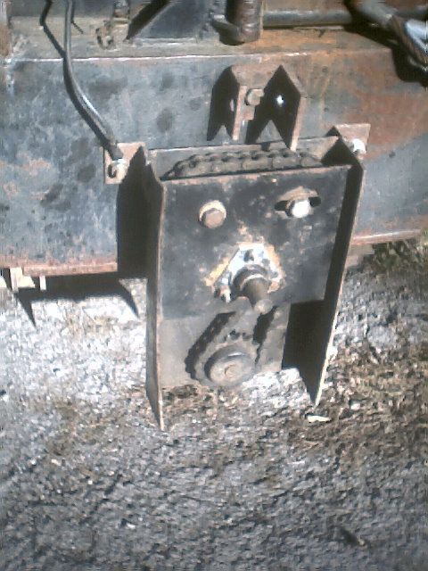

Third-- is the rear sprocket drive for the front PTO.

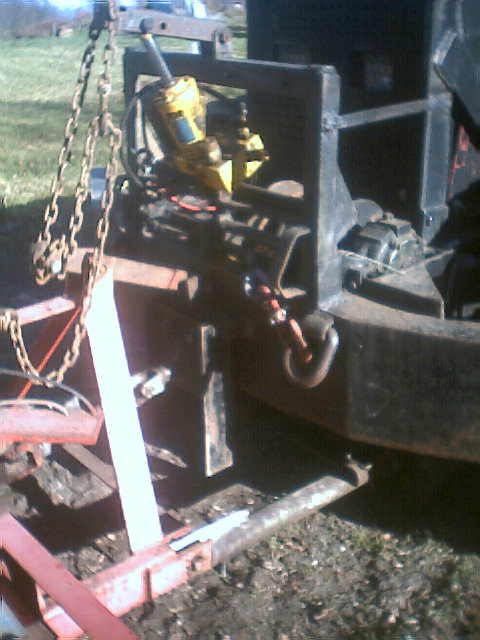

Fourth-- shows the front 3 PT hitch, PTO and electric/hyd snowplow lift. The winch is directly behind and under the lift frame that I could have used, but with the snowplow lift I also have angling capability when using the plow.

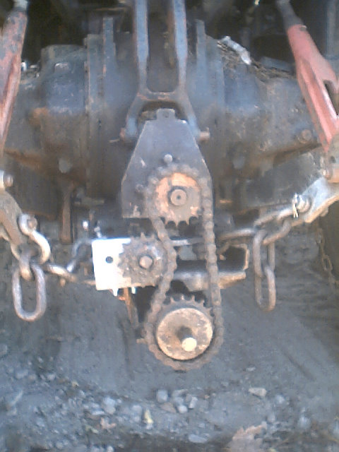

Last-- is the front mounted PTO reverser obtained from another member Piloon.
Thanks Piloon, it worked out great in front instead of the rear.
I have a little finish work do, A smaller driven sprocket and guard for the rear drive and a slightly longer PTO shaft for the front. Maybe next year, tidy it up and paint.

My driveway is 350 ft all uphill, in the foothills of the Adirondacks. It's designed (elevated) to pretty much blow clear, but sometimes when we get 3 ft with no wind, it becomes a problem.
I should have mentioned a closed cab is in the offing. I bought a Cub Cadet all steel cab for my Cub Lo Boy but it doesn't fit, so thought I'd widen it for Max. Unfortunately it will be more work to modify than to build new, so if time allows (before I go to Florida for the winter) It'll have a cab. Hopefully I won't even have to use it.

It is a beast. My concern would be whether the chain on your reverser will hold up to 100hp. It is hard to tell in the pic but only appears to be #60. In a big wet snow that may be the weak link.

I don't think that should be a problem as the chain from the factory on the blower is #60.
There will be either a slip clutch or shear pin in case of a jam.
