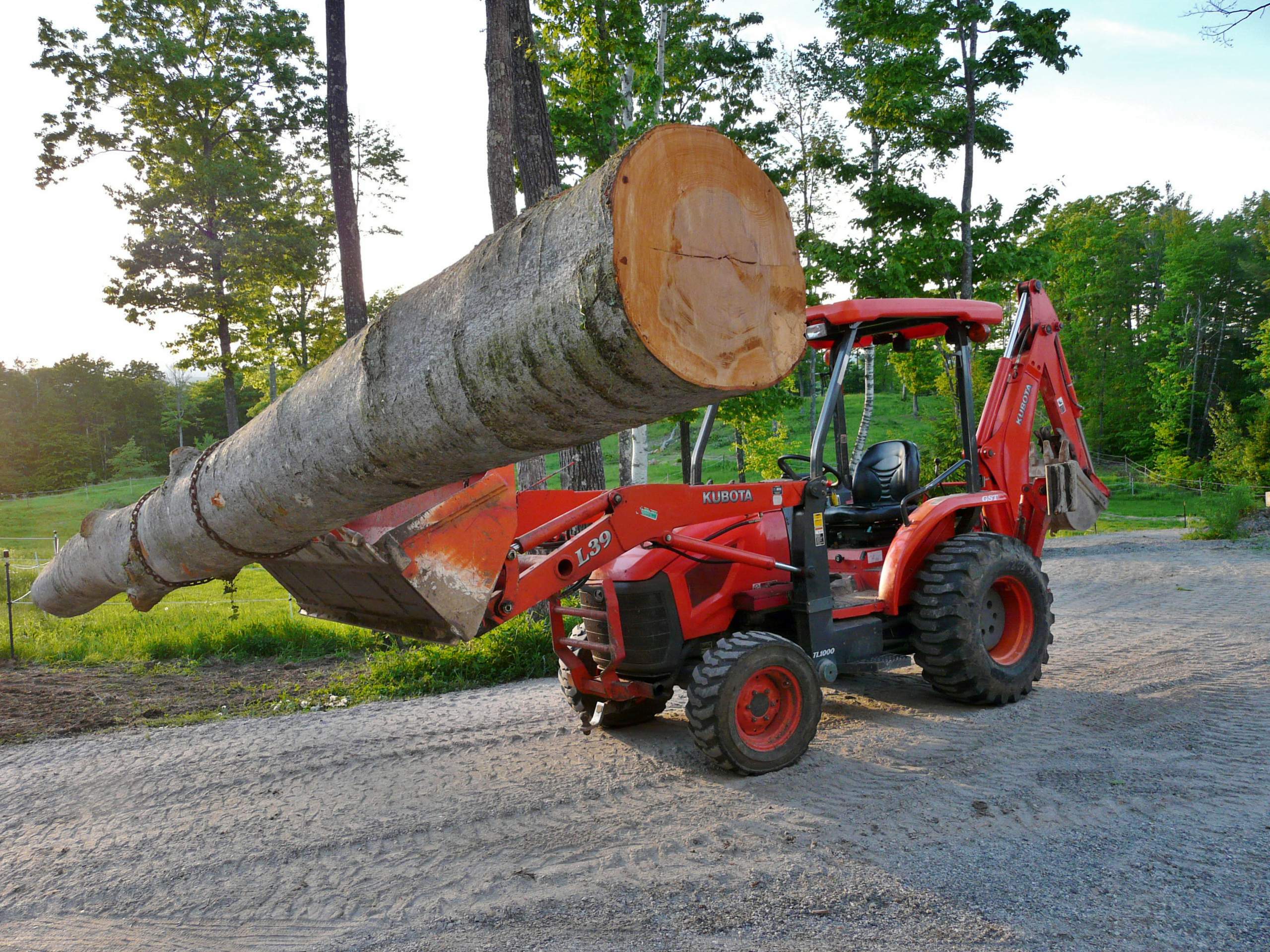

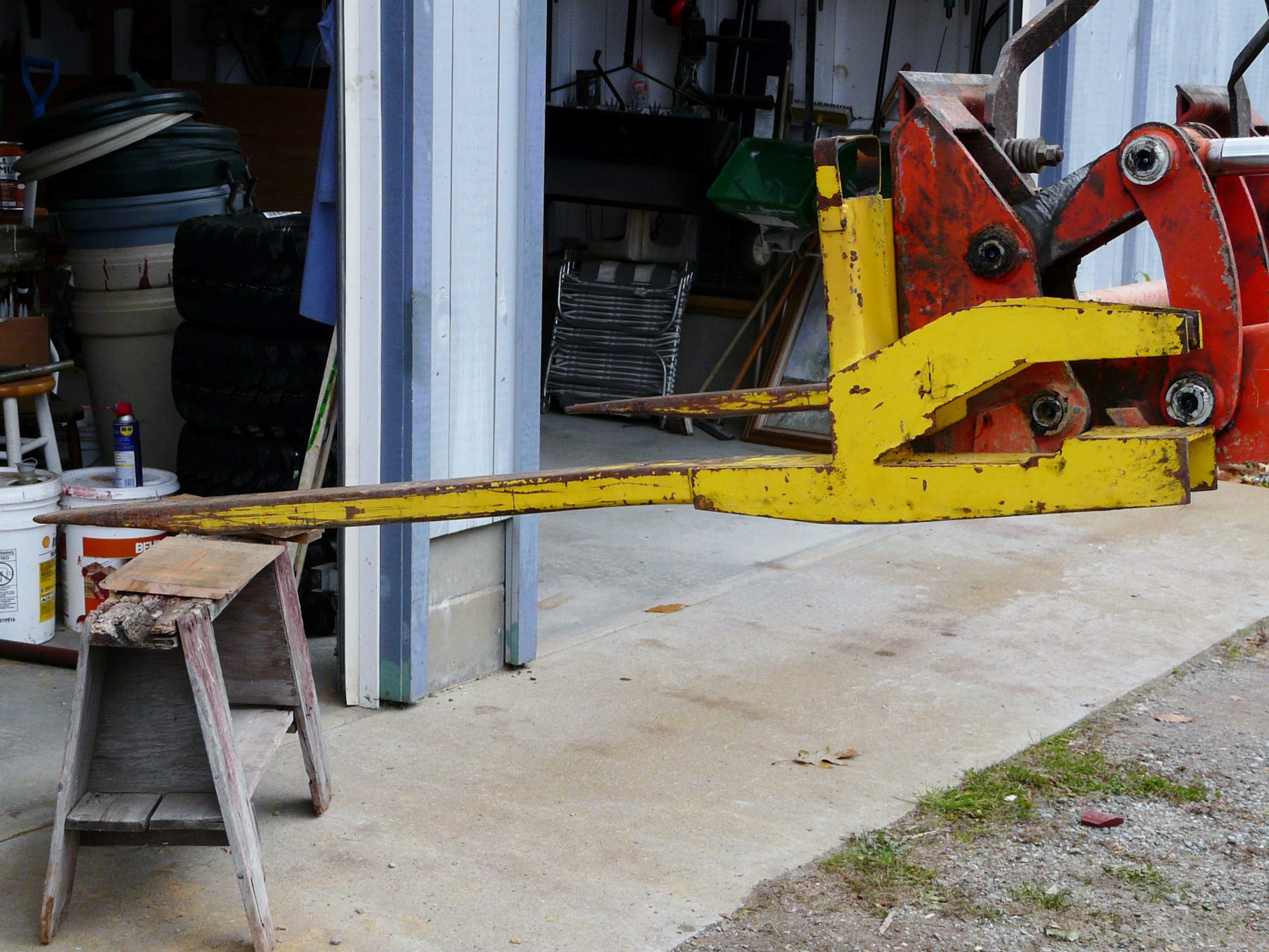

Pallet forks extreme
Seriously considering a Max28XL as our little tractor, Just hope pound for pound it is as strong as our L39.

You will ba giving up a lot of capacity going from an l39 to a max28. But since the max is smaller and much lighter, pound for pound is probably on par.
Also keep in mind that the backhoe is a significant counterweight. You will need something equally significant on any other machine you choose.

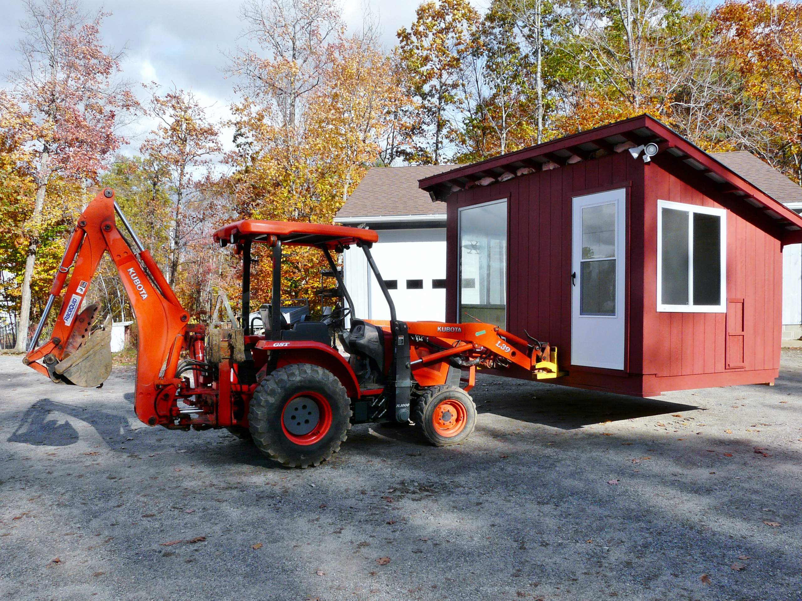

/ Max28 FEL Question #12
That is a great example.
Yes that shed i lifted was all TT 2 x 8 in the floor Base, with 3/4 PT Plywood floor plus 2 x 12 box section where the forks inserted. it got really heavy with the 4 ft sliding glass door panel, T-11 siding and the interior paneled with masonite. The CG was far out from the piviot pins & as per my photo. Even with inner and outer wheel weights, etc bringing the tractor weight up to 8,000 lbs, the back wheels are not pushing on the ground too much. If the 12'4" x 8'8" shed had an asphalt roof, I could not have moved it. Loader was just about maxed out. Thats why I'm amazed the Max28 is rated at 1400 lbs at the pins. I wonder how much it could lift at 500mm in front of the pins?
Even if that number was 1,000 lbs, that a lot for the little Max 28.
i wish all amfactures would rate the tractors
3 pt- 24" behind lift point.
Loader: Lift at bucket edge at ground point.
Loader break out force at bucket edge at ground point. i.e. curling force
Lift at pins at full lift Height.
