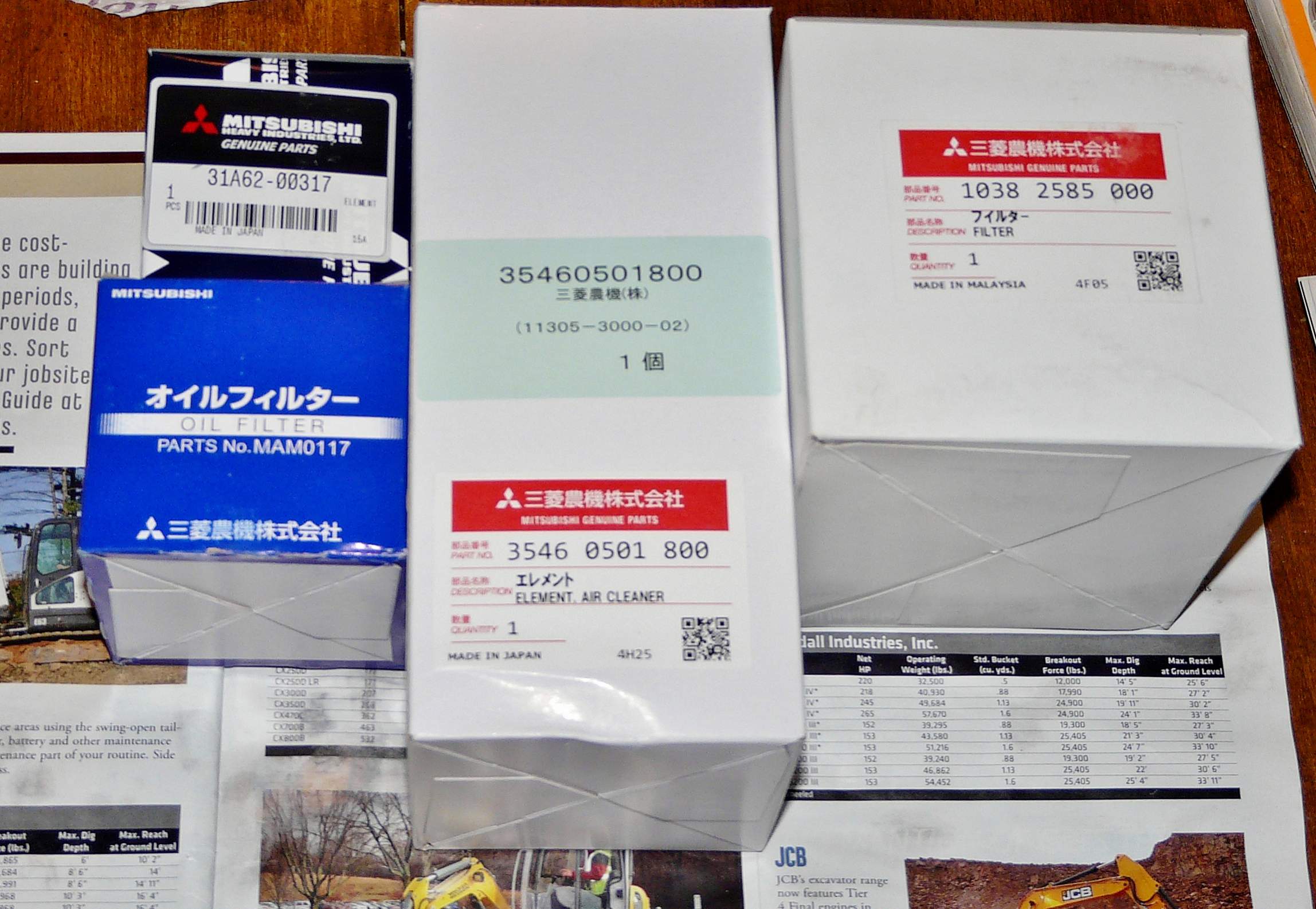

So today the filter I mail ordered show up a dayu after i do the first service!
Attached is a photo of the Filters
