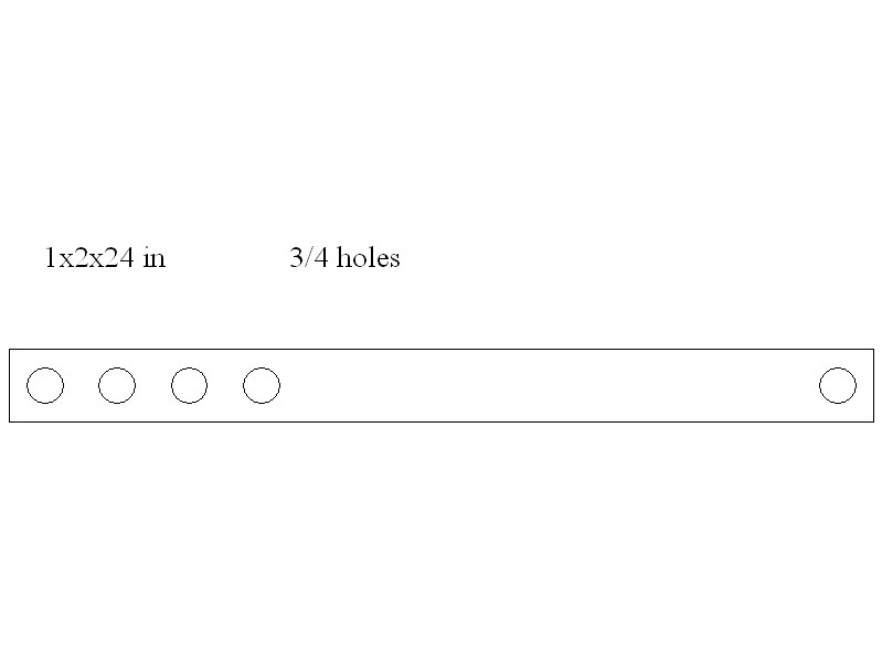

One other thing I noticed: when I tried to backdrag, the bucket snapped "overcenter". I'm thinking a longer tiltbar [the one I bent and straightened last fall] would prevent this; perhaps even make sense as it has plenty of tilt up, and atually could use a little more dump tilt.
Thanks! /forums/images/graemlins/smile.gif
   / Maximizing Weight #4
Look into an adjustable toplink from a 3pt hitch for your rod. That way, you can adjust it several inches either direction if needed.
   / Maximizing Weight #5
Something like this would give you more choices in your tilt applications.
The drawing is missing some lines, but you get the idea.

That makes perfect sense J_J
The simplicity of a toplink really intriqued me, but I'd be slightly concerned it wouldn't like the beating my tilt bar takes; however, I could build something like the drawing pretty easy. Actually if I could find the bar stock cheap enough, I could make it full width and never have to worry about it bending again [like last fall, not currently] either! /forums/images/graemlins/cool.gif
I'd say that's one question solved! /forums/images/graemlins/cool.gif

I have one similar that came with the 1445. I switch the hole as needed, plus I use the adjustable link for more offset.
