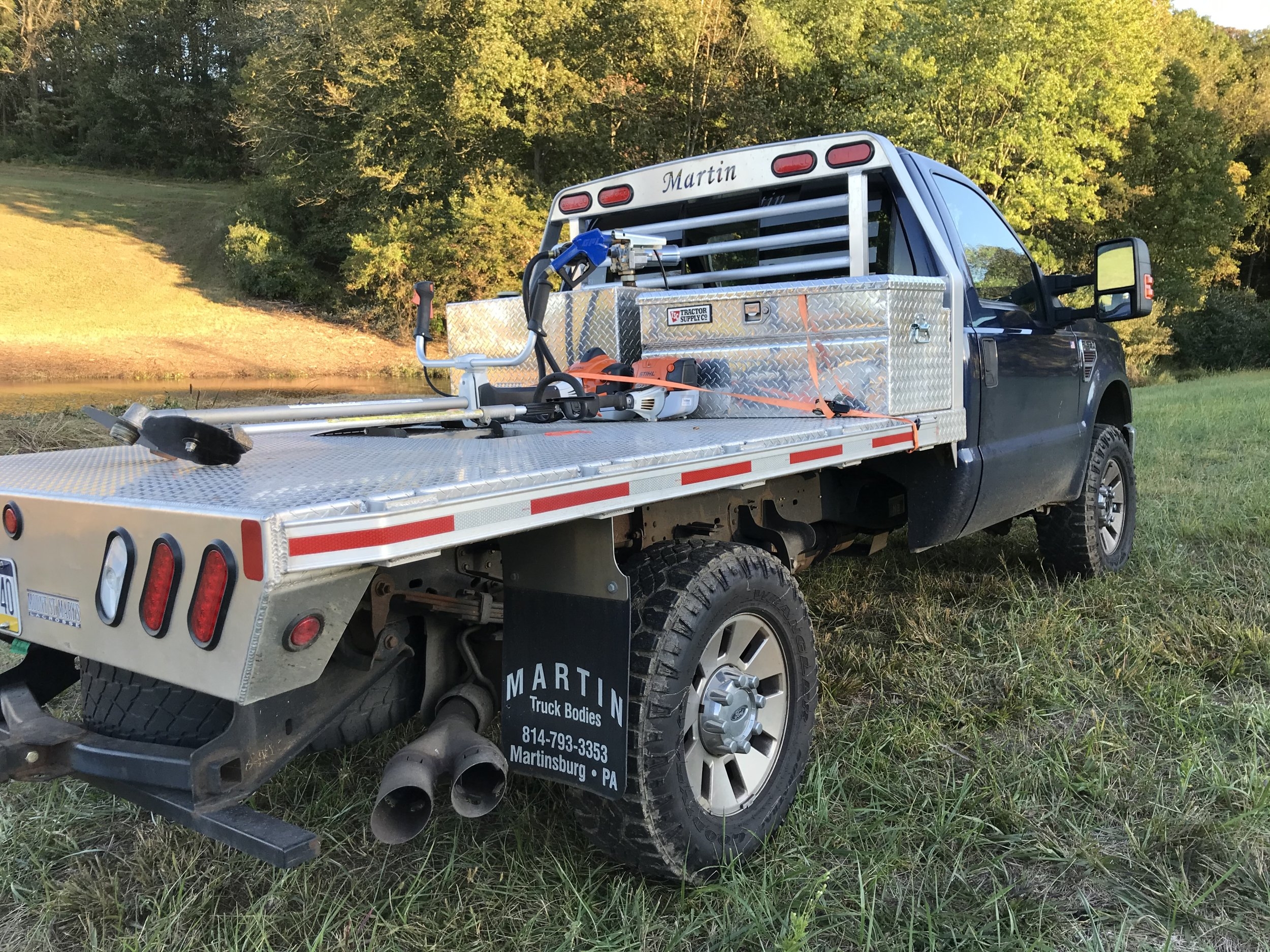

Yeah maybe. I owned 3 of them. Constant repairs. Over 120K miles and you couldn’t keep them running. Nice looking, fast, pretty tough but extremely unreliable. Here’s one of the 6.4’s I had. I liked it as a plow truck
