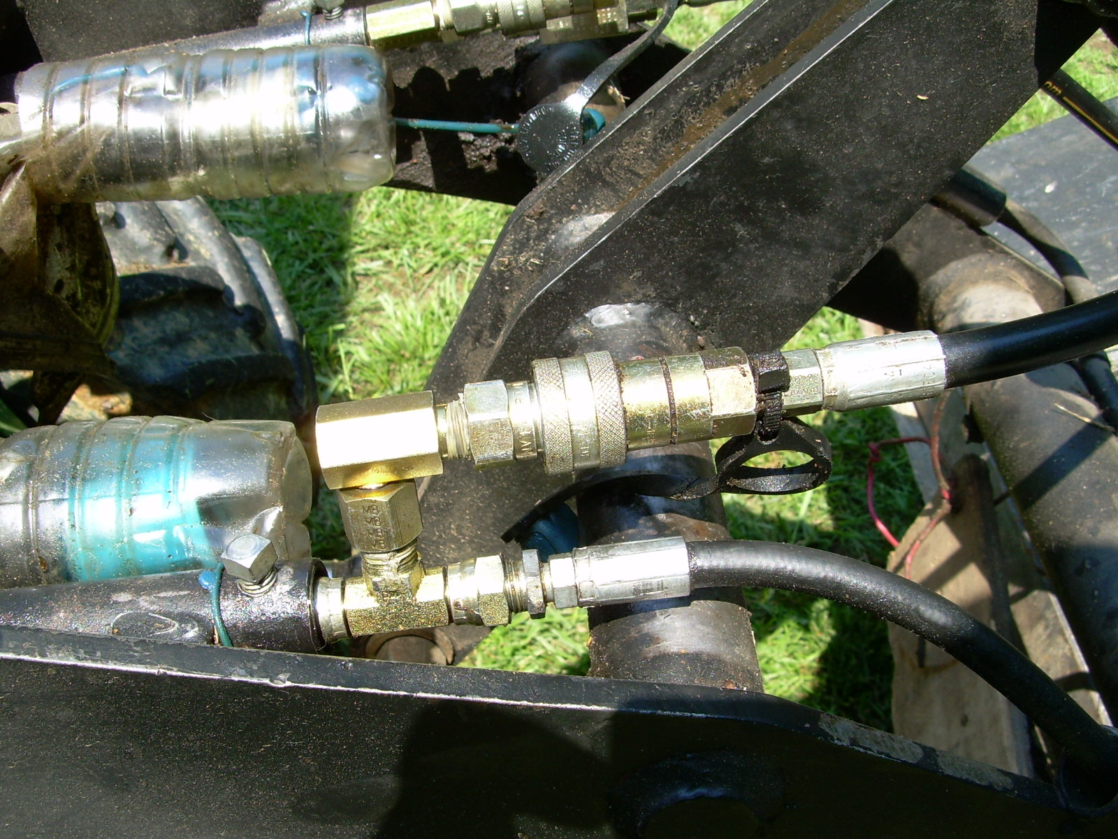

I went to use the mini hoe today and found that the right hose was too short with the hydraulics modification. I had put a 90 deg elbow on the left side, but had not seen the need for one on the right at least when using the buckets. However it does make a difference with the mini hoe. Fortunately I had a spare, put it on and it works fine. It makes sense, since the original fittings were in this orientation and close to the same location. I have attached a picture.

   / Maybe a Step 'Backwards', But Handy? #126
Hey, Bob... just a note that your pictures are HUGE!:D About half a meg each. It takes a good 4 minutes for anyone on dial-up to look at them.

   / Maybe a Step 'Backwards', But Handy? #129
I've been reading this thread and want to make sure I understand the connecting/disconnecting hose issue. When I want to disconnect my FEL on my Legacy CUT, all I do is turn off the engine and move the joystick around in all 4 directions a few times and this equalizes/ lets off the pressure to the quick disconnects so that re-attachment in the future is no problem. It's my assumption that this "wobbling" the joystick around neutralizes pressure throughout the hydro/hydraulic system in the tractor. Is that not how it works on the 425?
   / Maybe a Step 'Backwards', But Handy? #130
That is is way it works on a PT.
However there are circumstances where pressure can build up after the pressure is relieved. For example, if it is a cool day when you do the pressure equalization and disconnect a grapple bucket from the machine and then the temperature increases there may be enought pressure build up in the grapple bucket hydraulics to make reconnection difficult or impossible without relieving the pressure.
