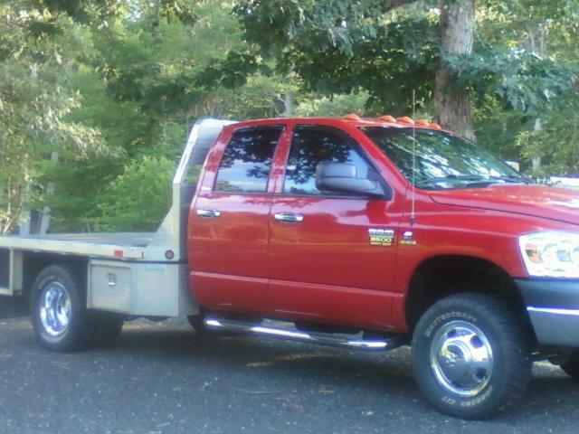

Your body looks great, but you are correct, the underside is rotting. I think your hunch is correct, and you'll be replacing a lot of items in the next 2-3 years. If it's your only truck, start looking for a good used one and sell that one before the rust moves towards the outside where its visible.

I thought you might have been overstating the damage but after seeing the photos, I'd part with it without a second thought. Those underhood, body mount, and suspension shots are terrifying, especially the underhood. So many small parts and lines ready to go at any moment, probably one at a time until the stress drives you bald. At that point you will sell but not before sinking thousands more into this thing and still have stuff breaking. This isn't a classic car you're trying to restore; it's simply not worth it. You'll never get out anywhere close to what you'll put into it.

Corrosion is killing that truck. I’d get rid of it while the getting is good.

Its crusty, that's for sure. But savable. If you use a good product like Krown or FF, you can save the body and chassis. But like you said, you need to replace every line in that truck. I think you are in for more than a few thousand to really go through it thoroughly. Trans, drive shafts, might as well do the frontend, u joints, and everything else. Basically build a new truck and keep the frame and engine. Don't plan on selling at that point, you'll never re-coup your investment.
My 2003 F450 was just a little better when I bought it. While it never plowed snow, it worked near the coast. I'm battling the same stuff, but the first thing I did was buy time by coating the truck very well with FF. But I don't depend on it and I love working on it.
I'm starting to lean to the side of selling and starting new. But personally, I 'd still go brand new.
