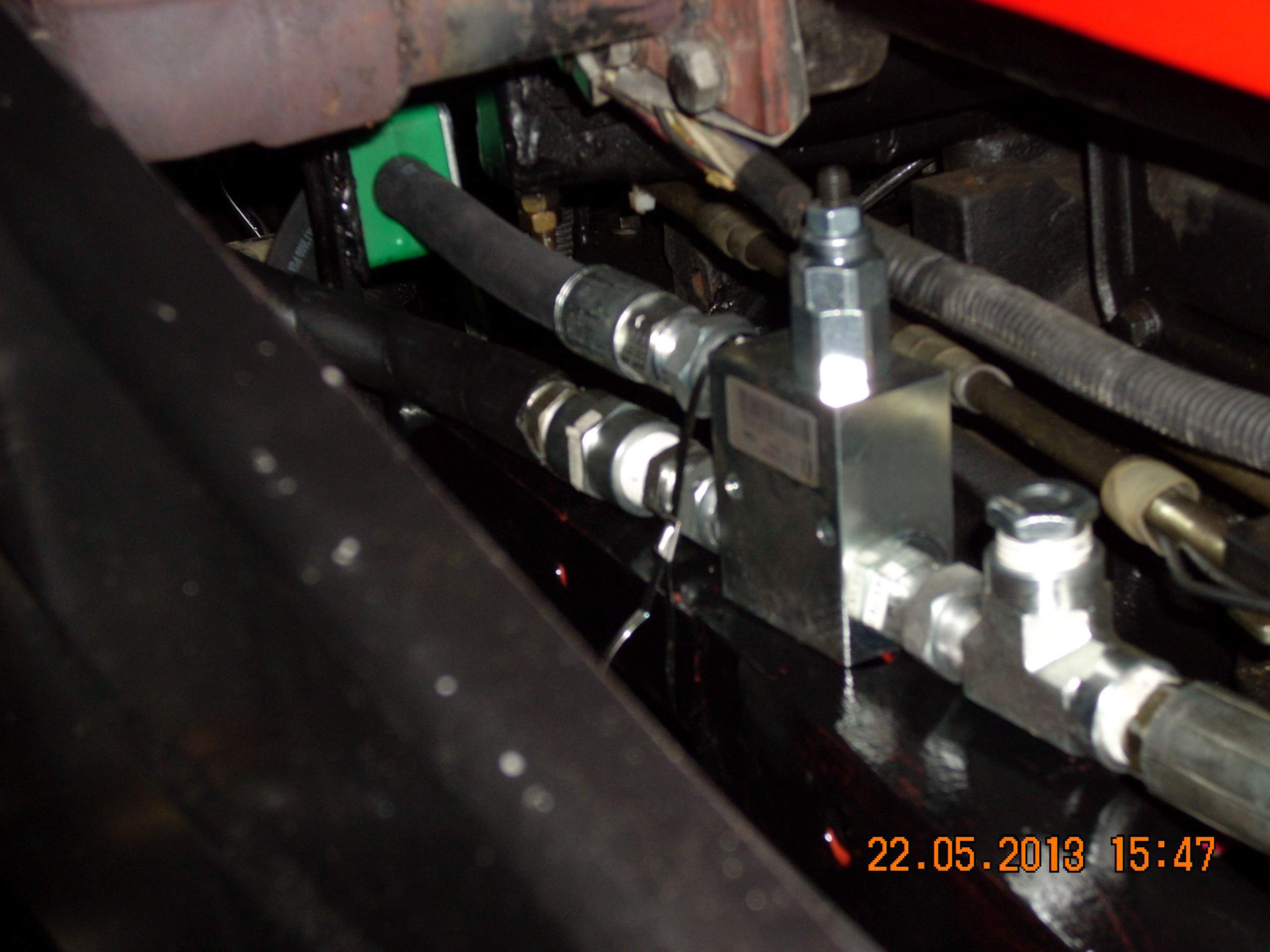

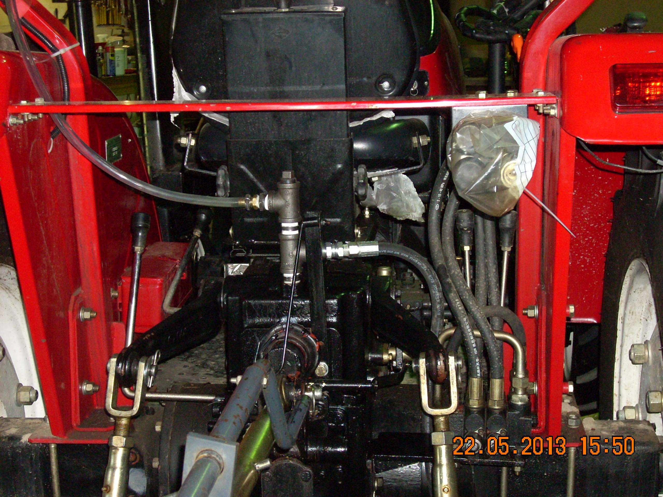

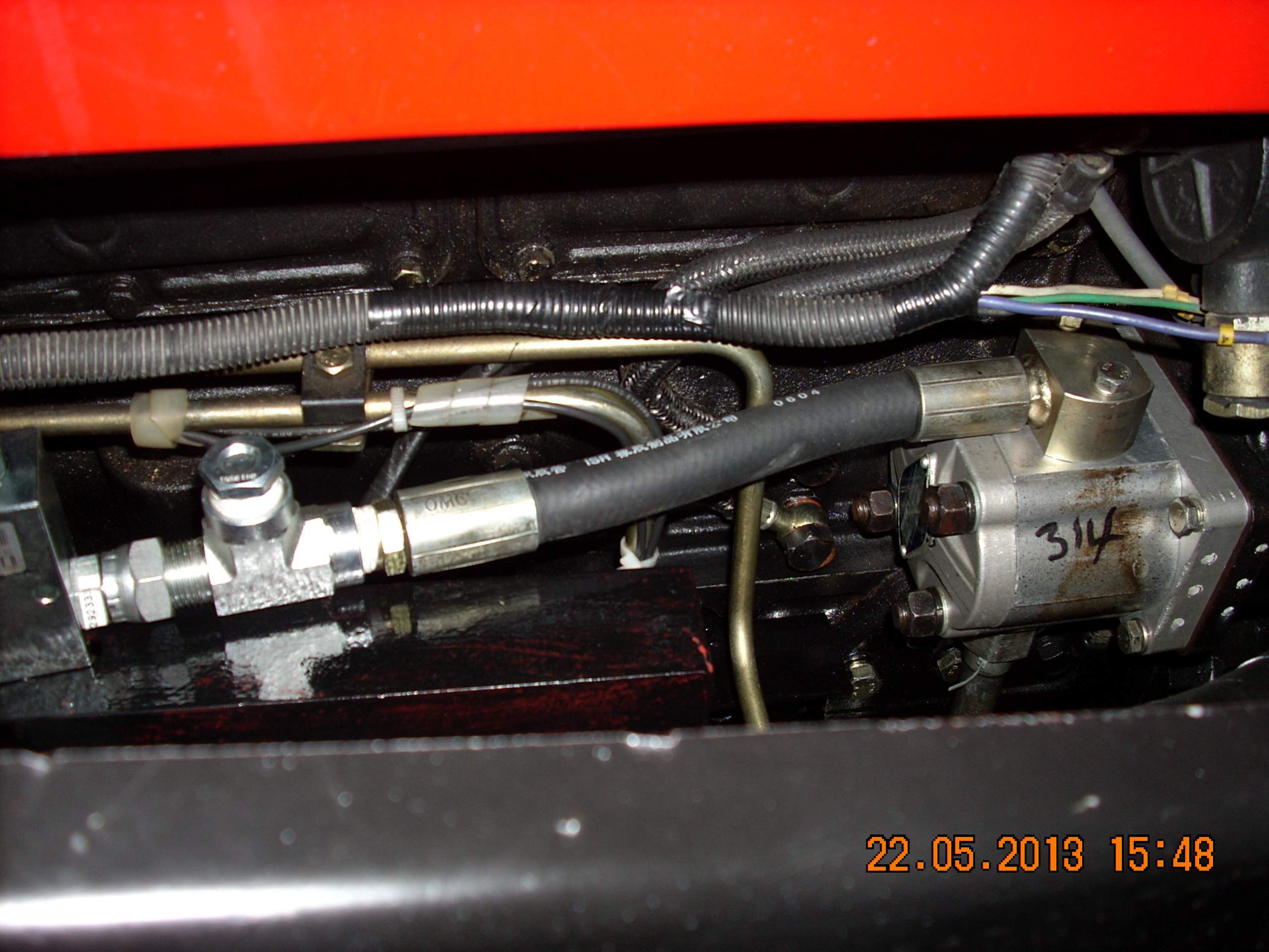

   / MCconnell Marc 425 XL #28
I would also install an aftermarket system relief valve on your tractor. I installed one on my machine because of two failures - both related to something in the TPH system. Have attached a c ouple of foto's of what did so that I am not relying on the tractor relief valves only. All that is needed is a bit of dirt or some metal shavings getting caught in the valve and the pressure in the hydraulic system is no longer controlled properly - don't ask how I know.
#29
thanks Jim, one of my next questions was going to be , why can't i put a tee in the fill plug and run system pressure relief there!. LOL awsume I already have everything but the tee to hook this up. is the tee before the prv for a gage?
   / MCconnell Marc 425 XL #30
The T before the PRV is only used to connect everything, but yes, the plug could be removed for a pressure gauge fitting if need be. My pressure gauge is connected to the valve control block on the loader support.
The PRV return to the hydraulic tank works well. Don't forget that with a hydraulic system - once the PRV starts to open the pressure drops drastically. Unless there is a large volume of oil opening the PRV, all that will pass is a small amount (whatever is required to relieve the prssure) and not full bore 1/2" pipe full. The other side of the tank T is the plastic hose vent that goes up the ROPS to the canopy and stops the mess from oil coming out of the dipstick tube vent holes.
