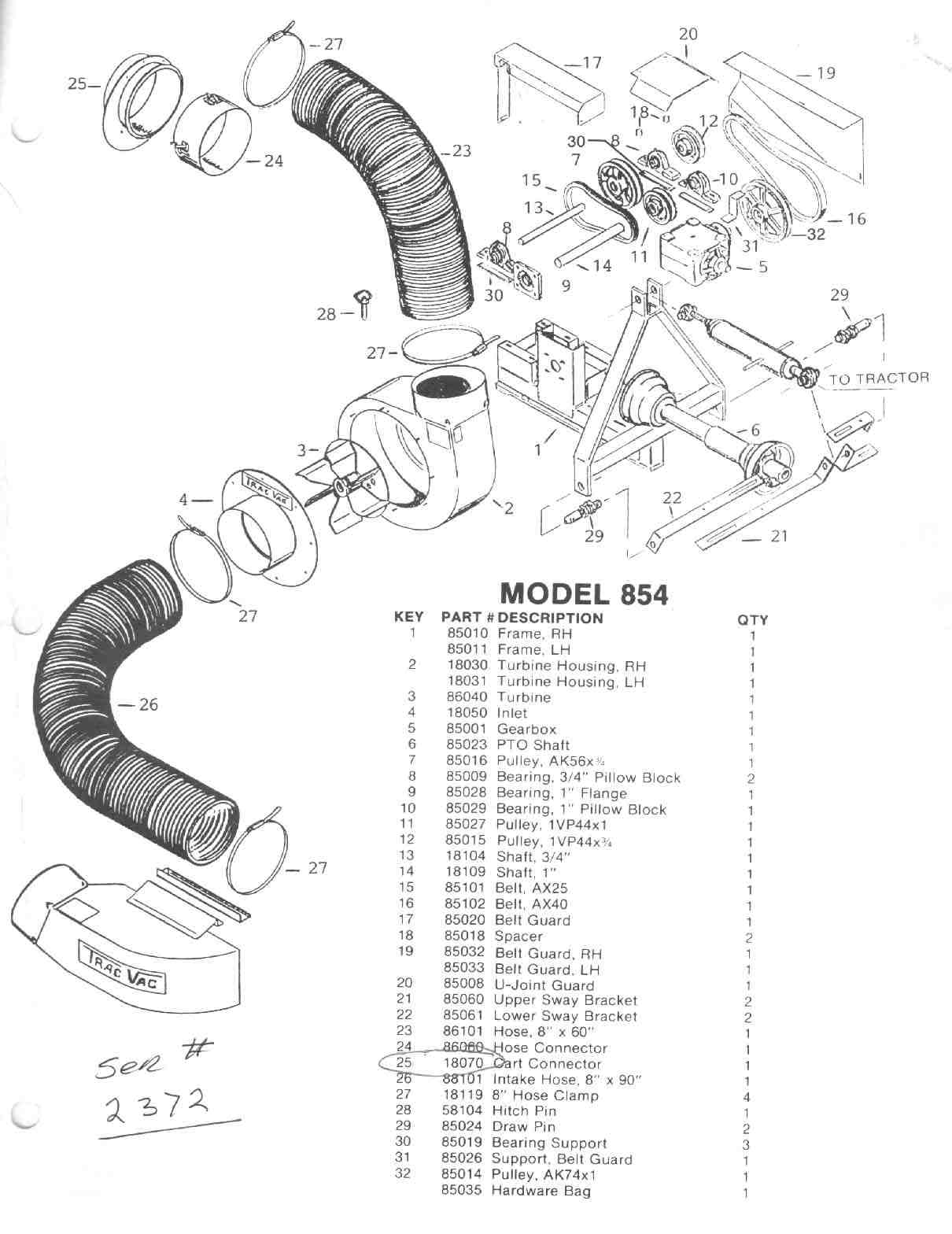

   / MCS for 4400 #9
I am attaching a picture of my 4300 with the Trac-Vacnad I will also send the 2nd with a parts list so you can see how it is made.
DPR

   / MCS for 4400 #10
Here is the parts List.
