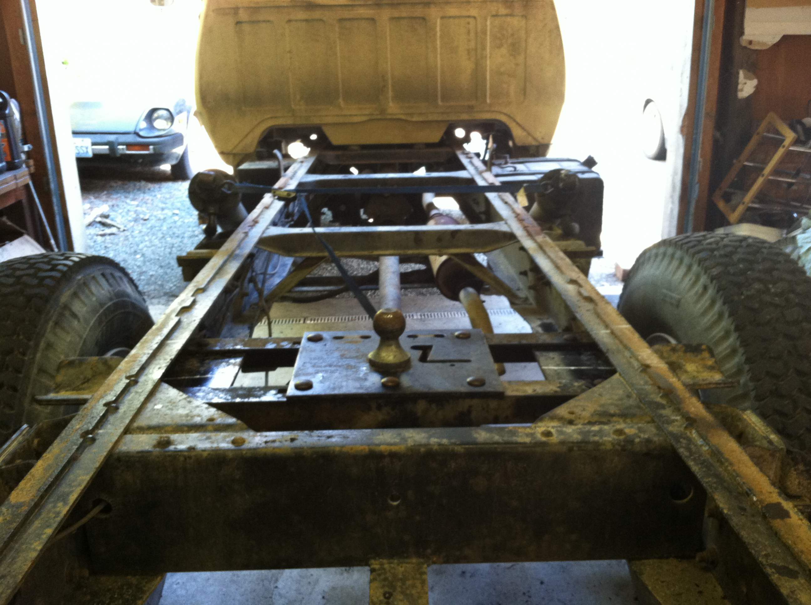

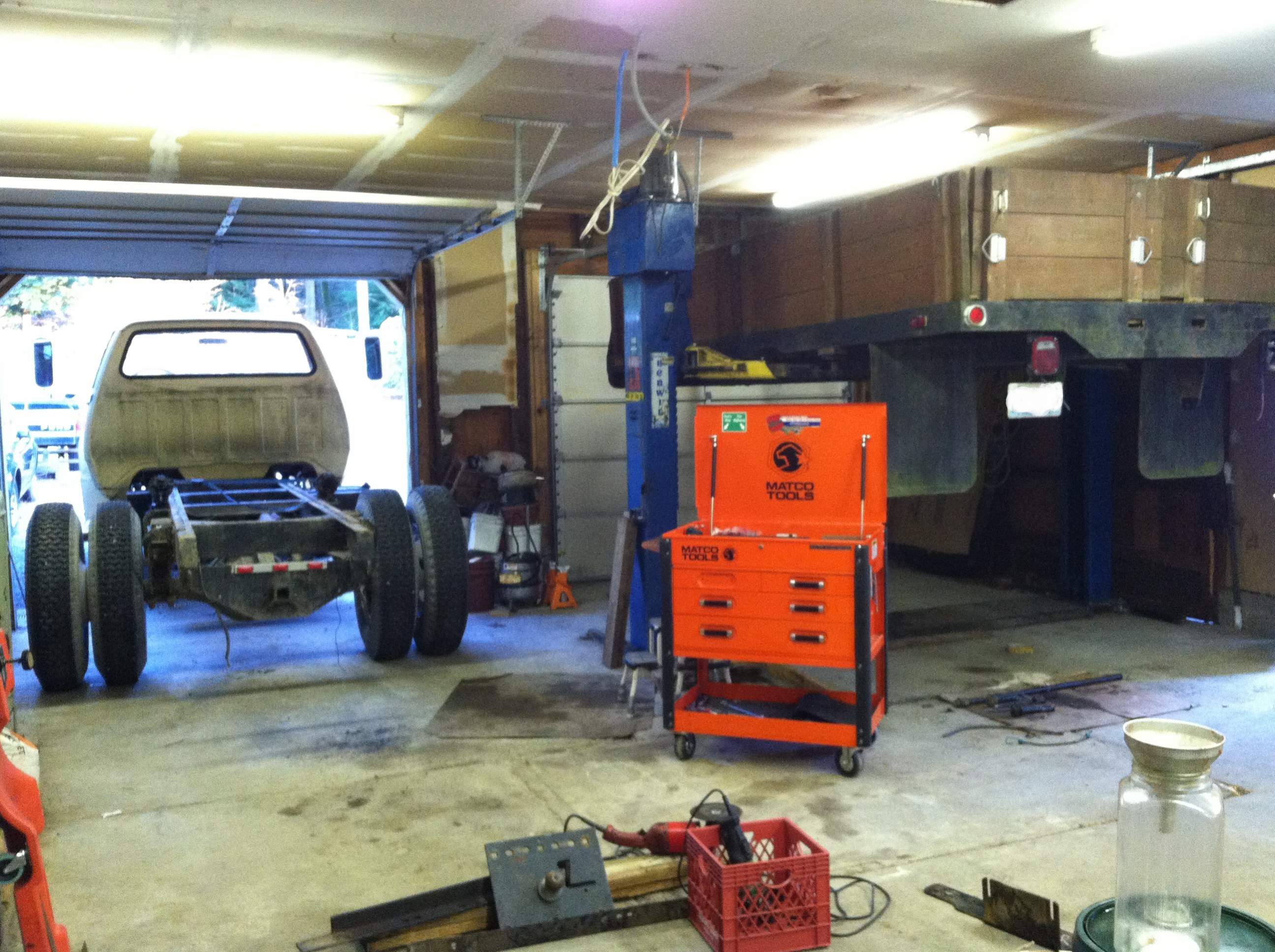

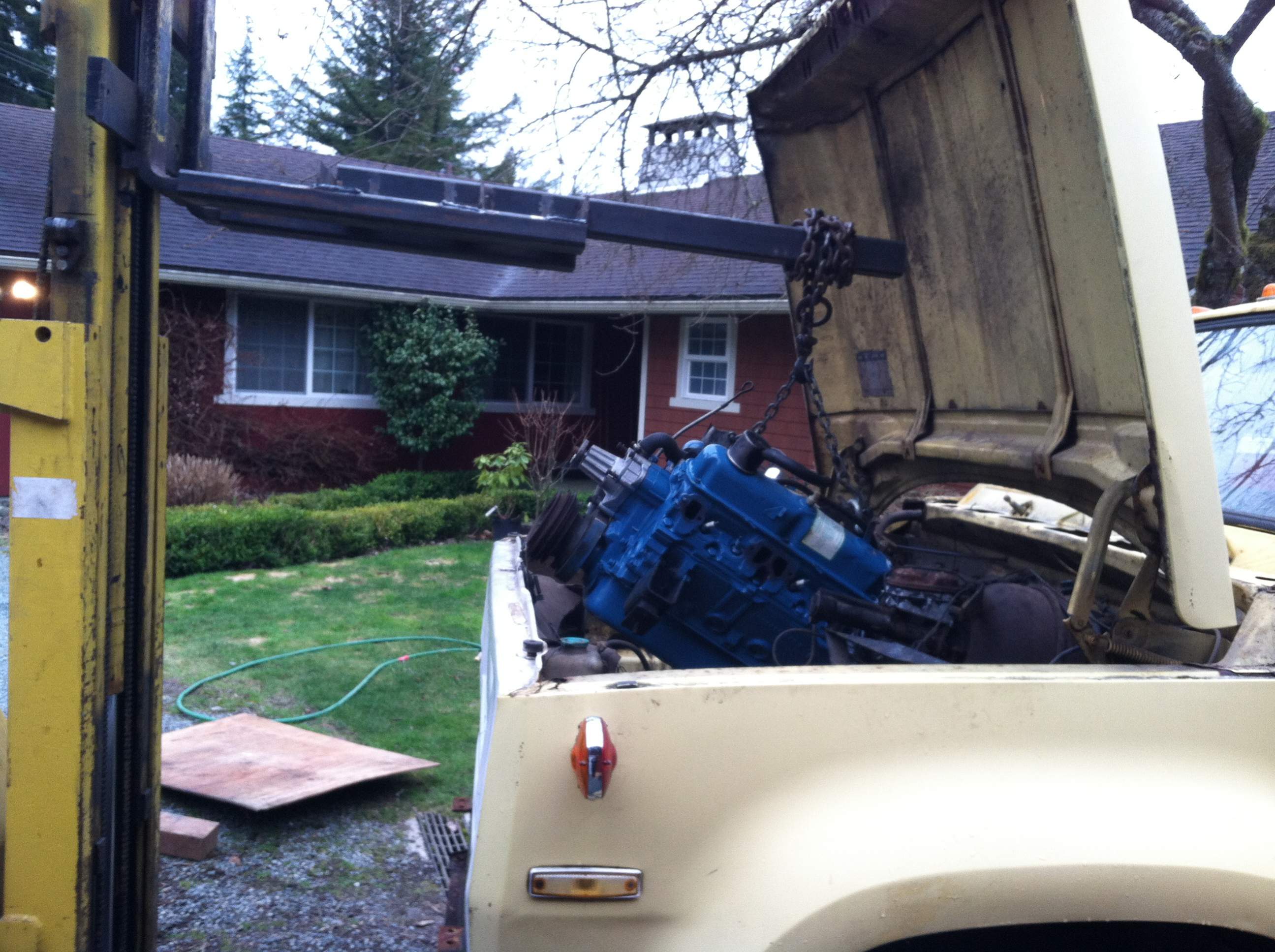

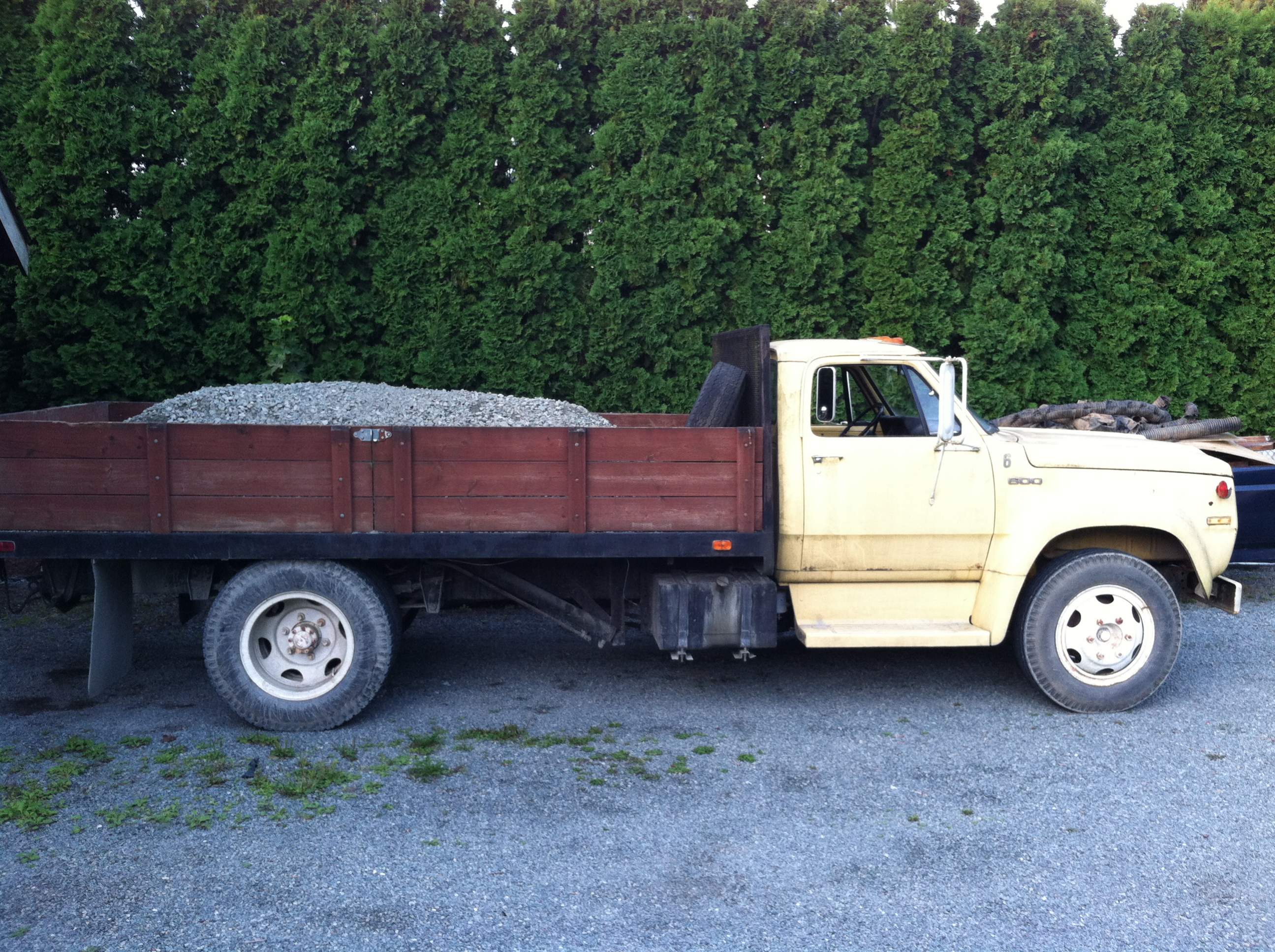

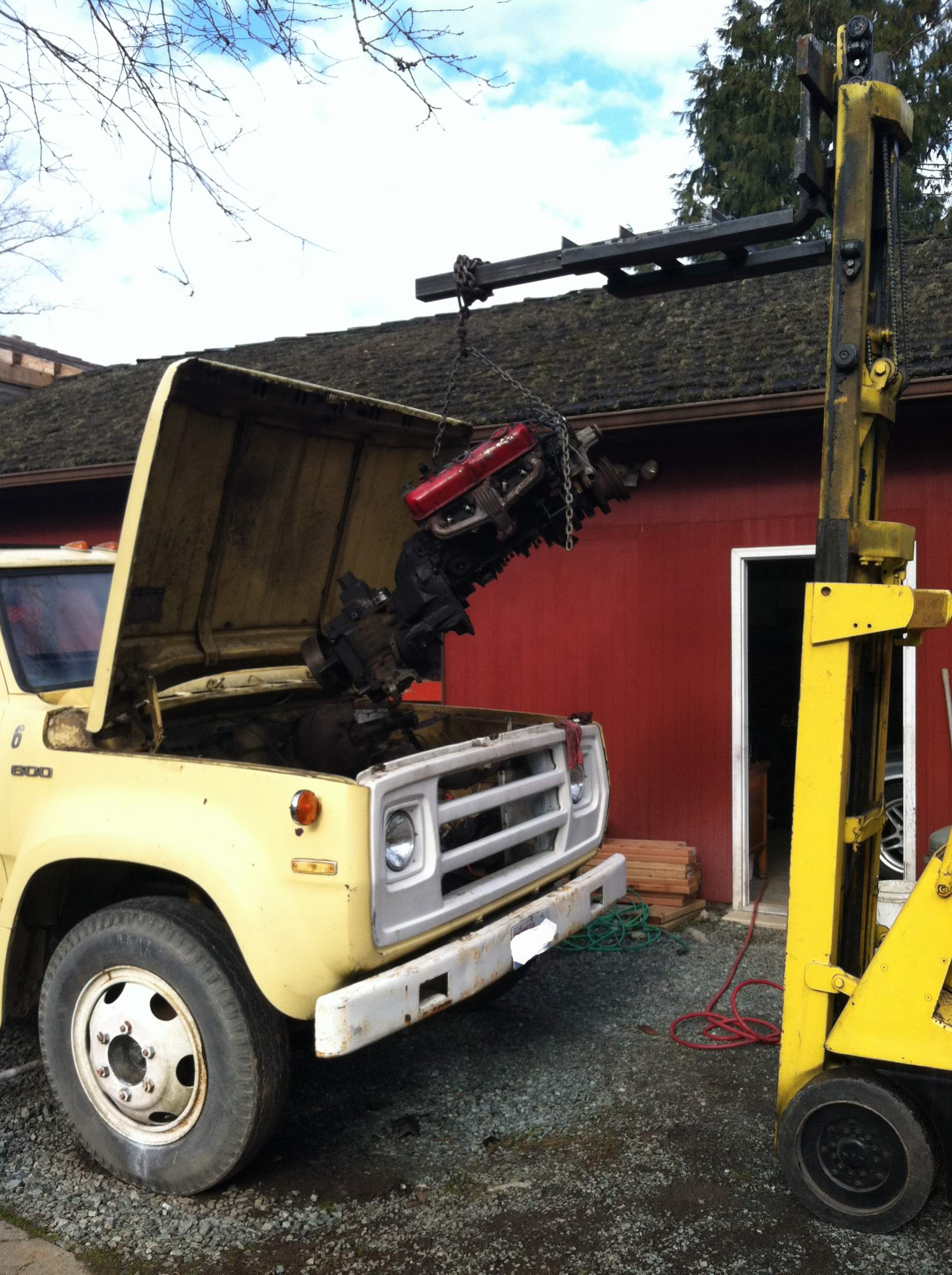

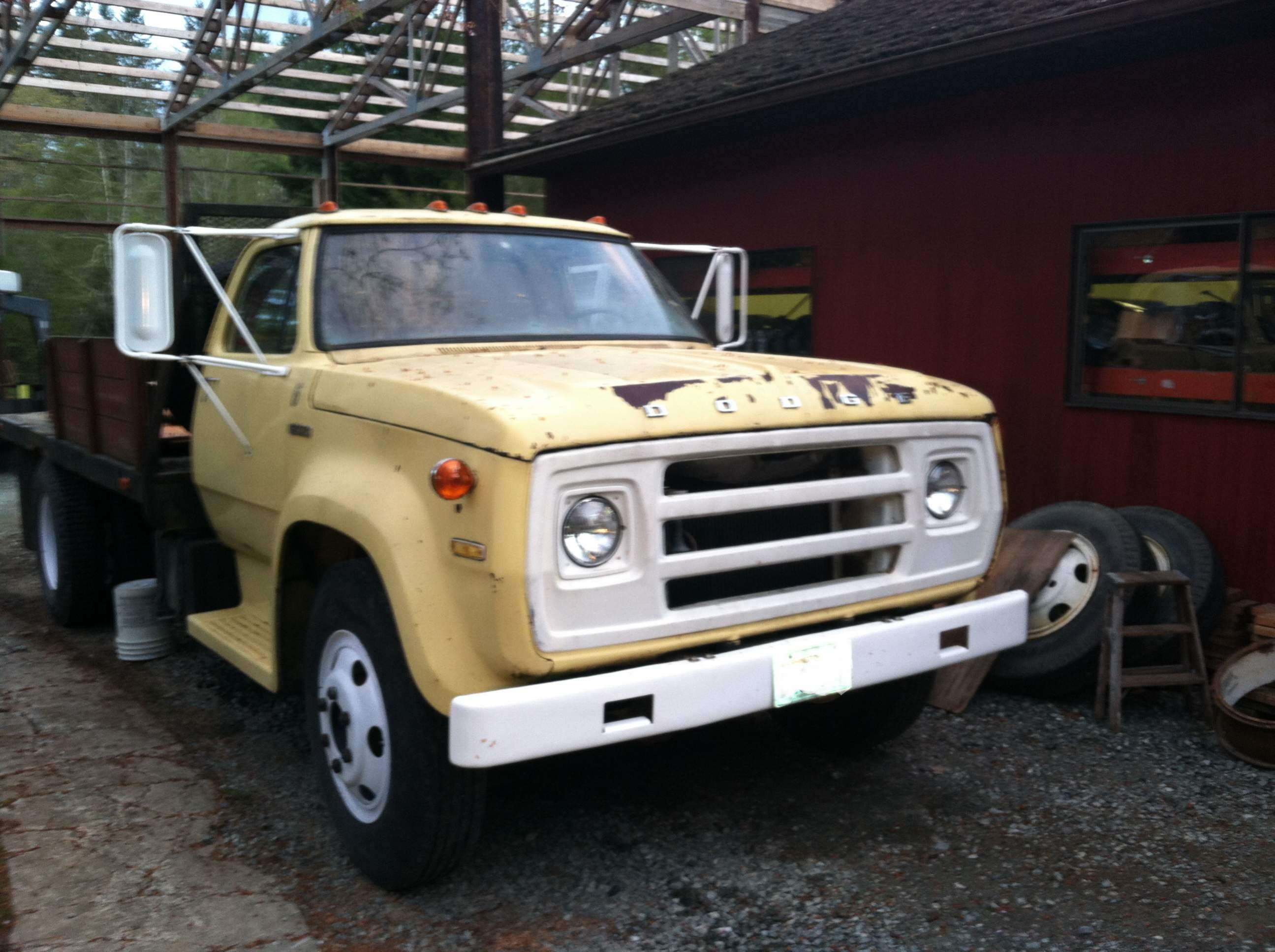

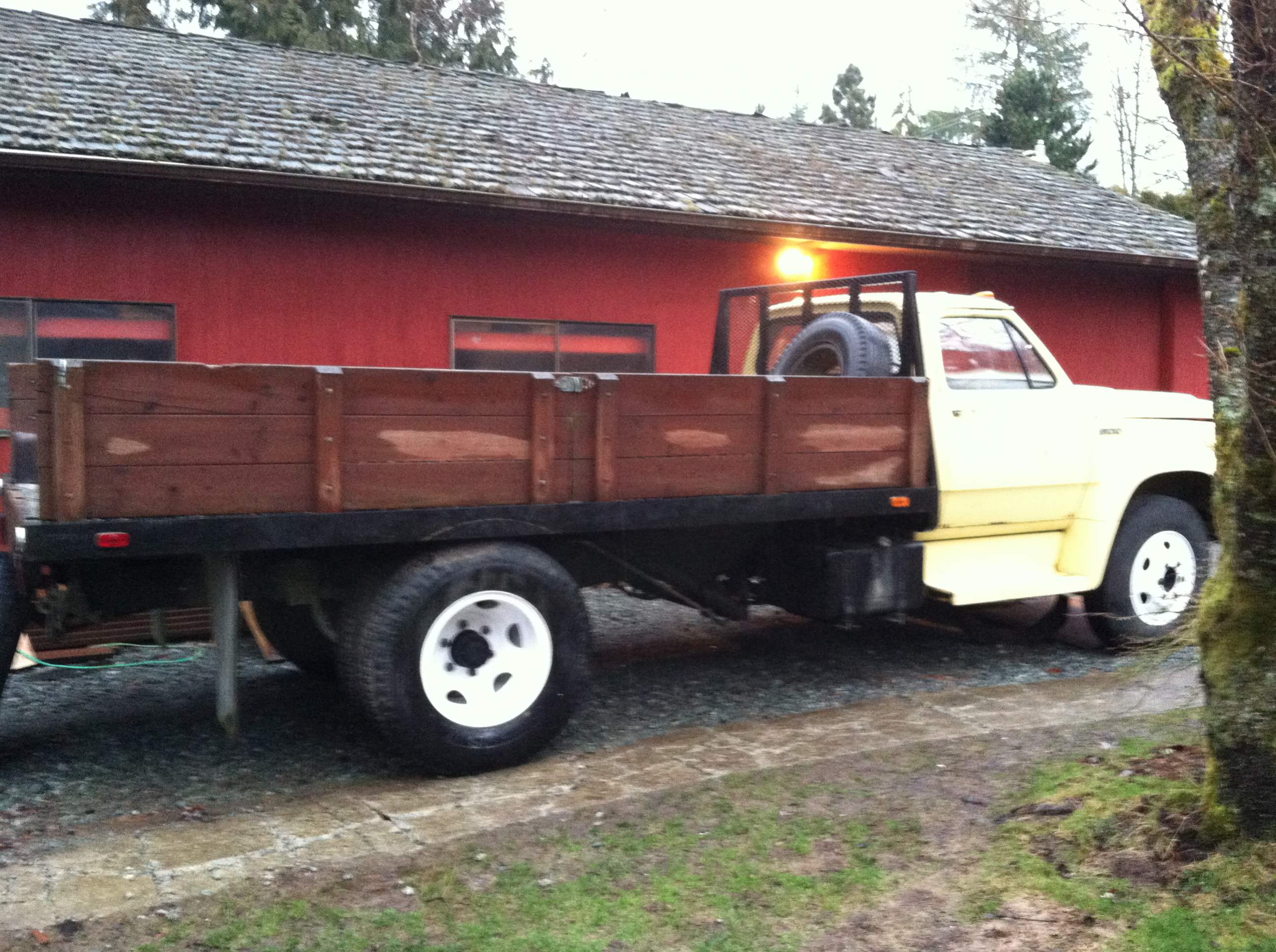

I hadn't thought of broken return springs. The debate here is which is less painful, an expensive master cylinder or removing those brake drums? The guy I bought the truck from put new brakes and kingpins on the truck, but that has been a number of years and little miles.
The only load related issue I have is rear wheel clearance. When I bumped up to 9.00-20 from 8.25-20 tires, I had to radius notch the outer rails of the bed. 5-6 tons of well-centered gravel is OK, but off-center or too much weight and I can get tires rubbing.
I will attempt to upload some pictures of Ermer. This is my first try on this site. One picture of the old 318 coming out, one of the "new" 360 going in; one loaded with gravel and before cosmetic work; one after sandblast and powdercoat of wheels, mirrors and front bumper, and two showing current status mounting the gooseneck hitch. Paint is peeling on the hood as you can cee in the picture of front of truck.

Thanks for the pictures.
Would it not be safer to add a block under the frame to give you some extra clearance ?
Other than that, you sure have a nice looking truck for it's age and that size would be very handy.

60 MPH flat out is max. Same thing with trans, even with fresh gear oil shifting takes some finesse. The two-speed rear end makes it nice for heavy loads on rural roads. Too bad the Dodge parts are so pricey. I'm a Ford guy by nature (hence my member name), but the ol' Dodge somehow spoke to me, and the price was pretty good. I'm not much of a Dodge guy, but there is something about that truck. You sure don't see many of them.
The reason I suspect the master cylinder is the intermittent nature of the soft pedal. Great brakes 80%+ of the time, occasionally extra pedal travel requiring a pump or two to firm up again. I have to say that the factory brakes on the old truck are pretty darn sure, even pushing 20k lbs loaded. I just don't want to push my luck with whatever is going on.
I'm setting it up with the gooseneck hitch so I can pull my trailer with mini or tractor. The hitch came off of a '90s Ford pickup but was an easy adapt to the narrow Dodge frame. Gotta finish up fastening the hitch to the frame and then work on a doorway for the hitch to extend through the bed floor to the hitch. He won't go fast, but he will start, turn and stop far better than a light-duty truck. I picked up an old-school Kelsey-Hayes brake controller, new-in-box, dated 1977; the type that tees into the brake line. I'm going to use that one vs. the newer electronic/inertia type, since the old style is compatible with the Dodge. I'm hoping for smoother, more positive trailer braking.
There are only a couple of choices I can see to increase tire clearance; raise the bed (PITA due to hinge point and hydraulic cylinders), add spacer between axle and spring, or increase clearance in outer bed rail. Since there isn't much load on the outer rail, and it was pretty easy to reinforce, I went that route.
