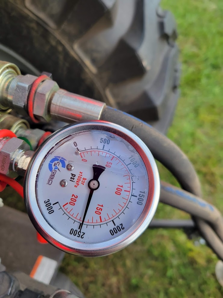

gauges arrived today, as expected, same pressure from rear remotes and 3rd function. (y)
Little bit of parallax from the 3rd function image, but they are same viewed head on. Set perfect from the factory.
And I see a crack in the newest hose on the tractor, a Tractor Supply hose for the top-link. It's only 24 months old and the tractor sits in a covered carport!
Parts used were $38 all from amazon

Using a gauge to measure the your dead head or maximum pressure is useful information. What your pump can provide and what your relief valve will allow. Tractors can have multiple pumps, relieve valves and circuits.
Installed a Kubota soft ride system on the M59 FEL that uses hydraulic accumulators to dampen shock loads. Simple ball valve allows it able to turn the system on or off. Added a pressure gauge to be able to monitor working pressure. Can always check dead head pressure to the loader circuit. My relief pressure is a little lower than spec but the loader is incredibly strong anyway. Seeing how much pressure it takes to lift a load is interesting. Watching and feeling how the soft ride system dampens moving heavy loads is remarkable. What got me by surprise was the dynamic loading of the hydraulic system. Circuits downstream from the control valves and not relief protected.
Example, grubbing up a stump. I can use the bucket or grapple to try to lift the stump up to dead head pressure of 2800psi. This gives about 3800# lifting force. If I curl (separate hydraulic circuit) and push with tires I can see the lifting pressure almost double. That is almost doubling the lifting force. All what designers and engineers have to take in account. What operators can understand to better utilize and care for their equipment.
