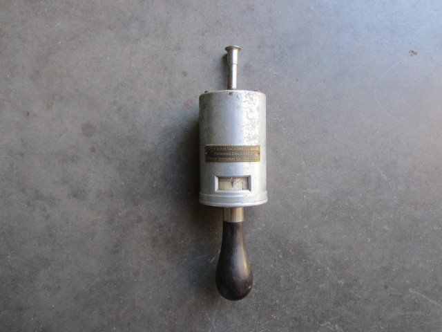

This is an old one made by Warner Instrument Co in Beloit WI

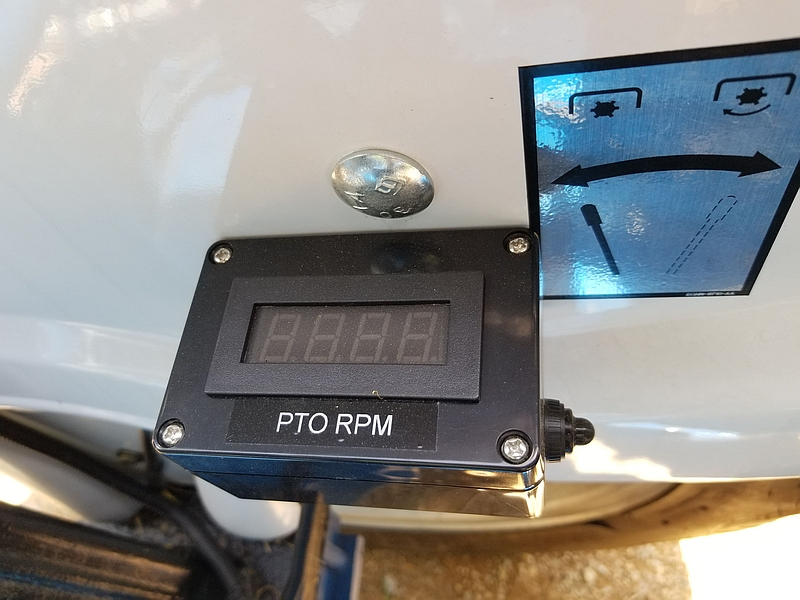

I went ahead and added a 12v digital tach even though the new dash has a tach. I wanted to verify the accuracy since my tach is driven by a cable. Come to find out. it's spot on. The push-on/push-off switch and the box are waterproof as is the sender. The sleeve on the output shaft has a magnet and set screw.
